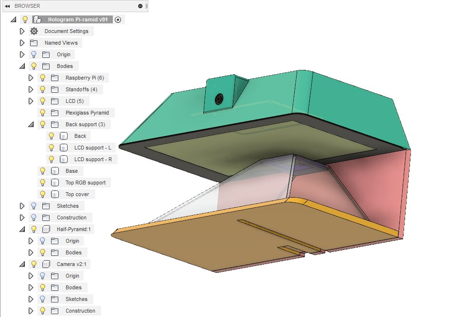

3D Designs
All technical drawings I've used are available here. All the STL files required have been attached to this blog entry.
3-D Print settings
Settings used for all 3D printed parts:
  • Printer: Creality CR-10S
  • Material: PLA Blue-denim
  • Infill: 15%, triangles
  • Adhesion: Brim
  • Supports: No
  • Layer height: 0.2mm
  • Nozzle size: 0.4mm
The entire 3D model can be viewed at Myhub on Autodesk.

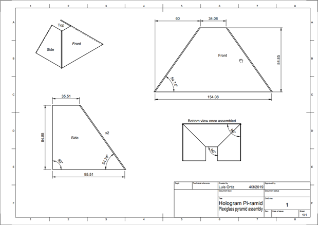

Acrylic Pyramid
Three pieces of Acrylic must be cut to build the Plexyglass pyramid -perhaps the most important non-electronics piece of the project. Then such pieces are welded together with Methylene chloride (dichloromethane or DCM)

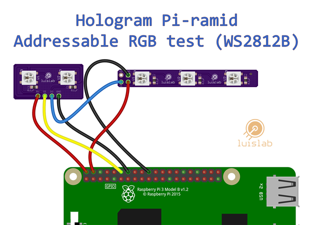

Electronics Assembly
The custom made electronics assembly is fairly simple, diagram below is perhaps the most important resource in this area:
All the custom made electronics designs are attached to this blog entry as well.
