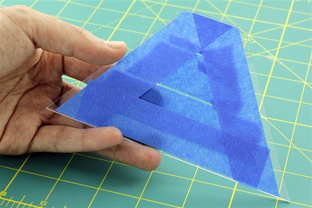

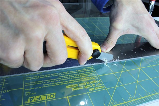

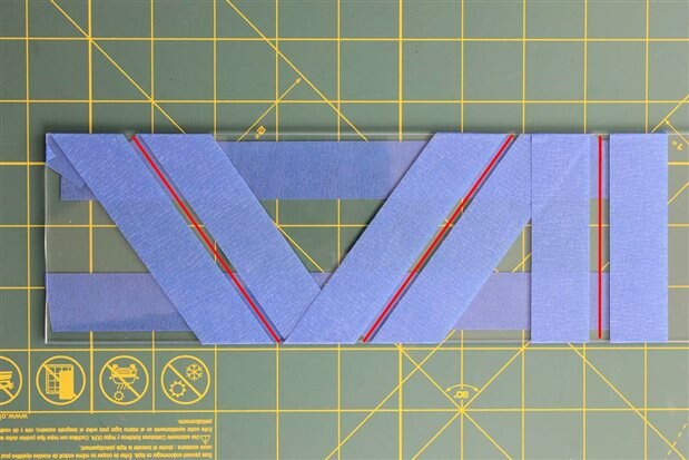

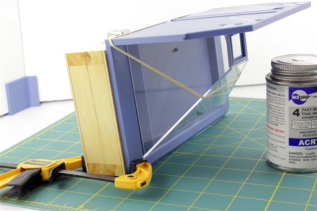

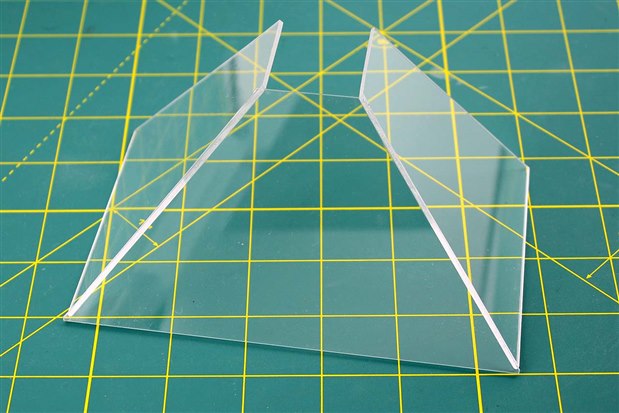

In the previous blog post, I've covered the 3d printed parts and some assembly. Such parts will help in the construction of the Plexiglass pyramid too as they will provide support when gluing the pyramid which is made of 3 pieces of 2mm thick (0.08 inches) clear Acrylic -also known as Plexiglass among many other names. To cut the Plexiglass I used a Plastic/Laminate Scorer and only needed three or four passes for each cut with clean results. To avoid scratching the Acrylic I added some blue masking tape as can be appreciated in some of the pictures.
{gallery:width=960,height=768,autoplay=false} Cutting Plexiglass Pyramid
Scoring Plexiglass: Scoring Plexiglass/Acrylic with a Plastic/Laminate Scorer
Plexiglass pyramid cutting: Plexiglass pyramid - before cutting preparation
Plexiglass pyramid front piece: Front piece (Plexiglass/Acrylic pyramid)

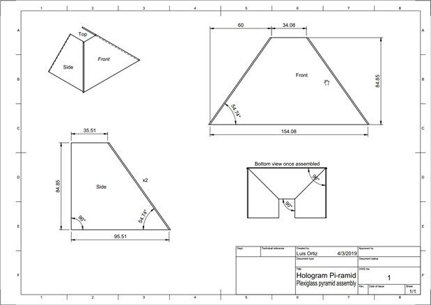

Plexiglass pyramid assembly: Technical drawings Acrylic/Plexiglass pyramid

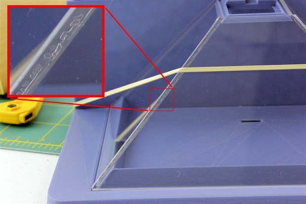

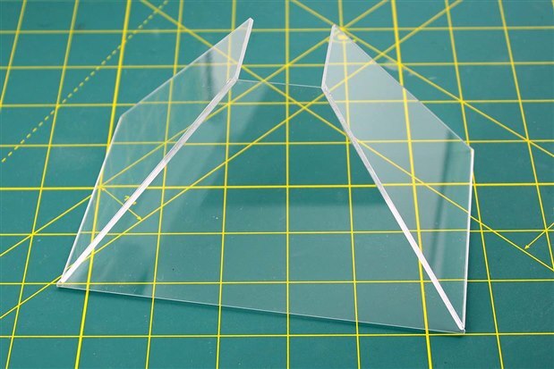

To bond all the Plexiglass pieces together I used Methylene chloride, also known as dichloromethane or DCM; a fast drying solvent that welds some plastics by softening the polymer and fusing it together, which I applied with a small blunt tip syringe allowing it to flow along the surfaces to be joined via capillary action. To add support I used some of the 3d printed parts assembled together, a rubber band and a little help of gravity.
{gallery:width=960,height=768,autoplay=false} Gluing the Plexiglass Pyramid
Welding Plexiglass: Welding the Plexiglass/Acrylic with Methylene chloride
Zoomed-in weld: Zoomed-in Plexiglass/Acrylic weld
As can be appreciated results are very good, the Plexiglass pyramid seems sturdy enough and can be removed/placed in the project easily -as seen on the video- which is one of the features I had planned which I will be covering in more detail in a later entry.

    Very accurate and nice building. Two important things I have appreciated and never known. The first is the way you joined the transparent parts, I have always used Cyanoacrilate but with your solution…
  • luislabmo
    luislabmo over 7 years ago in reply to dubbie +6
    Hi Dubbie, I think it all boils down to patience and trying and trying. It took me about a month to calibrate my new printer to get smooth prints and the features I add to the 3d printed parts like the…
  • luislabmo
    luislabmo over 7 years ago in reply to balearicdynamics +6
    Hello Enrico, This is the first time I've heard of the Cyanocrilate. If you ever try the D ichloromethane method, the edges that will be welded should be "rough", ironically laser-cut parts are hard to…
