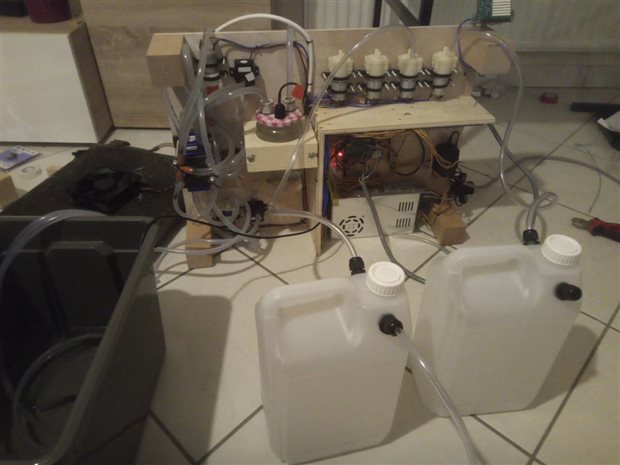

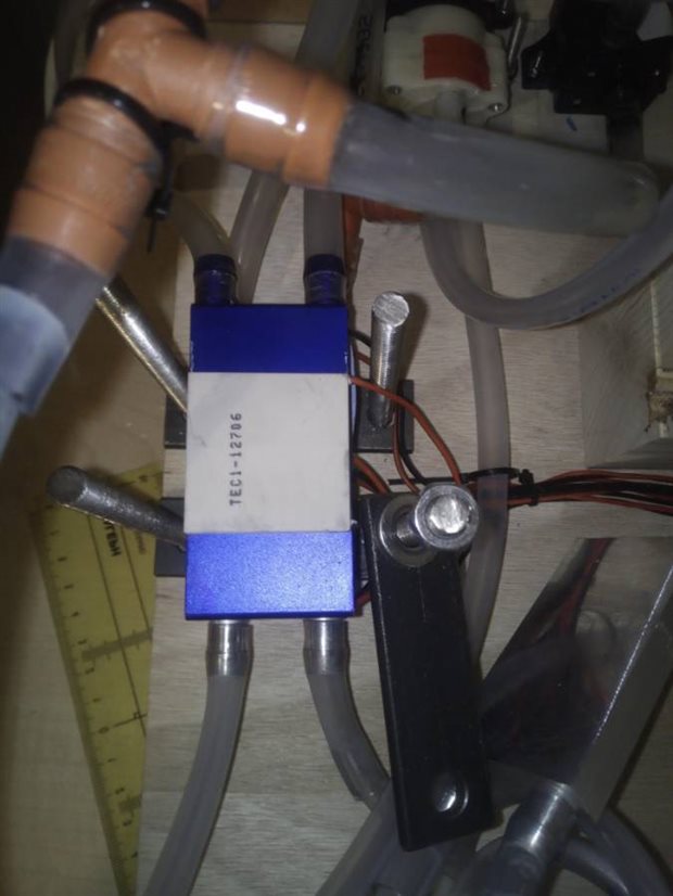

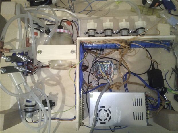

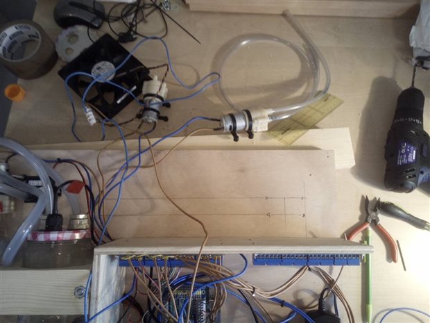

Finishing building of the electrical part
{gallery} My Gallery Title

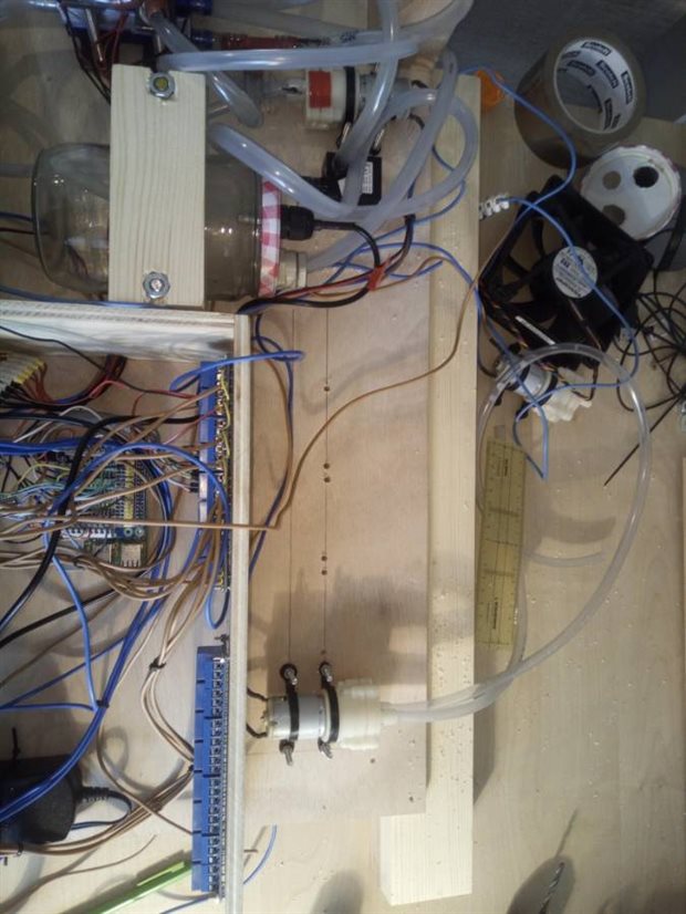

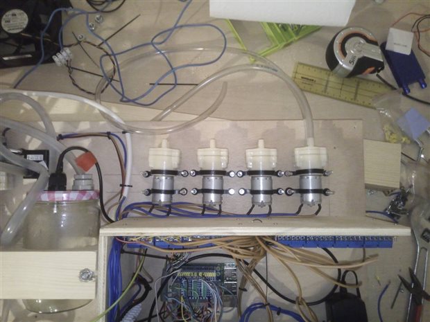

Distribution system

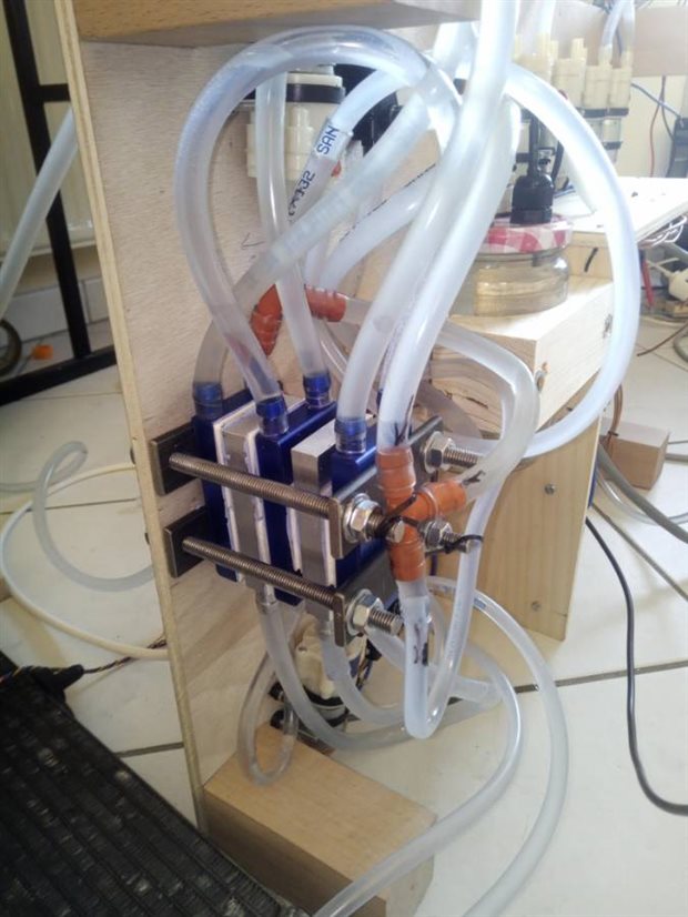

Tec installation
6 TEC installed (432W)

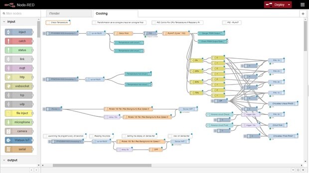

The cooling program on node-red

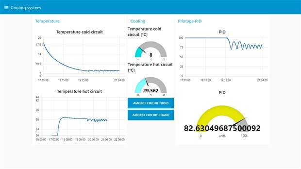

Some screenshots of the 8°C tests and settings
I am back full throttle for the final straight of this great adventure. It will be very intense. I received waterblock and a circulator in addition that I installed. I finished assembling all the wood part to be able to fix all the electrical elements correctly. Following this I performed a test with a setpoint at 8°C. I notice that it works pretty well. I am waiting to receive a controller to be able to drive the TECs with a PWM output of the Raspberry. I will also drive the fan in PWM to make it run slower so is less noise. It will probably enslave on the temperature of the hot circuit using a PID.
For those who want to see how my program works on node-red here is the version that is currently in place :

        "repeat": "",
        "crontab": "",
        "once": false,
        "onceDelay": "",
        "x": 2250,
        "y": 520,
        "wires": [
                "dd8473da.694ae"
        "id": "d9c86e91.adf5f",
        "type": "inject",
        "z": "756ed309.7d647c",
        "name": "",
        "topic": "",
        "payload": "0",
        "payloadType": "num",
        "repeat": "",
        "crontab": "",
        "once": false,
        "onceDelay": "",
        "x": 2250,
        "y": 600,
        "wires": [
                "72bf64b.51a629c"
        "id": "95754ecb.f9c71",
        "type": "rpi-gpio out",
        "name": "",
        "pin": "19",
        "set": "",
        "level": "0",
        "freq": "",
        "out": "out",
        "x": 2440,
        "y": 320,
        "wires": []
        "id": "f31f7d33.6d6d1",
        "name": "",
        "pin": "23",
        "set": "",
        "level": "0",
        "freq": "",
        "out": "out",
        "x": 2440,
        "y": 400,
        "wires": []
        "id": "dd8473da.694ae",
        "name": "",
        "pin": "26",
        "set": "",
        "level": "0",
        "freq": "",
        "out": "out",
        "x": 2440,
        "y": 480,
        "wires": []
        "id": "72bf64b.51a629c",
        "name": "",
        "pin": "10",
        "set": false,
        "level": "1",
        "freq": "",
        "out": "out",
        "x": 2440,
        "y": 560,
        "wires": []
        "id": "8a28820a.4861",
        "type": "inject",
        "name": "Off",
        "topic": "",
        "payload": "1",
        "repeat": "",
        "crontab": "",
        "once": false,
        "onceDelay": 0.1,
        "x": 1830,
        "y": 620,
        "wires": [
                "95754ecb.f9c71",
                "dd8473da.694ae",
                "f31f7d33.6d6d1",
                "72bf64b.51a629c",
                "ad456b61.ec5778",
                "835cf523.43f228",
                "14d13dc3.b644c2",
                "3f96e7f6.2be8a8"
        "id": "ad456b61.ec5778",
        "name": "Circulateur chaud PIN35",
        "pin": "35",
        "set": false,
        "level": "1",
        "freq": "",
        "out": "out",
        "x": 2490,
        "y": 640,
        "wires": []
        "id": "835cf523.43f228",
        "name": "",
        "pin": "38",
        "set": false,
        "level": "1",
        "freq": "",
        "out": "out",
        "x": 2440,
        "y": 720,
        "wires": []
        "id": "7e08f4ff.0d439c",
        "type": "trigger",
        "op1": "0",
        "op2": "1",
        "op1type": "str",
        "op2type": "str",
        "duration": "25",
        "extend": false,
        "units": "s",
        "reset": "1",
        "bytopic": "all",
        "name": "",
        "x": 2250,
        "y": 720,
        "wires": [
                "835cf523.43f228"
        "id": "14d13dc3.b644c2",
        "name": "Circulateur Froid PIN21",
        "pin": "21",
        "set": false,
        "level": "1",
        "freq": "",
        "out": "out",
        "x": 2490,
        "y": 880,
        "wires": []
        "id": "3f96e7f6.2be8a8",
        "name": "Circuit froid",
        "pin": "8",
        "set": false,
        "level": "1",
        "freq": "",
        "out": "out",
        "x": 2450,
        "y": 800,
        "wires": []
        "id": "acbac500.2d7ec8",
        "type": "trigger",
        "op1": "0",
        "op2": "1",
        "op1type": "str",
        "op2type": "str",
        "duration": "15",
        "extend": false,
        "units": "s",
        "reset": "1",
        "bytopic": "all",
        "name": "",
        "x": 2250,
        "y": 800,
        "wires": [
                "3f96e7f6.2be8a8"
        "id": "1461f94b.d876f7",
        "type": "ui_button",
        "name": "",
        "group": "a2c986a9.a857d8",
        "order": 3,
        "width": 0,
        "height": 0,
        "passthru": false,
        "label": "Amorce circuit Froid",
        "color": "",
        "bgcolor": "",
        "icon": "",
        "payload": "0",
        "payloadType": "str",
        "topic": "",
        "x": 2020,
        "y": 800,
        "wires": [
                "acbac500.2d7ec8"
        "id": "32138aac.785f26",
        "name": "",
        "order": 4,
        "width": 0,
        "height": 0,
        "passthru": false,
        "label": "Amorce circuit Chaud",
        "color": "",
        "bgcolor": "",
        "icon": "",
        "payload": "0",
        "topic": "",
        "x": 2020,
        "y": 720,
        "wires": [
                "7e08f4ff.0d439c"
        "id": "8b83ff25.96996",
        "type": "rpi-sensehat out",
        "name": "",
        "x": 1130,
        "y": 920,
        "wires": []
        "id": "f05fddd1.88f6f",
        "type": "function",
        "name": "Rotate 180 Text Red Background No Speed 1",
        "func": "msg.color = \"red\";\nmsg.background =\"0\" ;\nmsg.speed = \"1\";\nmsg.payload = \"R180\\n\"+msg.payload;\nreturn msg;",
        "outputs": 1,
        "noerr": 0,
        "x": 840,
        "y": 920,
        "wires": [
                "8b83ff25.96996"
        "id": "13713ce2.a9cfc3",
        "type": "delay",
        "name": "",
        "pauseType": "delay",
        "timeout": "8",
        "timeoutUnits": "seconds",
        "rate": "1",
        "nbRateUnits": "1",
        "rateUnits": "second",
        "randomFirst": "1",
        "randomLast": "5",
        "randomUnits": "seconds",
        "drop": false,
        "x": 720,
        "y": 980,
        "wires": [
                "7ad546f5.031758"
        "id": "7ad546f5.031758",
        "type": "function",
        "name": "OFF",
        "func": "msg.background = \"off\";\nmsg.colour = \"off\";\nreturn msg;",
        "outputs": 1,
        "noerr": 0,
        "x": 950,
        "y": 980,
        "wires": [
                "8b83ff25.96996"
        "id": "7606b20e.1900cc",
        "type": "rpi-ds18b20",
        "topic": "FF4D0B851605",
        "array": false,
        "name": "",
        "x": 550,
        "y": 920,
        "wires": [
                "f05fddd1.88f6f",
                "13713ce2.a9cfc3"
        "id": "7e4fa775.acd498",
        "type": "inject",
        "name": "",
        "payload": "",
        "payloadType": "date",
        "repeat": "25",
        "crontab": "",
        "once": false,
        "onceDelay": "",
        "x": 300,
        "y": 920,
        "wires": [
                "7606b20e.1900cc"
        "id": "b967622b.29659",
        "name": "",
        "x": 1210,
        "y": 700,
        "wires": []
        "id": "5fe5ecaf.bcba54",
        "type": "function",
        "name": "Rotate 180 Text Red Background Blue Speed 5",
        "func": "msg.color = \"red\";\nmsg.background =\"0\" ;\nmsg.speed = \"1\";\nmsg.payload = \"R0\\n\"+msg.payload;\nreturn msg;",
        "outputs": 1,
        "noerr": 0,
        "x": 767.8203582763672,
        "y": 699.8717937469482,
        "wires": [
                "b967622b.29659"
        "id": "57f36e23.23d9f",
        "type": "delay",
        "name": "",
        "timeout": "12",
        "rate": "1",
        "nbRateUnits": "1",
        "randomFirst": "1",
        "randomLast": "5",
        "drop": false,
        "x": 647.8203544616699,
        "y": 758.7606706619263,
        "wires": [
                "71f3feb2.b9433"
        "id": "71f3feb2.b9433",
        "type": "function",
        "outputs": 1,
        "noerr": 0,
        "x": 907.8203544616699,
        "wires": [
                "b967622b.29659"
        "id": "535e2998.3dd8a8",
        "type": "inject",
        "name": "",
        "topic": " ",
        "payload": "iTender",
        "repeat": "120",
        "crontab": "",
        "once": false,
        "onceDelay": "",
        "x": 220,
        "y": 700,
        "wires": [
                "5fe5ecaf.bcba54",
                "57f36e23.23d9f"
        "id": "273ab74b.419948",
        "type": "comment",
        "name": "Launching the program every 25 seconds",
        "info": "",
        "x": 280,
        "y": 880,
        "wires": []
        "id": "2cf48ba3.2ccee4",
        "type": "comment",
        "name": "Reading the probe",
        "info": "",
        "x": 550,
        "y": 880,
        "wires": []
        "id": "a2e3f705.45e9c8",
        "type": "comment",
        "name": "Setting the display on Sense-Hat",
        "info": "",
        "x": 830,
        "y": 880,
        "wires": []
        "id": "9253c3c6.c494e",
        "type": "comment",
        "name": "View on Sense-Hat",
        "info": "",
        "x": 1130,
        "y": 880,
        "wires": []
        "id": "742381b7.45898",
        "type": "inject",
        "name": "",
        "topic": "",
        "payload": "0",
        "repeat": "",
        "crontab": "",
        "once": false,
        "onceDelay": "",
        "x": 2250,
        "y": 680,
        "wires": [
                "ad456b61.ec5778"
        "id": "696fc765.ffef68",
        "type": "change",
        "name": "1",
        "rules": [
                "t": "set",
                "p": "payload",
                "pt": "msg",
                "to": "1",
                "tot": "str"
        "action": "",
        "property": "",
        "from": "",
        "to": "",
        "reg": false,
        "x": 1810,
        "y": 340,
        "wires": [
                "95754ecb.f9c71",
                "ad456b61.ec5778",
                "14d13dc3.b644c2"
        "id": "bb25bfe1.bf763",
        "type": "change",
        "name": "0",
        "rules": [
                "t": "set",
                "p": "payload",
                "pt": "msg",
                "to": "0",
                "tot": "num"
        "action": "",
        "property": "",
        "from": "",
        "to": "",
        "reg": false,
        "x": 1810,
        "y": 380,
        "wires": [
                "f31f7d33.6d6d1"
        "id": "efac9124.7057f",
        "type": "change",
        "name": "1",
        "rules": [
                "t": "set",
                "p": "payload",
                "pt": "msg",
                "to": "1",
                "tot": "str"
        "action": "",
        "property": "",
        "from": "",
        "to": "",
        "reg": false,
        "x": 1810,
        "y": 420,
        "wires": [
                "f31f7d33.6d6d1"
        "id": "43ac6c00.586824",
        "type": "change",
        "name": "0",
        "rules": [
                "t": "set",
                "p": "payload",
                "pt": "msg",
                "to": "0",
                "tot": "num"
        "action": "",
        "property": "",
        "from": "",
        "to": "",
        "reg": false,
        "x": 1810,
        "y": 460,
        "wires": [
                "dd8473da.694ae"
        "id": "8a1baf02.fd5a6",
        "type": "change",
        "name": "1",
        "rules": [
                "t": "set",
                "p": "payload",
                "pt": "msg",
                "to": "1",
                "tot": "str"
        "action": "",
        "property": "",
        "from": "",
        "to": "",
        "reg": false,
        "x": 1810,
        "y": 500,
        "wires": [
                "dd8473da.694ae"
        "id": "77bdc1dd.ad571",
        "type": "change",
        "name": "0",
        "rules": [
                "t": "set",
                "p": "payload",
                "pt": "msg",
                "to": "0",
                "tot": "num"
        "action": "",
        "property": "",
        "from": "",
        "to": "",
        "reg": false,
        "x": 1810,
        "y": 540,
        "wires": [
                "72bf64b.51a629c"
        "id": "9a8d7b63.ab8738",
        "type": "change",
        "name": "1",
        "rules": [
                "t": "set",
                "p": "payload",
                "pt": "msg",
                "to": "1",
                "tot": "str"
        "action": "",
        "property": "",
        "from": "",
        "to": "",
        "reg": false,
        "x": 1810,
        "y": 580,
        "wires": [
                "72bf64b.51a629c"
        "id": "b5fc21e0.b6ca8",
        "type": "inject",
        "name": "",
        "topic": "",
        "payload": "0",
        "repeat": "",
        "crontab": "",
        "once": false,
        "onceDelay": "",
        "x": 2270,
        "y": 880,
        "wires": [
                "14d13dc3.b644c2"
        "id": "1f56d09a.bdef1f",
        "type": "ui_group",
        "z": "",
        "name": "Pilotage PID",
        "tab": "ffe7e50c.0687a8",
        "order": 3,
        "disp": true,
        "width": "8"
        "id": "98a60638.d33a68",
        "type": "ui_group",
        "z": "",
        "name": "Temperature",
        "order": 1,
        "disp": true,
        "width": "8"
        "id": "a2c986a9.a857d8",
        "type": "ui_group",
        "z": "",
        "name": "Cooling",
        "order": 2,
        "disp": true,
        "width": "4"
        "id": "ffe7e50c.0687a8",
        "type": "ui_tab",
        "z": "",
        "name": "Cooling system",
        "icon": "dashboard",
        "order": 5
I started by installing the "distribution" part (the pumps at the top left). Now i’m installing the containers that will contain sodas.  will soon be doing a test with the copper coils that will soak in the cold water (as for a beer shooter). I'll talk about it in a future post.
This weekend I will make the furniture in a carpentry workshop. This will allow me to have a much better finished device. With all the components inside the furniture and a bent tube for "distribution".
This project is a big part of my time right now. One thing is sure : if there had not been this contest I would have never been so far in making this device.
