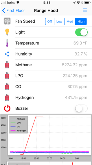

In this installment, I cover hooking up basically all the electronic components. I also start to get into some of the software work that I've done so far in Node Red. I won't get into much detail about the code in this post since it is more focused on hooking up the components & basic communication. Towards the end I also start integrating to the Home Automation server in OpenHAB via MQTT. This will provide a mobile user interface and allow external data to link in to the range hood - such as applying presence detection to flag if the stove is left on when we leave the house.
The user interface mockups I posted in the first blog are done through the OpenHAB HabPanel. I don't think I will use this on the final project since it would require an active connection to the home automation server. Instead, I think I will use the Node Red Dashboard add-on. It can provide buttons, display images and graphs. This should do all the things I need. Some of the info in this post was mentioned earlier, but the focus of this post is implementation versus planning. There was a lot of supporting circuitry to get the four analog sensors to read into the Pi, and I'll likely have one more follow up later on.

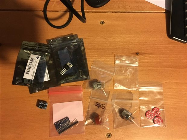

Electrical components:
4x "MQ" air quality sensors (see blog post #5)
4x N-Channel mosfets to run the heater circuits for said sensors
1x Analog to digital converter; I2C
1x Pi Camera
1x AMG8833 Thermal camera
1x relay board with 4 channels
1x DHT22 temperature/humidity sensor
1x bi-directional level shifter (bridge I2C bus between 3.3V and 5V)
1x radio shack buzzer (use case still to be defined; but I had one laying around, so why not?)
1x 4D Systems 2.4" touchscreen (See blog post #3 to see some of the problems that I still have to work out with this)
There was also some supporting circuitry for these items - various resistors, transistors, diodes, LEDs and so on.

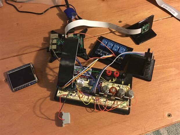

The first step was getting the breadboard populated. This was like a little game of Tetris trying to get everything to fit. I will be using both 3.3V and 5V components, so one rail on the breadboard was used for each. The Analog to Digital converter is running on the 5V rail to read the MQ sensors. It talks over I2C to the RaspberryPi over the bi-directional level shifter.
This is the end result -
The breadboard is obviously the large bit in the middle of the photo. Top right is the Raspberry Pi Camera. The four blue  cubes near it are the fan/light relays. On the right side is the thermal camera. The grey box near the bottom is the buzzer. I have the 4D touchscreen on the left.

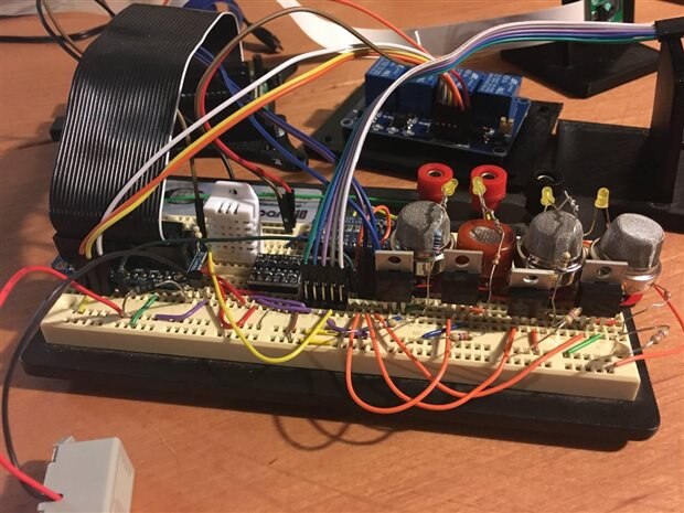

Here is detail of the breadboard -
On the right you can see the four MQ sensors with N-Channel mosfets in front of them. I have yellow LEDs up above to show the heater is running. To the left of that the cable comes in and lands for thermal camera. The ADC chip is slightly obscured from view on the far side of the board. The level shifter is just to the left of that. The white block is the DHT Temperature/Humidity sensor. Pretty crowded!

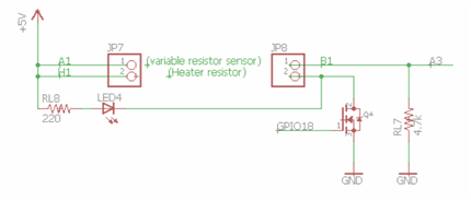

I started by soldering the four MQ sensors on little breakout boards. I found these on Sparkfun and they make the sensor more breadboard friendly. I placed them at one end of the board and placed my Pi Cobbler at the other end; then worked towards the middle.
The ADC went on one side and the level shifter straddled the middle.
I put the DHT at the end towards the Pi Cobbler and had just enough room to get a NPN on the board to trigger the buzzer.
The buzzer circuit also required a 150 Ohm base resistor and a anti-flyback diode just to be safe.
I brought all the pins for the thermal camera to a common connection point and used some jumper wire to plug it in.

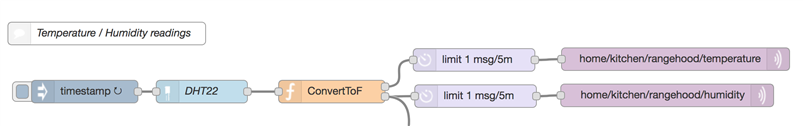

Here is an example flow -
The Timestamp node fires every second. It triggers a reading from the DHT temperature sensor. The DHT data is fed into a "Function" node to convert from C to F and save to global variables; and potentially other logic. We then split the data down two paths - one for temperature and one for humidity. This is sent through a rate limiter of 1 msg every 5 minutes. That then goes into an MQTT node to publish to the home automation server. There is a secondary line coming off the function block which leads down to trigger other flows.

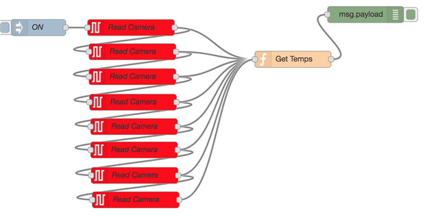

The raw data returned from the sensor is just temperature readings. This makes doing analysis much easier since there is no conversion from any RGB numbers. I'll do a separate post on how all that works, but here is an example flow where I read out one line of 8 pixels then process them out to the debug window. This is using a manual 'inject' node, then a bunch of I2C nodes to request the data.

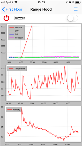

    Great post!  Your project is coming along nicely. You have a lot of cool pieces of information (sensor outputs), it will be interesting to see how you put them all together in terms of alarms and such.
    Keep up the good work! (You need to lower the methane levels a bit image)

    Thanks Gene - things are moving right along here with this project. Yeah - I have more work to do with reading the ADC and converting to PPM. Right now and in the screenshots the methane is reading around four volts for testing; and not the actual sensor value. I’m not far away just need to get it dialed in.
