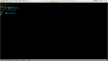

I hooked up the Touch Board via USB to the Raspberry Pi and had it send PLAYX (where X is the number of the electrode pressed) messages to the Pi over serial. Listing the tty devices, I determined the Touch Board was the "ttyACM0" device.

I installed "minicom" to verify the expected serial messages where being received by the Pi.
pi@PiDesk ~ $ sudo apt-get install minicom

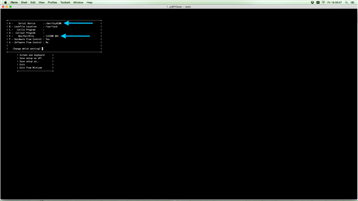

Using the minicom command with parameter "s", the serial port information can be configured. I specified the correct interface and baudrate and could see the messages coming in.
pi@PiDesk ~ $ sudo minicom -s

After taking the "strandtest.py" NeoPixel strip example and modifying it to react to serial input, the PLAY messages could trigger the LED strip. It does not yet make a distinction between the buttons being pressed, but the mechanism itself is working.
pi@PiDesk ~/rpi_ws281x/python/examples $ sudo python button.py
Press Ctrl-C to quit.
PLAY0
PLAY0
PLAY0
PLAY1
PLAY4
PLAY7
PLAY0
