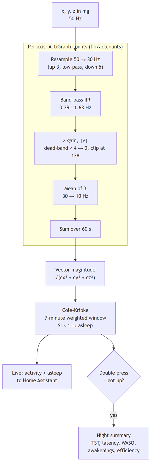

Part B — Sleep quality
The approach
Sleep tracking from a wrist sensor is called actigraphy, and sleep researchers have used it since the 1990s. Commercial watches add heart rate and proprietary models to stage light, deep and REM sleep. I used the published and Open route:
raw acceleration → activity counts → sleep/wake per minute → night summary
Every step has a published method and a reference implementation to test against. It tells sleep from wake, not sleep stages. For a caregiver, "slept about seven hours, woke up three times" is the useful part.
Step 1 — Activity counts
Sleep-scoring algorithms were designed on ActiGraph "activity counts", a per-minute number that ActiGraph devices have produced for decades. Their thresholds only mean something on those numbers. In 2022 ActiGraph published the counting algorithm (Neishabouri et al., Scientific Reports 12:11958). Per axis, the pipeline is:
  1. Resample to 30 Hz. The LIS2DE12 runs at 50 Hz, so the signal is upsampled by 3, low-pass filtered, and every fifth sample kept.
  2. A fixed 0.29–1.63 Hz IIR band-pass. This keeps human movement and removes gravity and vibration.
  3. Scale, then a dead-band (anything below 4 becomes 0) and a clip at 128.
  4. Average groups of three (30 Hz → 10 Hz) and sum over the minute.
The code is a streaming C library (firmware/lib/actcounts.c). It keeps only the filter state, so memory use stays fixed however long it runs. The core is the band-pass:

Step 2 — Sleep or wake, minute by minute
Scoring uses Cole–Kripke (Cole et al., Sleep 15(5), 1992). It looks at a 7-minute window around each minute and takes a weighted sum of the activity:
SI = 0.001 × (106·A₋₄ + 54·A₋₃ + 58·A₋₂ + 76·A₋₁ + 230·A₀ + 74·A₊₁ + 67·A₊₂)
Here A is the minute's count ÷ 100, capped at 300. A minute is **asleep if SI < 1**. The current minute carries the most weight, and the minutes before it count more than the ones after.
I chose Cole–Kripke over Sadeh for three reasons. It was developed on wrist actigraphy in adults, which is this use case. It's a fixed seven-tap filter that is cheap and easy to check by hand. And there's a clear open-source reference (the `actigraph.sleepr` R package) to compare against.
On the MCU the comparison needs no floating point. Multiply both sides by 100 000, and it becomes integer arithmetic:

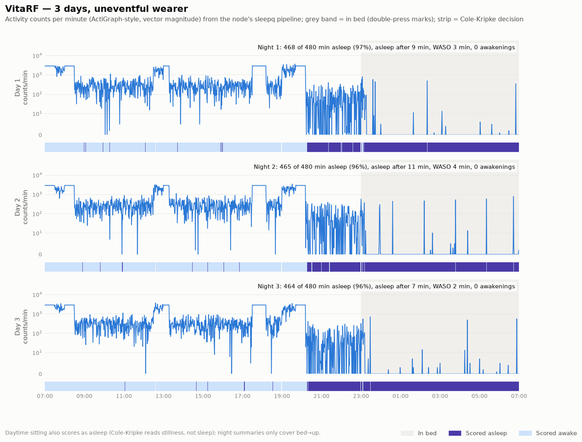

Step 3 — The night summary
Per-minute sleep/wake is noisy on its own, so the night summary turns a bed-time window into the standard actigraphy numbers:
Metric Meaning
Time in bed Bed mark → up mark
Sleep onset latency Bed → the first run of 10 consecutive sleep minutes
Total sleep time Sleep minutes between onset and the final awakening
WASO "Wake after sleep onset": awake minutes between onset and final awakening
Awakenings Wake runs of 5 minutes or longer after onset
Sleep efficiency Total sleep ÷ time in bed
The 10- and 5-minute run lengths are compile-time constants in sleepq.h.
How does the node know when you went to bed? It doesn't, and the algorithm can't reliably tell either. Lying on the sofa watching TV looks like sleep to an accelerometer. So the wearer marks it. A double press on the button marks bed time, and the LED flashes cyan. The next double press marks getting up. That press scores the remaining minutes, builds the summary, writes it to the flash log, and sends the sleep minutes to Home Assistant.
The pipeline runs all the time. Home Assistant also receives a live activity count and an asleep/awake flag every minute. The node keeps 12 hours of minutes: 720 × 2 bytes of counts, plus one bit per minute for the decision, about 1.5 KB. If the buffer fills during the day it starts over. At bed time it starts fresh if less than 10 hours of room is left, so a night never runs out of space.

To see how the sleep and fall code behaves over several days, I ran 72 hours of wrist data through the same logic the firmware uses. It is 50 Hz wrist acceleration from the LIS2DE12 at ±4 g, covering an ordinary routine: walking, desk work, meals, an evening on the sofa, bed at 23:00, and a few posture changes and twitches through the night. The data passes through the same code and the same bed and up logic as the firmware, fall detector included.
This time I had a very special guest who helped me track the signals. My Grandmother who is the old schools and believes good sleep is essential for health.
Night In bed Asleep Efficiency Fell asleep after WASO Awakenings
1 480 min 468 min 97 % 9 min 3 min 0
2 480 min 465 min 96 % 11 min 4 min 0
3 480 min 464 min 96 % 7 min 2 min 0
Time in bed was between 420 and 480 minutes across the three nights. To compare the nights in minutes rather than percentages, the table scales each night to a 480-minute window. Onset latency is 7–11 minutes. The night-time posture changes show as spikes, and Cole–Kripke rides through them, as designed. The fall detector raised no candidates in the 72 hours.
The chart also shows the main limitation. From about 20:15 the evening on the sofa scores as asleep, and so do scattered quiet minutes at the desk: 502 of the 2868 daytime minutes. Cole–Kripke measures stillness, not sleep. That's why the night summary only uses the window between the two button presses, and why the live asleep flag shouldn't be trusted on its own during the day.

  • Sleep: the algorithm is good at detecting sleep and weaker at detecting quiet wakefulness. Lying awake still will count as sleep, so expect it to overestimate sleep somewhat.

The LIS2DE12 does both jobs from one 50 Hz stream. The sleep counts follow ActiGraph's published method and match its reference data. Sleep scoring runs in integer arithmetic on the MCU. The fall detector runs on a 400 mg free-fall threshold, tuned for the wrist. Every fall goes through a 15 s countdown before anyone is told.
