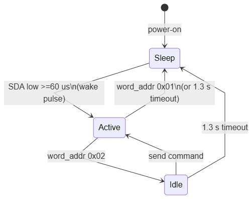

ATECC508A Primer
The chip's I2C address is 0x60 .It has four power states:
  • Sleep - default on power-up;
  • Idle - after the wake pulse, between commands;  Note that  "TempKey" (a 32-byte scratch buffer used by Sign and other commands) is preserved in idle but lost in sleep.
  • Active - executing a command
  • Wake transition - triggered by holding SDA low for at least 60 us.
Every transaction follows the same protocol - wake pulse, send a packet composed of [word_addr | count | opcode | param1 | param2 | data | crc16], wait the per-command execution time (Sign takes 58 ms, GenKey 115 ms, Write 26 ms, etc refer the datasheet for the timing.), read the response, then send a 1-byte "idle" or "sleep" word.

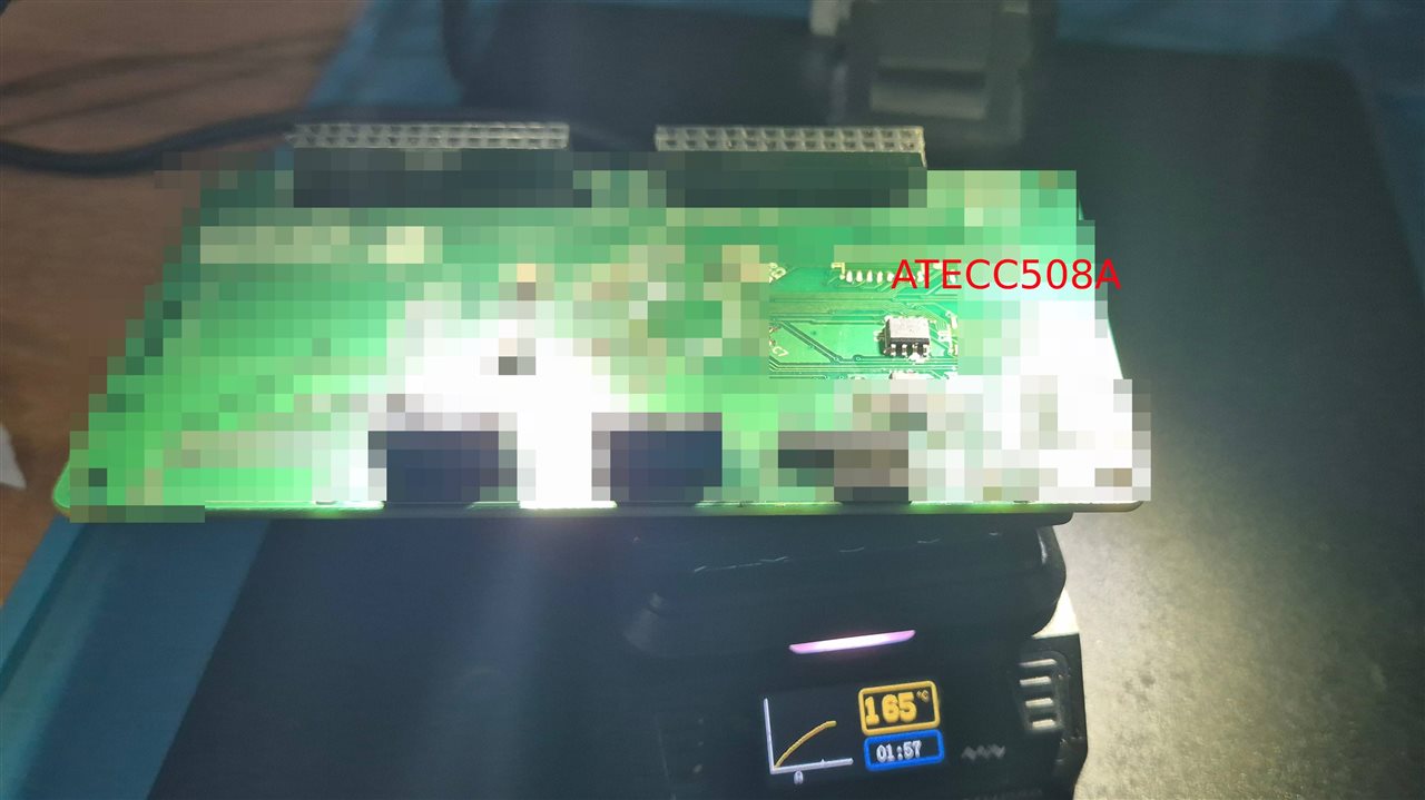

Now, when i started writing the HAL, I inadvertently chose to use an dedicated I2C, used a PCB board from my past work to interface it, so gonna be pixelating the board, It's a simple PCB but it is my policy,  I did have to enable the PMIC to enable 3.3V on L3OUT.  Now, had i used the I2CM2 which is shared with PMIC and IMU, i would not have seen the crypto chip working and would have had an meltdown. This is because I2CM2 uses I2C pull-ups to 1.8V but ATECC508 requires 3.3V. I think the minimum is some 2v.

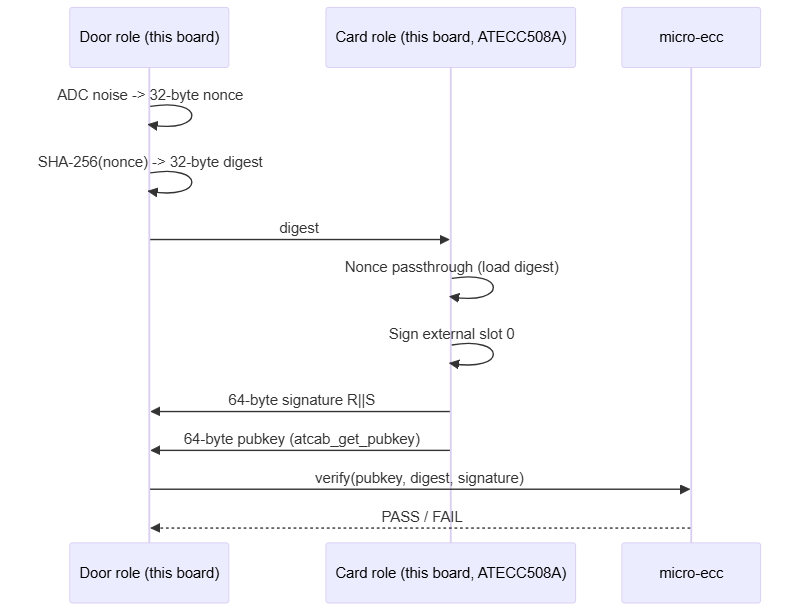

Verifying on the Door
The door device does not have an ATECC508A. Actually In the original proposal i wrote it, but to load all public key from django server is an impossible task, Then i thought, It only needs to verify signatures, not generate them. ECDSA verification is purely arithmetic with public values. there is no key to hide, so no need of secure element, so a software library is enough. I picked Kenneth MacKay's micro-ecc,
It is dropped in as a git submodule under third_party/micro-ecc/. The verify call is one line:
int ok = uECC_verify(pubkey64, digest, 32, signature64, uECC_secp256r1());
Where pubkey64 is the X || Y coordinates (no SEC1 0x04 prefix), digest is the 32-byte SHA-256 of the challenge, and signature64 is the raw singature rteturned in  returned by atcab_sign. (Step 2 above).
The End-to-End Bench Test
The same provision-verify firmware full crypto chain on a single board. After provisioning, two extra commands via serial will test the generation of nonce, signing via ATEC508A and veriofication via micro-ecc
Command Action
k Read public key from slot 0 via atcab_get_pubkey and print 128 hex chars
d ADC-noise nonce -> SHA-256 -> sign(slot 0) -> read pubkey -> uECC_verify; print PASS/FAIL

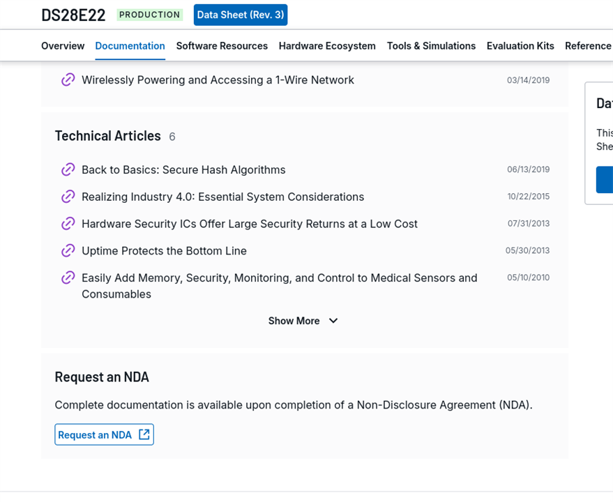

    arvindsa 6 months ago in reply to saramic +1
    DS28EL22 on the feather board is a awesome catch. It is not mentioned anywhere in the Feather datasheet, it is only seen in the BOM and the Schematics and it runs on One Wire protocol. Unfortunately, it…
  • arvindsa
    DS28E22 also have documents under NDA. Take a look at the bottom part of their web page

    But looking at the https://www.analog.com/media/en/technical-documentation/data-sheets/max32630fthr.pdf it does have a DS28EL22 https://www.analog.com/media/en/technical-documentation/data-sheets/DS28EL22.pdf a DeepCover Secure Authenitcator- you would think that has a random number somewhere inside? but the only datasheets I can find are abridged? is that common with these secure IC's?

    DS28EL22 on the feather board is a awesome catch. It is not mentioned anywhere in the Feather datasheet, it is only seen in the BOM and the Schematics and it runs on One Wire protocol. Unfortunately, it does not have a TRNG either and it runs on SHA256 Symmetric key, so it would be a 1:1 pairing rather than Many to one as is the advantage of asymmetric encryption.
