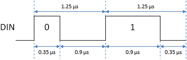

The WS2812B Protocol
The IC LED FeatherWing contains 1312020030000 LED which i loved working with in my previous challenge AuraAlert - Lighting up Every Sound. Seriously bright with awesome colors. It uses the popular WS2812B Protocol. In the Previous challenge, i never bothered with the protocol as i was using Arduino library to take care of it. This time I have been challenged to make the protocol code from scratch.
The Protocol is quite simple
  1. For starting a frame, send a 50uS low
  2. Each LED grabs the first 24 bits of incoming data (8 bits each for green, red, blue) and forwards everything else downstream.
  3. There is no separate clock line, and so '0' and a '1' are distinguished only by how long the wire stays HIGH within a fixed 1.25 us window.
  4. '0' is when there is 0.35uS high (T0H) followed by 0.9us of low (T0L)
  5. '1' is when there is 0.9us of high (T1H) followed by 0.35us of low (T1L)
  6. In this fashion, i have to provide 8 bit values of LED for Green, Red and blue (in this order)
Credits: https://mcuoneclipse.com/2016/05/22/nxp-flexio-generator-for-the-ws2812b-led-stripe-protocol/

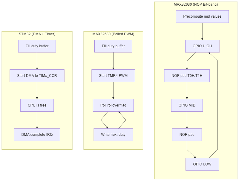

I miss my STM32s
Even though most of time I use Arduino Core for STM32 for developing a project fast, there are times when for serious production work, I had to use STM32Hal. There the approach is well established: configure a timer in PWM mode, hook a DMA channel to the timer's CCR register (Capture/Compare Register), fill a buffer with duty-cycle values for every bit, and fire it off. The CPU is completely free during the transfer. One call to `HAL_TIM_PWM_Start_DMA()` and you are done. The DMA engine pushes each duty value into the compare register on every timer period, producing a continuous PWM waveform with the right T0H/T1H timing. No CPU involvement, no interrupt-disable window.
The MAX32630 does not have this functionality, or it probably does and I can't find it. For now, there is no equivalent of the STM32's TIMx_CCR DMA burst mode. So I have two options:
  1. Bit-bang with NOPs: toggle GPIO directly, pad timing with NOP instructions
  2. Hardware PWM with polled duty update -  use the timer in PWM mode but update the duty register manually each bit period
Approach 1: NOP Bit-Bang
Easy to code, very unreliable. Drive a GPIO pin HIGH, wait the right number of NOPs for either a '0' bit or a '1' bit, then drive it LOW, wait again, and repeat. A NOP is "no operation" is a CPU instruction that does literally nothing for one clock cycle. Essentially it like delay() but at a more assembly level. Join many NOPs to get a precise, calibrated delay.
The Feather is clocking at 96 MHz, one CPU cycle is ~10.4 ns. But NOPs do not take exactly one cycle due to APB bus write latency when toggling GPIO. I measured the effective NOP rate at 10.85 ns/NOP by capturing waveforms on a scope.
I tried a lot, but I never got the LED working at all. So I decided to let it rest. At 7x15=105 Led's it will take around 3.2ms for sending data to the LEDs, that will not play well with my 50hz IMU data reading.
Approach 2: Hardware PWM with Polled Duty (icled-timer)
Let the timer peripheral generate the precise waveform timing, and the CPU only needs to update the duty register between bit periods.

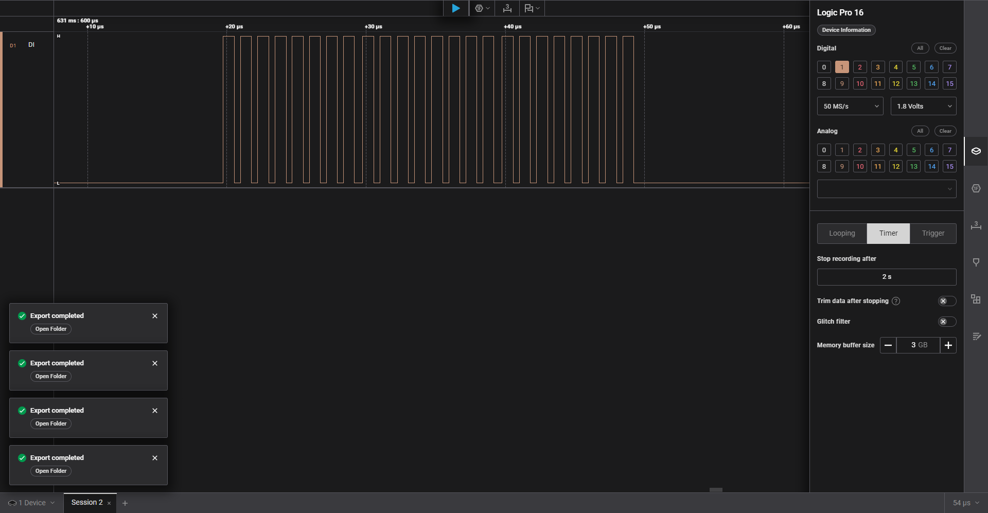

This is the waveform of full brightness of one single LED. This was taken when i used one single WS2812B 5050 with adafruit adapter to test out if the green led bug was not repeated on a known led. Fixed the problem while it was attached on it. Forgot to capture waveform on the ICLED. I promise to take better waveform capture in the future.

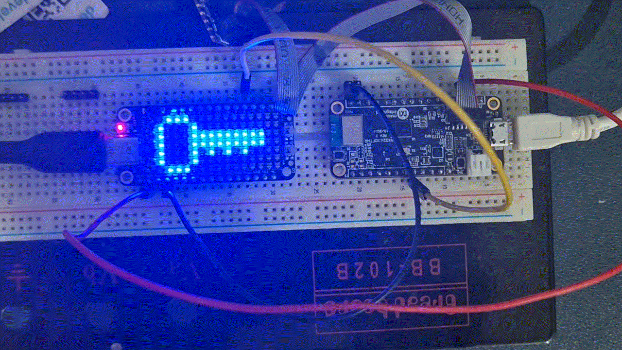

Results
All five icons cycle correctly at matched brightness on the 7x15 matrix, with no LED 0 corruption after the warmup fix. The icons are distinct and readable from about 2 meters away even at these low brightness levels. The values i am sending are like (10,0,0), (5,0,5) etc out the max possible (255,255,255).  I remember bitluni talking about how bright these get. Take a look here - https://youtu.be/oz9Ys7CR7cw?si=4rfxHv0VRZoPAYYE&t=736 (t=2:18 onwards)

Coming from STM32 where WS2812B driving is a solved problem (timer + DMA, done), doing it on the MAX32630 was an interesting exercise in working within hardware constraints. The polled PWM approach works well, I do not know if there is a better way to implement this, but since this works i am gonna be happy about it.
