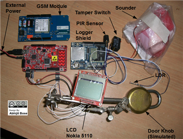

Lots of progress this week in terms of hardware and software.
Most of the parts that I disused in the earlier post have now been interfaced and working in software.

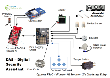

Here is how DAS looks now with respect to its block diagram:

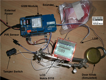

There are two shields on top of the Pioneer kit:
1. Arduino GSM ShieldArduino GSM Shield on the Top
2. Logging ShieldLogging Shield below it on top of Pioneer Kit.

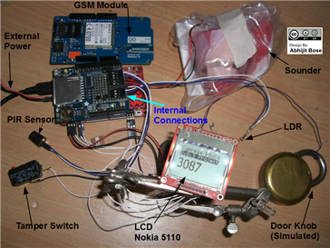

Here is a shot of the top Shield removed:

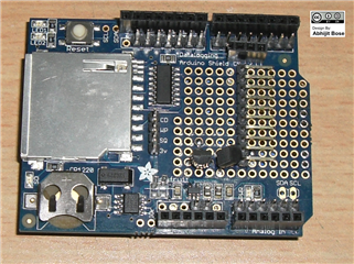

It also shows the modifications done on the Logging shield to interface the various sensors.
Now dissembling all of the shields shows the parts:
The system is being powder using an eternal DC supply of 9V and to my surprise the Pioneer Kit + sensors + LCD back light + GSM Module takes a peak 200mA
As of now the focus is more on getting the software ready for all the hardware that has been interfaced so its alright to continue with an external supply.

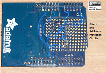

Here are some details of the wiring done on the Logging shield to interface the Sensors:

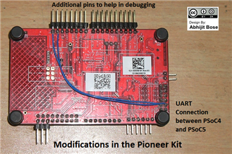

There were some modifications done to the Pioneer Kit as well to help in debugging and a permanent USB-UART interface available all times.
