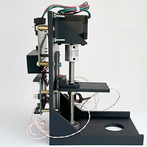

Step 4: 3D Printing & Assembly
As I was determined to make a plug and play solution so that the project helps to control sewing machine by hand without modifying anything in the machine, I realized the necessity of 3D printed model. I spent some time on think the easiest solution and finally I was able to design a simple, compact and workable model. Generally sewing machine uses foot pedal for controlling and users use their foot and press on the pedal. So, we need to replicate the press of human foot I developed a 3D printed vertical mechanism for pressing the foot pedal down based on the hand finger bending. I used the following components for the pressing mechanism.
I added the links of the main components in the reference section. I designed and 3D printed the following parts. The .stl design files are attached in the attachment section. The left top is the stepper mount, the left bottom is the armature and the right big part is the base.
The following image shows the assembly of the stepper mount with the base using 4 M3x15 screws.
The assembly of the armature with the threaded rod and screw is shown in the following images.
The following photo shows installing the linear rail that helps to smoothly guide the armature vertically up and down.

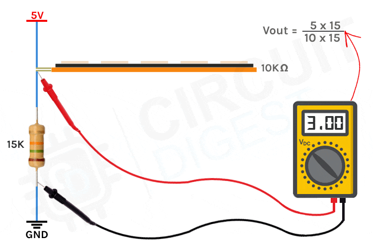

Step 5: Adding Flex Sensor
I am going to use a Flex sensor to control the stepper motor based on the bending of the finger. A flex sensor is a low-cost, easy-to-use variable resistor that is designed to measure the amount of deflection it experiences when bent. The sensor's resistance is lowest when it's straight or flat on the surface, increases when we bend it slowly and reaches its maximum when it's at a 90-degree angle. Due to it's size a flex sensor can be easily attached with the finger to measure the bending of the finger.
As already said, a flex sensor is a variable resistor that varies its resistance upon bending. As the resistance of the sensor is directly proportional to the amount of bending, it's often called Flexible potentiometer. This sensor is commonly available in two sizes, the first is 2.2” and the second one is 4.5” long. I am using the 2.2 inch flex for my project. When the sensor is straight the resistance is about 25K, and when the sensor is bent the value is 69K. As flex sensor is a resistor we must convert the resistance to voltage to read it using MCU. To get a proportional voltage to the sensor we need to make a voltage divider circuit attaching a fixed resistor in series with the sensor as shown in the animated image below. Based on the bending the resistance of the sensor changes and the output voltage also changes accordingly.
The image was taken from circuitdigest.com
The sensitivity of the sensor depends on the value of the fixed resistor connected with the flex sensor. For calculating the exact value for maximum sensitivity first I measured the resistance of the sensor when it is straight and when it is bent at 90 degree. Then I calculate the resistance for getting the maximum variation in the output volage using Microsoft Excel.
I got the maximum sensitivity for the resistance of 41.5K. So, I planned to placed a 50K trim pot and set it to 41.5K and then connect it in series with the Flex sensor to get the maximum sensitivity. But for testing I connected one 20K and one 22K resistor in series for getting an approximate output.  I used the following code for running the motor based on the bending.

Step 6: Adjusting Torque and Current Rating
After making the linear pressing system with the 3D printed parts and stepper motor I was curious to check it with the foot pedal of the sewing machine. The pedal is not very easy to press and it requires a moderate amount of pressure to operate. It can be comfortably done with the foot but I was a bit afraid of whether my pressing mechanism is capable of moving it down or not. For checking it I placed the foot pedal at the bottom of the armature and started the motor. I was disappointed, it stops when the armature touches the pedal. After thinking for a few moments I got the idea of increasing the supply voltage. I removed the power adapter and connected a power supply to the TMC5272 controller board. I set the voltage to 12V and observed the current and it was only around 60mA while running the motor. I increased the voltage to 20V and this time motor was capable of pressing down the foot pedal as shown in the video below.
Though it worked I was not convinced to do it by increasing the voltage. I wanted to make it workable with 12V because the challenger kit includes a 12V power supply. So, I started reading the TM5272 datasheet again to find out whether it has any solution. The article "Setting the Full-Scale Current" on page 54 drew my attention. I got an equation for the RMS and Peak current.
I came to know that by configuring the DRV_CONF register we can set the 100% current or less and the default current setting is not 100%. From the table 14 and 15, I found the required value for the DRV_CONF register for an expected current. I revisited the code and found that the content for four LSB bits is D (1101) which means FSR_Mx bits are 01 and FSR_IREF_Mx bits are 11 which allows a maximum 410mA for the motor. It should work but not!
Possibly the current was not bad for pressing the pedal but it was not working for any reason. I changed the contents of the DRV_CONF register and replaced D with F. F will allow maximum current (800mA) to the motor. I added the marked line in my main code inside the setup function with other configurations to write the value to the DRV_CONF register.
Surprisingly it worked and this time motor was capable of pressing the pedal very easily even from an 8V supply. Current flowing was also increased reasonably.
Watch the video below:

Images of the Finish Project
I made the final assembly using all the 3D printed parts, all the circuits and the mechanical components. I am surprise by seeing the final output of my creation. It is really cool, compact and stable. Most of the cases I used nuts and screws for assembly. Arduino barrel jack and the the power terminal of the TMC motor controller are connected together and attached with single barrel jack. The barrel jack is attached with the body of the main base.
My favorite image:
