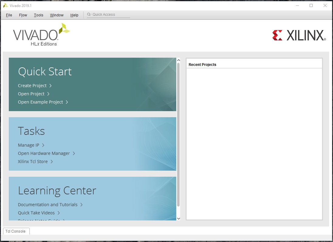

In this chapter I am going to try my first steps with the Vivado software.
To install Vivado I followed the instructions shown in the following tutorial: Installing Vivado, Xilinx SDK, and Digilent Board Files
In my case, I installed Vivado 2019.1 (Windows 10 version), which took me 3 hours to download it and 1 hour to install it. Its necessary to register on the official Xilinx site: https://www.xilinx.com/
We run Vivado and see this:
