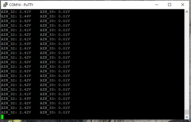

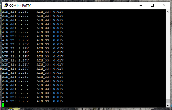

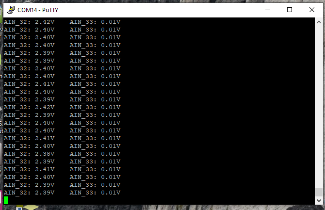

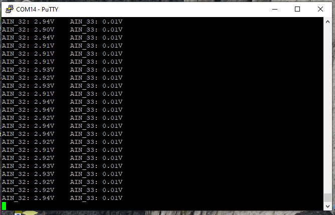

  5. For the calibration of the pressure sensor MPX2050DP I have used a pressure gauge;
  6. I have also used a manual air pump to input the air pressure onto the MPX2050DP pressure sensor. I also release the air leak with a knob valve;
  7. Finally I have compared the voltage readings with the pressure in mmHg.
The video with the tests is shown below:
The calibration obtained is shown in the images below:
300 mmHg -> 2.45V
240 mmHg -> 2.41V
180 mmHg -> 2.38V
120 mmHg -> 2.37V
60 mmHg -> 2.33V
0 mmHg -> 2.30V
