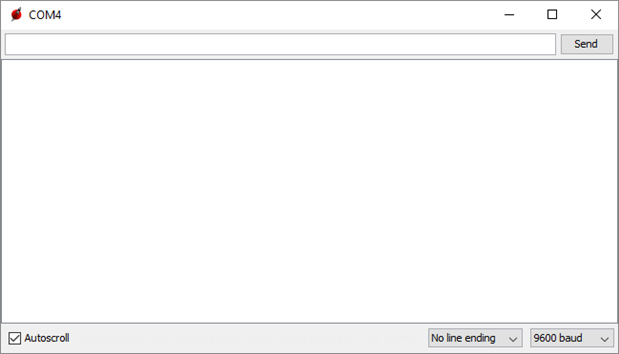

Sadly for the past week of various testing I have not been able to see anything come across to the TI MSP432 like I have was able to see with the Arduino Uno.
I even went so far as to pull the TI MCU and reset up everything with my Uno just to be sure my GPS was still working and I was able to see traffic both with Hardware as well as Software switch enabled.  So the GPS is good to go.
I have put a request out to others to see if anyone has some suggestions in coding that I can use to check my setup so hopefully either someone may have a suggestion or I will come across another hint somewhere else.

No success with this led me to research a little more and I found hints that perhaps the pins were actually serial1 not plain serial so I even modified the code and ran it as such but still nothing across.

    jkutzsch , what are the pin numbers you're actually connecting the GPS shield's RX and TX to on the MSP430?
    According to a cursory search on the internet the hardware UART pins are 3.2(rx) and 3.3(tx) aka pins 3 and 4 on the Energia Pin map.
    The secondary serial port is apparently shared with USB, so if you're using that one you won't see anything on the serial monitor.
    If it's still not working then I'd suggest it's a baud rate issue.

    You might need to enable the pins with pull ups on the MSP432 to get them to work properly with the GPS device.
    Check the pin numbers on the MSP432, but you should have something like:
      pinMode(6, INPUT_PULLUP);
      pinMode(5, INPUT_PULLUP);
      pinMode(9, INPUT_PULLUP);
    However, as is quite common when trying to use Arduino compatible shields, they are usually set for 5v where as other devices are 3.3v on the GPIO as i believe the MSP432 is.  In this case, you can a level shifter from 5v to 3.3v between the MSP432 and the GPS board to convert between the two values.
    In Energia, there should be an UART example  for the MSP432 that you can use to test the com port functionality and use that as a baseline for the GPS.

    Sounds like a proper nightmare. So simple nothing can go wrong, but it doesn't work.
    If you can try looking at the signal coming from the GPS with a scope, you can figure out if the pins are connected correctly, whether the voltage is correct and what the baud rate is.
    On the Launchpad, adjust your code to print every character that is received - don't wait for a CR or LF character. This should confirm if you have the correct receive pin configured.
    If the character string is to short, it may indicate the baud rate is too low and vice versa.
    I think all of my GPS devices work on 3.3V, but I know some others can work with 5V.
    Maybe you can find a loop back test program and connect the TX to the Rx on the Launchpad to ensure the serial port is working.
