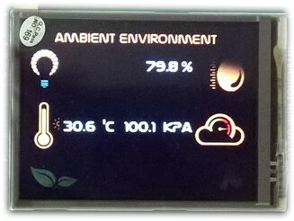

     - display the ambient temperature, humidity and pressure on TFT

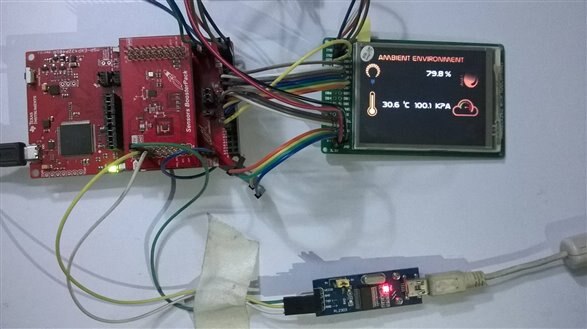

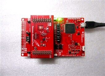

Components:image
  • Sensors Boosterpack
  • MSP432 Launchpad
  • TFT Proto
  • mikroplot [UART PC GUI]

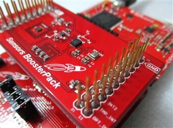

BME280 [BOOSTXL-SENSORS]:
BOOSTXL-SENSORS boosterpack carries BME280, an integrated environmental sensor from BOSCH.
It’s a small low power single chip sensor that measures temperature, pressure and humidity.
It communicates with the MSP432 Launchpad through I2C.
BME280  I2C address = 0x77

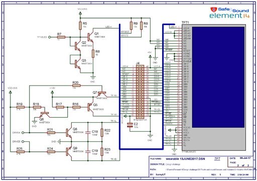

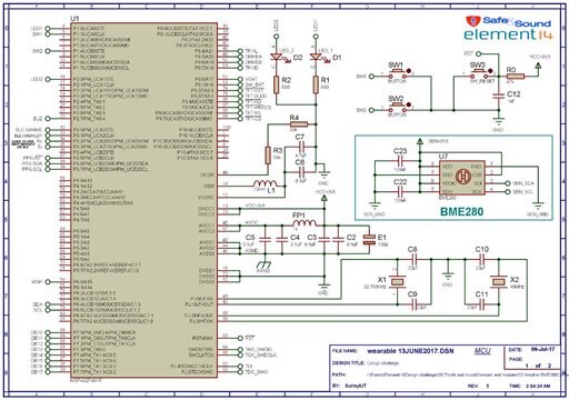

Circuit Diagram:
     MSP432P401r with BME280                                             TFT display connection

The output of BME280 is pretty stable.
For indoor experiment, it gives the following readings -
  • ambient temperature = 30.6 'C
  • relative humidity = 79.8 %
  • atmospheric pressure = 100.1 KPa

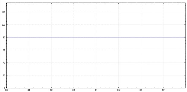

I have sent these data [one parameter at a time] to PC GUI for plotting.
I have used 'mikroplot' to graphically represent continuous 8 seconds readings.

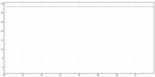

Temperature -
Humidity -

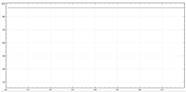

Pressure -
