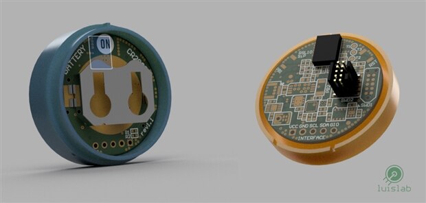

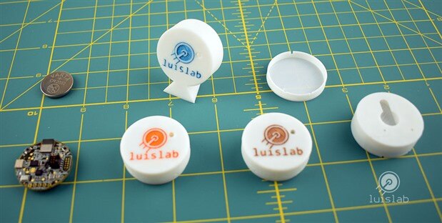

With the technical side of the project progressing well, I started 3-D printing some enclosures for the RSL10 Beacons -honestly I always find an excuse to add 3D printed parts to my projects. At this point I got creative and came up with various types of enclosures.
3D Print settings
Below the settings used in Cura:
  • Printer: Creality CR-10S
  • Material: PLA White
  • Infill: 20%, Gyroid
  • Adhesion: Skirt
  • Supports: No
  • Layer height: 0.2mm

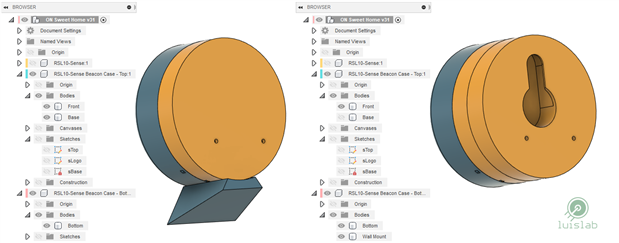

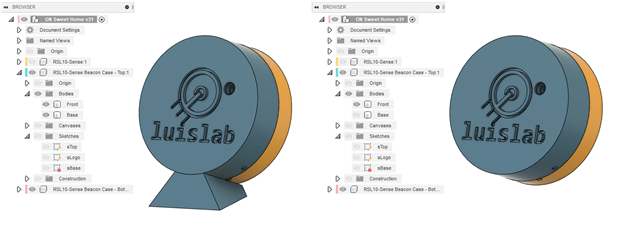

Front Cap
The front cap has tiny holes that allow the sensors inside to breathe and a place for a 2mm light pipe2mm light pipe. I designed two of them with/without 20 degree stand.
Back Cap
The back cap also has tiny holes that allow the sensors inside to breathe and a Wall Mount option

    Very nice... How are you doing the color for the logo on the 3D prints?

    Hello fmilburn and dubbie,
    Thank you for you comments. To make the colored logo this is what I regularly do:
    • Design a recess in the 3D printed part of about 2-4 layer deep (use multiples of your layer height settings for better results). On big logos you can use more layers.
    • For big logos use a small syringe to fill in the recesses with some paint (I used water-based but there are better and more durable options)
    • For small logos I just use a very small detail-paint-brush and fill in the cracks with paint as best as I can.
      • For small logos, since is nearly impossible to add paint just in the recesses, I just sand with 1000-1500 grit until the paint imperfections aren't visible. It really helps here if you have a printer with a very smooth print bed -mine has a glass bed so parts come up near mirror finish (not a lot of sanding needed in this case)
    • (optional) add a translucent protective paint coat.
    Here is how a Tennis Racket Butt cap looks like (this one is the first colored logo I made)
    Hope this helps.
    Luis
