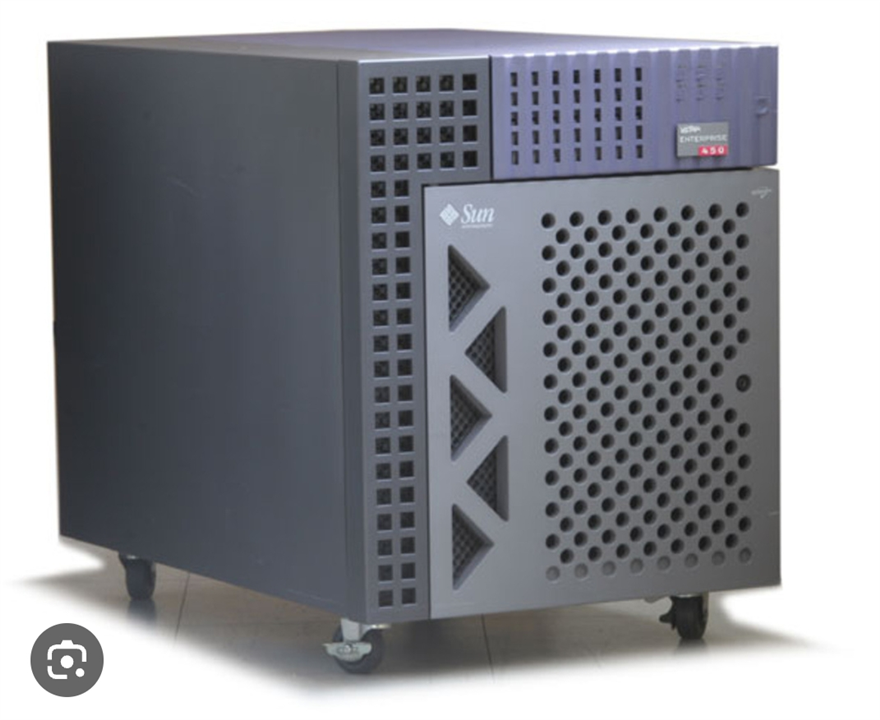

    shabaz over 2 years ago
    Great idea! This makes total sense as far as I'm concerned. For ages I wanted to turn this thing into a refrigerated drinks cabinet:
    (Image source: Google images)
    I think we spent a year at work trying to decide how best to tackle it, it needed a lot of metalwork. In the end we reluctantly e-wasted it during a move. I still have one of the CPU modules for it because they are works of art.
