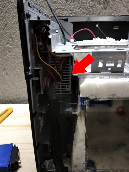

First of all, I removed the bottom part of the frame that used to host the Hard Disk drives. This will let me create a larger refrigerated cell

Box has been put in place and covered with expanded polyurethane foam. Excesses have then been trimmed using a cutter
{gallery}Cell covered with foam

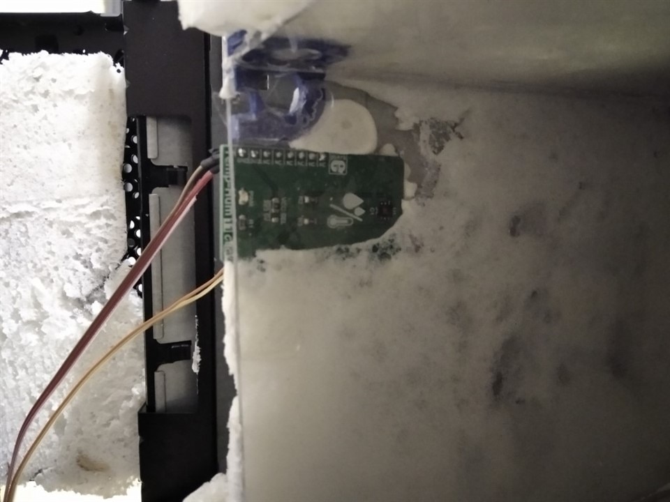

The Temp&Hum Click board has been put in place and covered with insulating material (not foam, to make it easy to access and replace in case of issues)
Finally, I mounted back in place the power supply
Everything is ready to install the control board with all the electronic components. Stay tuned for the next blog!
