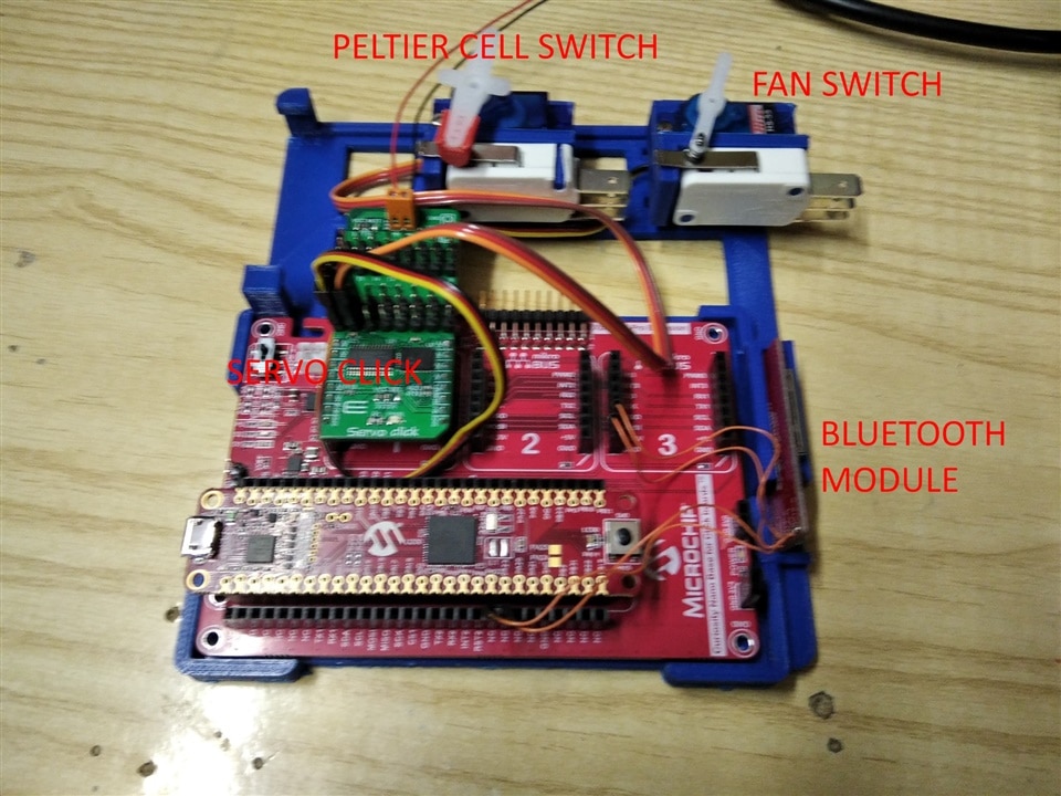

1. Bluesmirf module
Inside the mini fridge, I installed a Bluesmirf board. This board is now obsolete, but it can easily be replaced by a more up-to-date board that implements the Bluetooth serial-replacement profile
The Bluesmirf has a default baudrate of 115200 and I am not going to change this default. The init() function performs the following tasks
  • Switch from data mode command mode, by sending the string “$$$”
  • Send the command to set Bluetooth slave mode (this is not strictly required, since this is the Bluesmirf’s default mode
  • Switch from command mode back to data mode by sending the string “---”

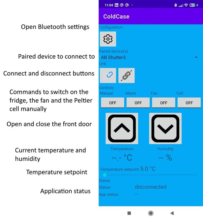

3. Android app
User can interact with the robot by means of an Android app, whose interface is shown in picture below
