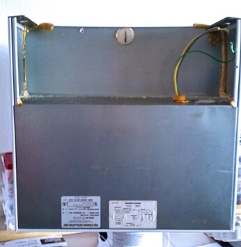

The rear of the minifridge.  One of the things I like about having if flipped upside down is this creates a shelf area for me to place items I want to keep outside of the heat and humidity that will be inside the R2I.
Zoom in on the shelf, right hand side.  We have the internally ran 3 wires as well as a small hole that goes inside the R2I that I can use to run additional wires through.

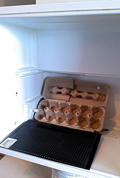

Here is the inside showing the hole coming down into the R2I as well as those 3 wires over on the bottom right.

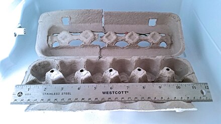

Here is a basic 12 egg, egg carton with ruler to show sizing.  Using this I believe I can easily accommodate 4 rows of 6 eggs for a total of 24 eggs. Based on chicken eggs.
Future modifications will be made to allow for swapping out for smaller eggs such as quail or larger such as duck.  Although some of our chicken eggs are as large as duck eggs!
My first idea is to take some aluminum I have been working with and mark out the 24 eggs.  Then clipping in an X for each egg, bend the cut pieces down to allow for the eggs to be inserted into the framing.
A central support rod will be ran across the top from left to right that the egg frame will be attached to.
If you look really closely on the left hand side you will see a mark up on the top 3rd of the wall.  That is where I am looking to run the support rod to allow for the eggs to be rotated.
If you notice, the aluminum leaves spacing on the right hand side of the R2I.  Originally I was going to run the framing across the entire area allowing for more eggs. But with discussion about testing a lightbulb I have decided to keep a space open there for the light bulb to be placed.  A fan will circulate the air above the light bulb.
This has the added benefit to hopefully avoid goo/debris from dropping onto the heat source as the eggs hatch.
There is plenty of space on the bottom to allow for a water dish for humidity control or other items I may want to include but keep clear of goo/debris.

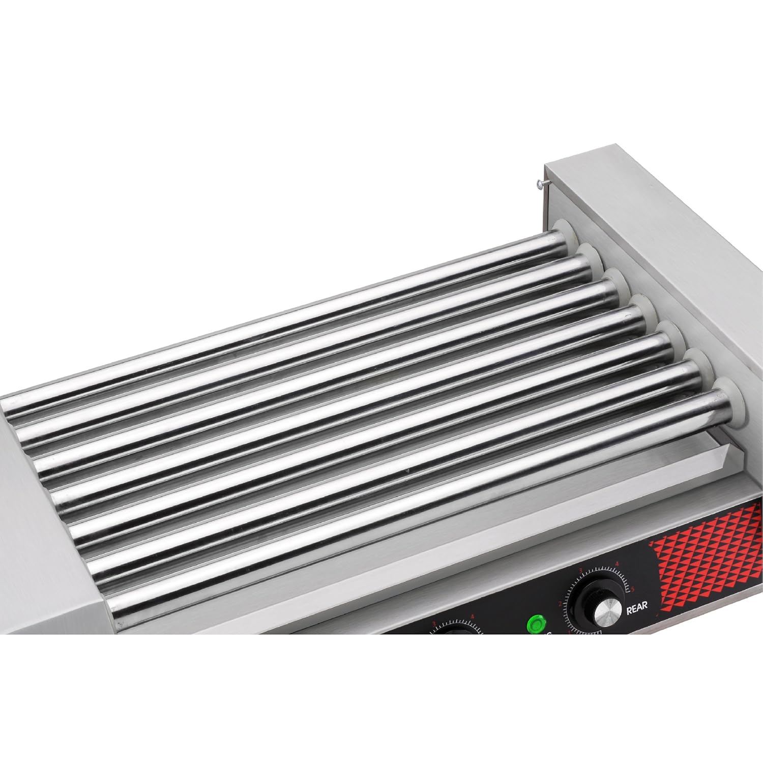

  • Robert Peter Oakes
    Robert Peter Oakes over 9 years ago in reply to mcb1 +2
    I was thinking a weiner roller but the chickens would hatch either very dizzy or scrambled (not good either way )
    mcb1 over 9 years ago +1
    Have you studied how the commercial smaller incubators do the egg rotating thing.? What happens when they hatch, do they stay put or are they likely to move around? With a fan the position of the heat…
    I was thinking a weiner roller but the chickens would hatch either very dizzy or scrambled (not good either way image )
    Image result for wiener sausage rotator
    With a fan the position of the heat source is basically anywhere ...which gives you much greater flexibility.
