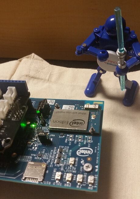

Of course it won't actually do anything unless you change the board to your new Intel Edison board so make sure to switch to the Edison.
Using the tried and true Blink sketch I had as the default sketch I quickly uploaded over to the Edison to see if it was working.
There we see the Blinking Led showing that your Arduino IDE is now connected and communicating with your Edison.  Congratulations!
