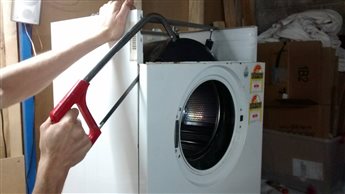

Washing Machine Modifications
Upcycle It - Washing Machine Hydroponic Grower - #2 Preparation
Upcycle It - Washing Machine Hydroponic Grower - #3 Preparation II
Concrete ballast and some of the panels were removed. Also, most of the internal parts and wiring were stripped, leaving only the tumbler and the structure to hold it in place.

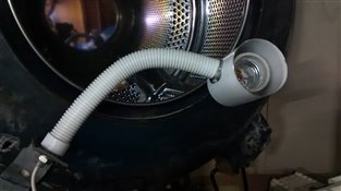

Grow Light Fitting
Upcycle It - Washing Machine Hydroponic Grower - #4 Preparation III

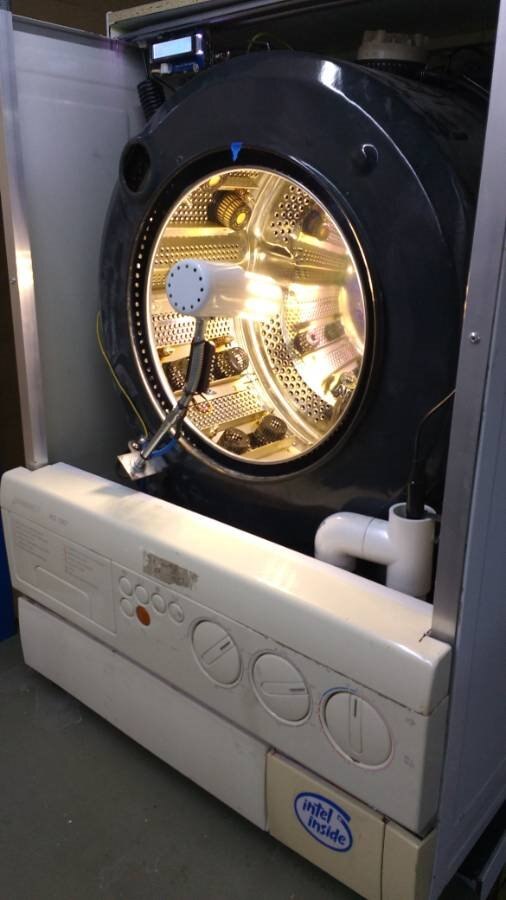

Upcycling also an old table lamp, the grow light fitting was mounted on a bracket off the drum. Having a flexible goose nose, it can be easily bent away and returned to the position when loading and unloading the plants in the drum.

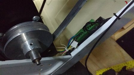

A printer stepper motor was mounted roughly at the same position where the original motor was so the original pulley and belt system was kept to turn the drum. The driver was mounted next to the stepper.

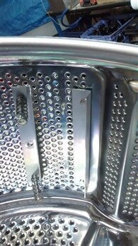

Drum Modification
Upcycle It - Washing Machine Hydroponic Grower - #6 Drum Modification

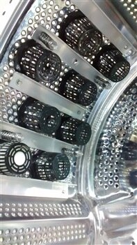

We added spring loaded rails to secure hydroponic baskets in place once the drum starts spinning.

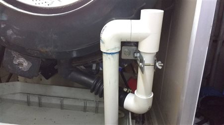

Nutrient Solution System
Upcycle It - Washing Machine Hydroponic Grower - #8 Nutrient Solution System
A reservoir was placed under the drum so the nutrient solution can be pumped to keep the required level inside the drum.

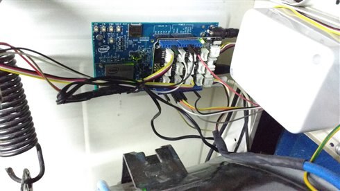

Sensors and Interfacing
Upcycle It - Washing Machine Hydroponic Grower - #9 Interfacing Edison X Grower
Temperature/Humidity and Light sensors were fixed on the light mounting facing the inside of the drum. The PH probe was fixed inside the return pipe so the probe is constantly submerged. The relays that switch the light and water pump were mounted inside a junction box.

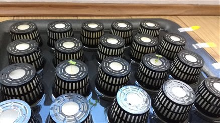

Preparing the growing baskets
Upcycle It - Washing Machine Hydroponic Grower - #11 Planting

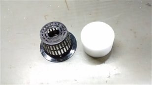

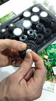

The seeds are placed in a cut on the foam and left on a tray to germinate before going to the drum.

This is the final apparency of the Rotary Growing System

    Ho DAB,
    I am also excited to see it germinating. I have the baskets with the seeds on a tray filled with water at home for more than 1 week but I cannot see any signal of germination yet. The idea is exactly what you mentioned. As the baskets are so small I can only put 1 seed per basket so there is a possibility to have none growing in some. Therefore, I will leave them on the tray and once I can see the sprouts I will place the successful ones in the drum.
