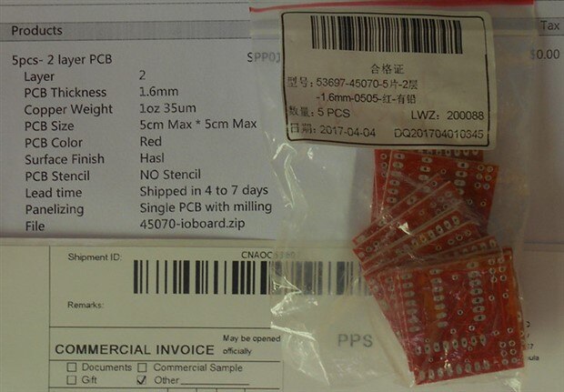

Below is the Eagle PCB design. In SOCKET1 and SOCKET2 pin headers are placed on the bottom side of the board. These pin headers will fit into two 7490 sockets on the counter PCB. The Eagle design files and the Gerber files which are needed for PCB production can be found on GitHub (https://github.com/AgriVision/Nixie_Edison).
I uploaded the Gerber files to a PCB manufacturer and ordered the PCB's. Currently I'm waiting for them.

I got an email from the PCB manufacturer, that the boards are ready and shipped. The company sent me a order conformation and a photo of the ready boards. I hope they will soon arive in my mail box.
Thats it for this week, stay tuned image.
