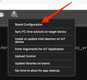

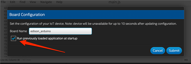

Remember the problems I had starting the arduino sketch on boot time ([Upcycle It] Nixie Display #4 - Got Started with the IntelRegistered Edison Development Board on macOS).
With Node.js and XDK this works flawlessly. Just select 'Board Configuration' from the manage button,
and check the 'Run previously loaded application at startup' checkbox.

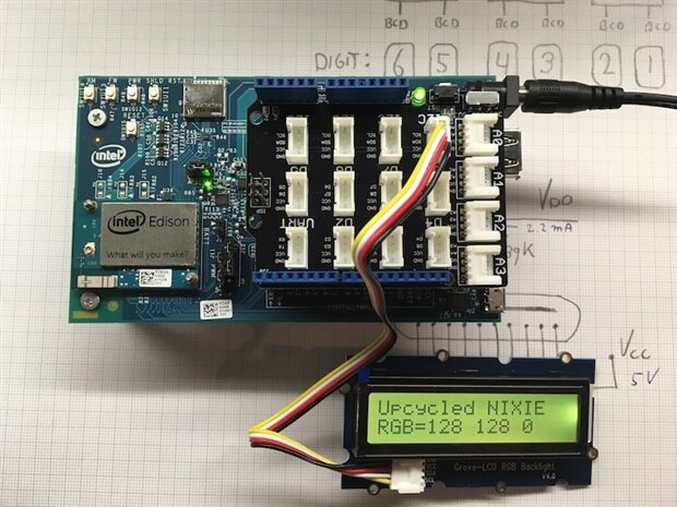

Then I tried the I2C LCD demo from the available templates. I modified the code a bit:
 * Drive the Grove RGB LCD (a JHD1313m1).
 * This can be done using one of two methods:
 * Use the UPM library, which contains direct support for the LCD device.
 * Alternatively, in this app, we will drive the LCD directly from JavaScript
 * using the I2C interface directly. This approach is useful for learning
 * about using the I2C bus. The LCD file is an implementation in JavaScript
 * for some common LCD functions.
 * Supported Intel IoT development boards are identified in the code.
 * See LICENSE.md for license terms and conditions.
 * https://software.intel.com/en-us/xdk/docs/using-templates-nodejs-iot
/* spec jslint and jshint lines for desired JavaScript linting */
/* see http://www.jslint.com/help.html and http://jshint.com/docs */
/* jslint node:true */
/* jshint unused:true */
"use strict" ;
// we want mraa to be at least version 0.6.1
var mraa = require('mraa');
var version = mraa.getVersion();
if (version >= 'v0.6.1') {
    console.log('mraa version (' + version + ') ok');
else {
    console.log('meaa version(' + version + ') is old - this code may not work');
useLcd();
 * Rotate through a color pallette and display the
 * color of the background as text
function rotateColors(display) {
    var red = 0;
    var green = 0;
    var blue = 0;
    display.setColor(red, green, blue);
    setInterval(function() {
        blue += 64;
        if (blue > 255) {
            blue = 0;
            green += 64;
            if (green > 255) {
                green = 0;
                red += 64;
                if (red > 255) {
                    red = 0;
        display.setCursor(0,0);
        display.write('Upcycled NIXIE');
        display.setCursor(1,0);
        display.write('RGB=' + red + ' ' + green + ' ' + blue + '   ');
    }, 1000);
 * Use the hand rolled i2c.js code to do the
 * same thing as the previous code without the
 * upm library
function useLcd() {
    var i2c = require('./i2c');
    var display = new i2c.LCD(0);
    display.setColor(0, 60, 255);
    display.setCursor(1, 1);
    display.write('hi there');
    display.write('more text');
    display.waitForQuiescent()
    .then(function() {
        rotateColors(display);
    .fail(function(err) {
        console.log(err);
        display.clearError();
And here is the result:
So far my experience with Node.js is positive and for the Edison I prefer this above the Arduino SDK.

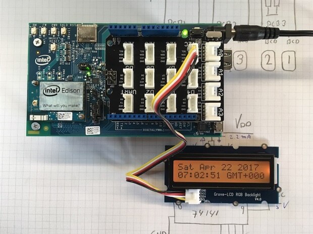

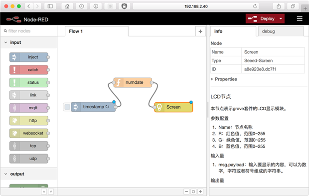

That one worked, with three simple blocks I got a clock up and running, here is a picture of the flow:
The timestamp injects the number of milliseconds since January 1st, 1970 into the flow. The 'numdate' is a function node in which I put code to convert the time number to a readable time string:
// Create a Date object from the payload
var date = new Date(msg.payload);
// Change the payload to be a formatted Date string
msg.payload = date.toString();
// Return the message so it can be sent on
return msg;
And the screen node is the LCD screen from the node-red-contrib-smartnode-seed node. As you can see the info field has the Chinese locale. That doesn't influence its functionality, but would be nice if there also is a english translation available. I will have a look at that later.
So using this three simple blocks I built a clock. What also is very convenient is that it automatically starts when powering up the edison.
As you can see it is displaying GMT time, which is not my timezone. This could easily be fixed by changing the local time file:
root@edison_arduino:~# rm /etc/localtime
root@edison_arduino:~# ln -s /usr/share/zoneinfo/Europe/Paris /etc/localtime
root@edison_arduino:~# reboot
root@edison_arduino:~# date
Sat Apr 22 17:20:44 CEST 2017
Thats it for this week, Node-RED looks like the ideal candidate to continue my project image.
