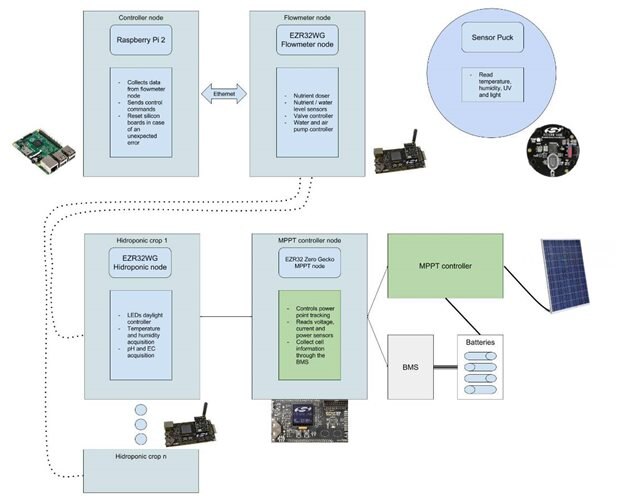

We extensively used the components of the provided kit:
  • EZR32WG 868MHz Wireless Starter Kit was used to read the majority of sensors and control actuators.
  • Sensor Puck was used to monitor temperature, humidity, ambient light and UV index. We modified the Sensor Puck Android app from Silicon Labs in order to send the measured variables to our web application through a REST API.
  • EFM32ZG-STK3200EFM32ZG-STK3200 Zero Gecko Starter Kit was used to develop our solar energy system with MPPT.
  • The remaining components (including Würth Elektronik’s components) were used to develop several modules of our system, especially the MPPT board.
The following diagram depicts the system architecture. It’s noticeable the extensive use of Silicon Labs’ components.

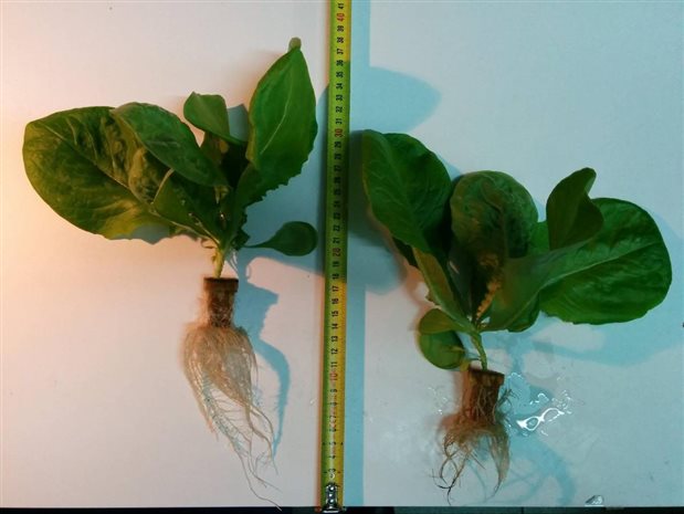

Considering we are growing 80 plants as shown on the previous post with different results considering the position, we choose some of our best crops to show some metrics.
We reached a leaf height of up to 26 cm and a radicular height up to 14 cm on plants with 8 to 10 leaves with a weight of up to 200 g.
We are not completely aware of the best harvesting time as we see them still growing with a fast rate. Most probably we will start the next model round within 10 days.

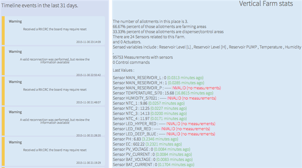

Follow Our Crops on Growsharp.tk

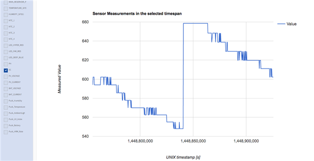

We invite everybody to follow our crops on growsharp.tk and login with user name guest and password verticalfarm. To see sensor measurements select Coimbra Vertical Farm, Sensor Readings, select the allotment (area 2 for instance):
and then click “Live Stream” on the desired sensor to see the measurements in real time.

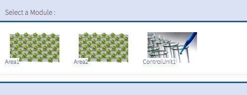

Choosing the ControlUnit1 icon we can observe the state of several sensors such as the pH and EC measurements:

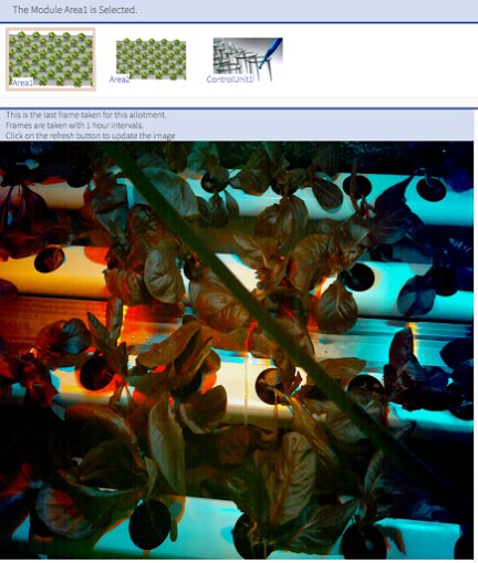

It is also possible to get the latest picture stored on our database (pictures are taken every hour):

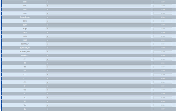

There is also a scheduler that allows to control solenoid valves, nutrient deployment or the lights manually (disabled for guest users). For each control command a value is stored on the database and pulled by the master of the desired farm:

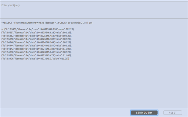

There is also a control panel dedicated to the user interaction with the database. It is possible to query for any variable, insert and update elements. Guest users are only allowed to query the database. A collection of brief demos are available on the webpage. After each query the results are shown as follows:
On the main page for any vertical farm, a summary of the events detected and a list of stats related to each sensor is shown, giving the user a better understanding of any problems or warnings that should be taken into account.
As stated earlier, the webpage provides a live stream of each sensor but each stream can encompass a limited number of measurements. To better understand the behavior of a specific variable, in the “Plotter” tab, the user can select any two dates and plot the values of any sensor:
