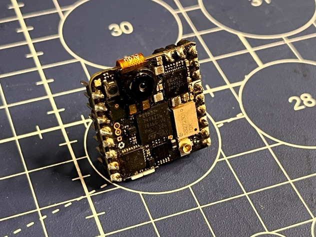

This little board packs a serious punch. It has a built-in camera, IMU, ToF sensor, Wifi, it has everything you need to make a drone! Milos decided to build a custom PCB that will work as a shield for the Arduino Nicla Vision and that will house the rest of the electronics to keep everything as compact as possible.

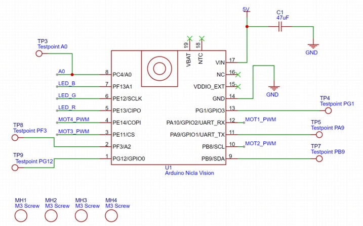

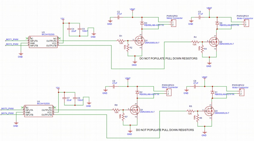

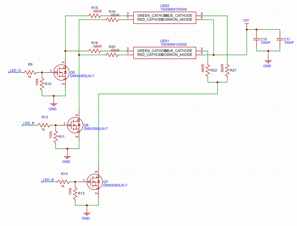

Schematics of Electronics

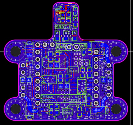

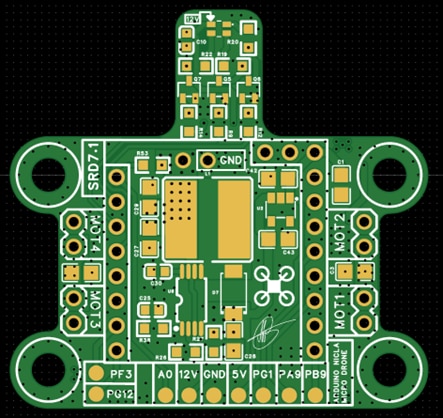

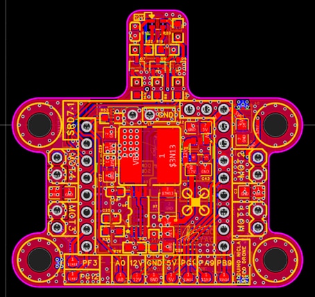

This is where the “fun” began for Milos as he explains in the video. For the first PCB he didn’t go thoroughly through the data sheet, and the pinout was wrong for the Nicla Vision, so while he was trying to make it work, he managed to burn the onboard battery regulator… This didn’t deter him, and he continued by designing a new PCB. While still not perfect, it was good enough for him to make it work! Here are the full schematics and the look of the final PCB.
The PCB was designed to be as small as possible with the Arduino taking the central position because of the IMU. Acting as a roll bar, he added a part of the PCB to stick out at the top, so it protects the delicate (and costly!) Arduino Nicla Vision in case of some crashes. This was also a perfect place for putting some LED-s that can be used to show the state the drone is in, for example, flashing green means it’s safe to touch, while flashing red means the drone is armed and could spin any of the motors up.

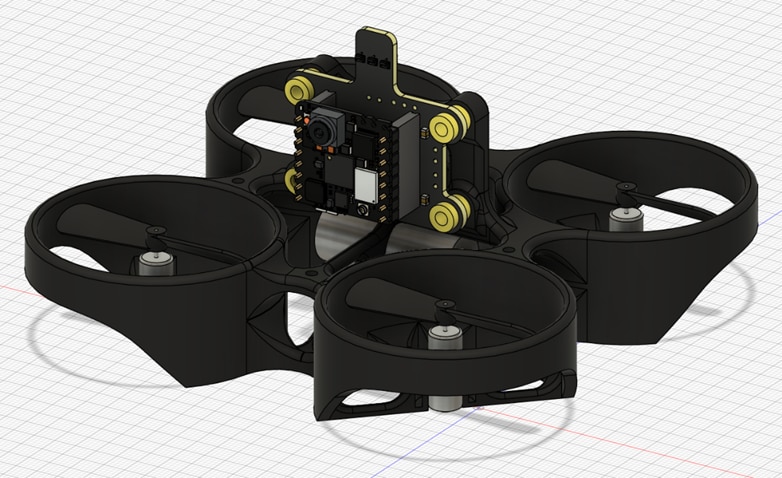

Mechanical design has taken a few attempts to get just right. He initially wanted to use small 717 motors, but they were too lacking in thrust, so he decided to instead go with the much more powerful 8520 motors, which are some motors used in the DJI Tello drone. These motors proved to be more than powerful enough for this drone. Nevertheless, Milos still tried keeping the drone as light as possible and he tried maximising that by designing the frame to be as tiny as possible while still being strong. Here are some of the designs he tried before settling on the final one.
For printing materials, he experimented both with PLA and PETG. PLA gives a stiffer frame but is more brittle and more likely to crack on impact. While PETG is a bit less stiff, it takes impacts incredibly well with less chance of something breaking. In the end, both materials proved to work rather well, so you can choose any, or experiment with something more exotic.

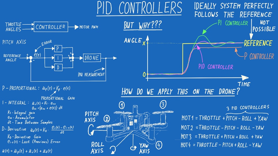

Since Milos wanted to do everything from zero and make this video as educational as possible, this included the flight controller software as well. There are a lot of open-source flight controllers that you can flash to an Arduino, such as MultiWii, but Milos wanted to try writing a bare bones controller from scratch. This meant he had to write 3 PID controllers for the Pitch, Roll & Yaw axis to stabilise the drone in flight. If you’re interested in more detail, he did a full explanation on how PID controllers work, and why they are necessary for the drone in the video.
