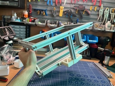

If there is one area where this project demanded the most effort, it was the mechanical design. Milos is candid about this, describing the mechanical side as “actually kind of complicated and a lot of work.” The challenge was to balance strength, accessibility, and flexibility.
The main chassis is constructed from standard 20×20 and 40×20 T-slot aluminum extrusions. These are fastened with machine screws to form a stiff, rectangular frame that resists twisting while remaining easy to modify. This choice was intentional: aluminum extrusions are widely available, easy to cut, and ideal for iterative projects.
Secondary structures, mounts, and brackets are 3D printed. PLA was used for this version, with the understanding that higher-performance materials such as PC or PA may replace it later, particularly for gears. This hybrid approach keeps the build approachable while still allowing custom geometry where needed.
To protect the motors from excessive radial loads, each wheel is mounted on its own axle made from an M8 bolt, supported by dual bearings. This design ensures that the bearings, rather than the motor shafts, absorb the mechanical stress. It also makes maintenance easier, since bearings are inexpensive and simple to replace.

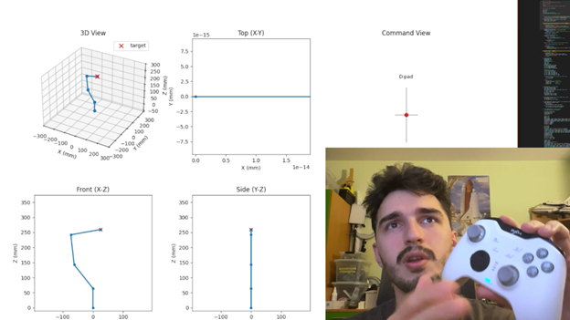

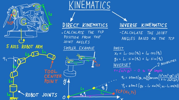

The arm control is where the project becomes significantly more advanced. Instead of commanding individual joints, the software implements both direct and inverse kinematics. Milos explains the motivation clearly: “If we want the robot arm to reach this point… how do we actually even know where the end effector is located? That’s called kinematics in robotics.”
Direct kinematics calculates the position of the tool center point (TCP) from known joint angles and link lengths. Inverse kinematics does the opposite, solving for joint angles that will place the TCP at a desired coordinate. Even for a simple planar arm, Milos demonstrates that inverse kinematics quickly becomes mathematically heavy, with multiple valid solutions such as elbow-up and elbow-down configurations.
Rather than reinventing the wheel, the software uses established solving techniques and provides flexibility in how solutions are chosen. Link lengths, joint limits, and servo pulse ranges are explicitly defined in code, ensuring that the mathematical model matches the physical hardware. Calibration data is stored in a JSON file, allowing the arm to be zeroed accurately after assembly. As Milos emphasizes, improper calibration “will just add up and there is just a function to actually calibrate the arm so you tell it where the actual zero position is.”
To make development safer and more intuitive, a visualization script simulates the arm’s motion in real time. This allows kinematic behavior to be inspected before applying commands to the real hardware, and it highlights issues such as jitter and singularities that will eventually need path planning to resolve.

Before running movements on the real hardware, the same kinematic logic is also used in a visualisation tool. This renders the arm’s motion on screen and makes it easier to spot unreachable targets, singularities, or jitter in the solution. Some uneven motion remains, particularly near the limits of reach, which Milos notes is expected without additional path planning. At this stage, the focus is on correctness and clarity rather than perfectly smooth trajectories.
