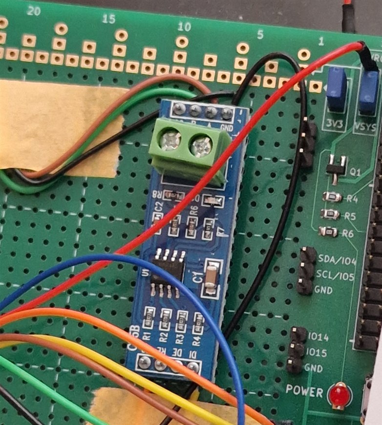

    Another benefit of large boards is that they can house a lot of project : ) That trainer board's breadboard area could be used to carry a PCB or stripboard or perfboard etc, just placed or pushed on top. I do the same thing on the Pico board.
    I was experimenting with audio in the photo here. Since this amplifier board needed 12V, I could take that power from the screw terminals visible at the right side of the photo, powering everything from the single barrel connector.
    I don't use many MikroE Click boards, but I needed one here, so I prototyped a Click adapter to plug on top. Actually normal stripboard/perfboard can be plugged on, but I had a few older revision Pico Eurocard boards so I cut one in half to plug on top here. Might as well reuse scrap boards if possible:

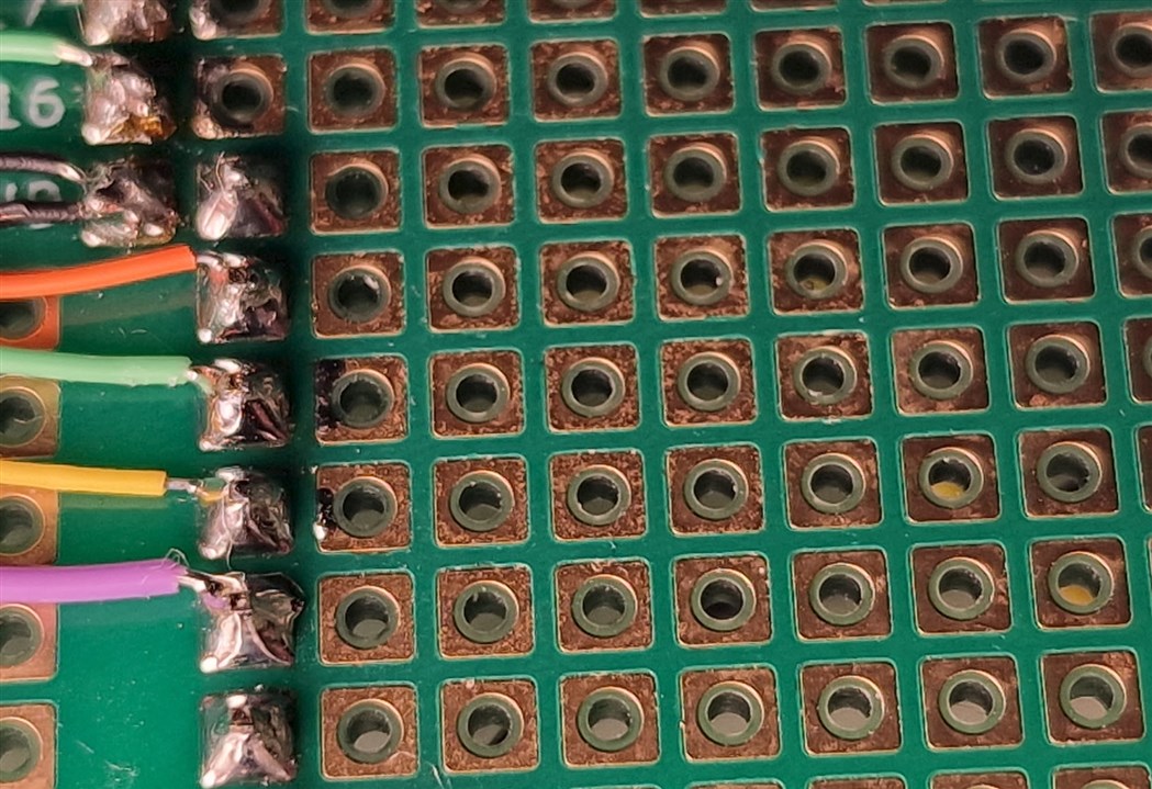

    Soldered parts on the main area:
    The parts are really easy to desolder (so that the board can be reused many times)  because of this; there's a gap between the holes and the pads:
    Incidentally, 30 AWG wire is always handy to have on hand for creating projects/fixing circuit board problems etc.
