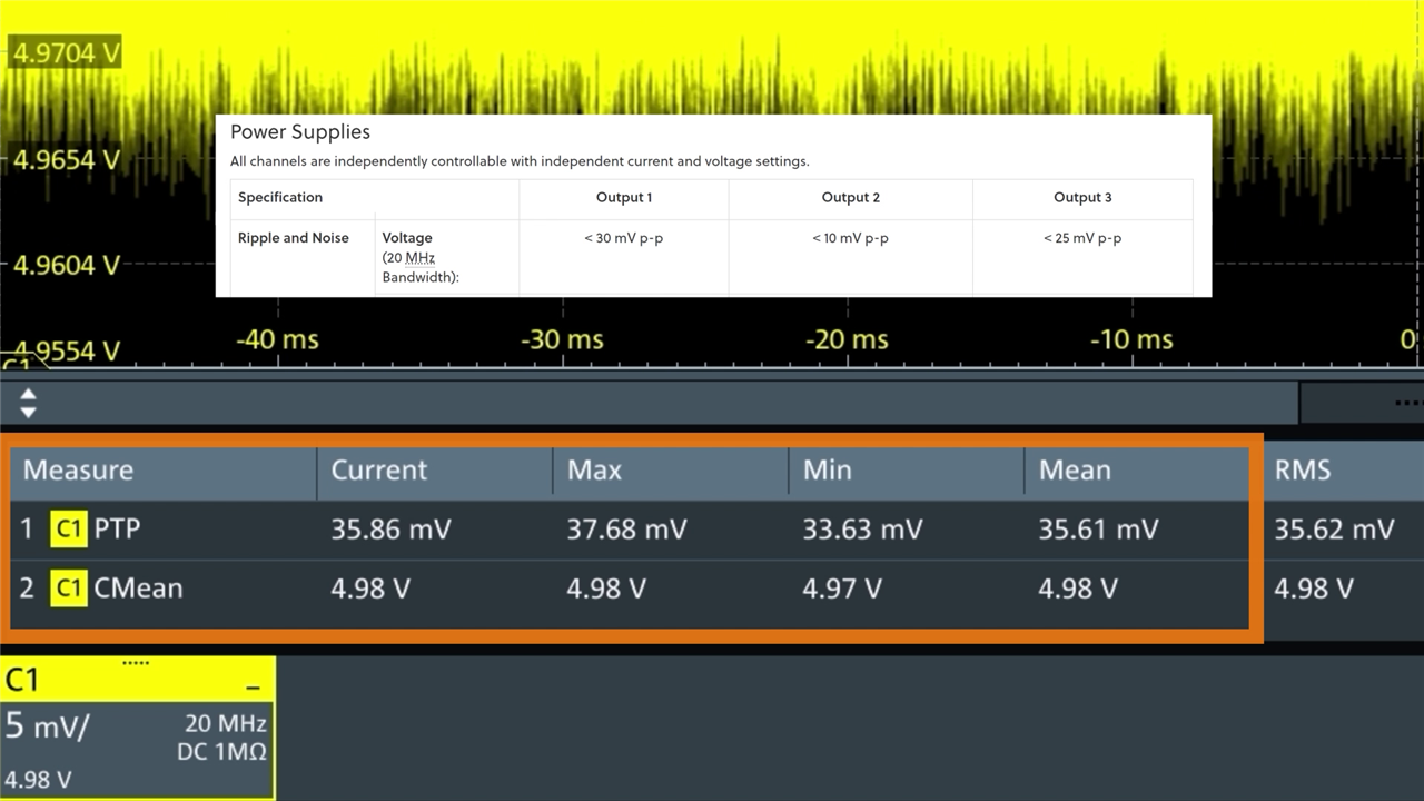

After going through the basic features, James measures its performance, starting with the peak-to-peak noise. You might also know this noise as ripple voltage or periodic and random deviations (PARD). It is how much the output varies from the nominal DC value.
For this test, James started with a 470 (well 466) ohm resistor connected directly to channel 1’s output. At 5 volts, this should draw 10.7 milliamps. Even though the oscilloscope had a 20 MHz filter enabled, the result was a peak-to-peak voltage of about 35 millivolts, slightly higher than the specification from Digilent.

James also tested the positive 15V supply and found that at 15 volt, 490 milliamps, the output was relatively clean with a ripple of 50 millivolts peak-to-peak. Again, the values came out higher than Diglent’s specification.
But there are a couple of reasons why the measurements James made are a little high.
First he used the dreaded hook and ground wire on the scope probe for all of the captures. These are not ideal and can add some noise. Off-camera, James found using the (much better) ground-spring instead dropped all the measurements a few millivolts. (Check out the Workbench Wednesdays episode on Oscilloscope Grounds  to learn why.)
The next reason is that James used a 10:1 probe. These probes divide the signal by a factor of 10, meaning the oscilloscope must amplify the signal, which adds some noise. So why use a 10:1 probe when 1:1 probes do not have this issue? Well, switchable probes, like the ones used in this video, only get 5-7 MHz of bandwidth in the 1:1 setting. And power supply measurements are typically done up to 20 MHz.
Last, another reason is that any time you measure ripple with an electronic load, it will contribute significant noise. This reason is probably why the high-current tests showed significantly more ripple than the low-current tests with resistors.
In short, while his measurements exceeded Digilent’s specifications, James does not doubt their datasheet (in this case.) There is enough grey area in how the measurements are defined and performed to explain the differences.

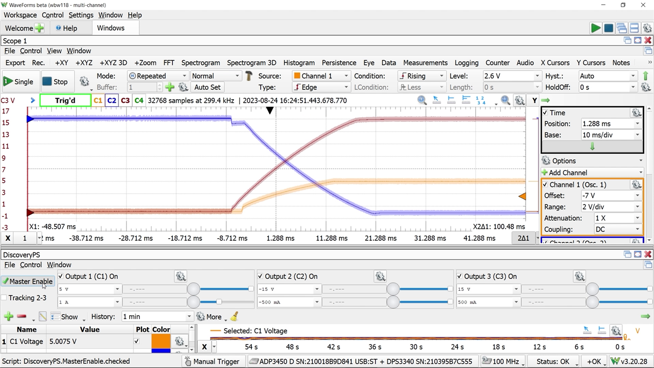

When using multiple output channels simultaneously, it is crucial to know the delay at which those channels turn on. For example, an FPGA circuit may need one rail to be stable before another. So, for the next test, James combined and connected all three channels to inputs on the Analog Discovery Pro with a banana-to-BNC adapter.
This test is an excellent example of the integration Waveforms provides. A single window contains the oscilloscope plot and the controls for the ADP3340. The plot shows that channels 2 and 3 turn off very close to each other and a few milliseconds before channel 1. James did find that adjusting the current limits could skew those results a little, but the order was usually the same.
