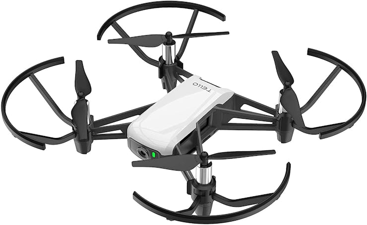

The DJI Tello is a small-sized drone that combines powerful technology from DJI and Intel into a very tiny package. It is a lightweight, fun, and easy-to-use drone that is the perfect tool for learning the ropes of drone piloting before investing in a more expensive option. Tello boasts a 14-core processor from Intel that includes an onboard Movidius Myriad 2 VPU (Video Processing Unit) for advanced imaging and vision processing. It is equipped with a high-quality image processor, for shooting photos and videos. The camera features 5MP (2592x1936) photos and HD720 videos. The drone has a maximum flight time of 13 minutes. This incredibly small drone fits in your palm and only weighs approximately 80g (propellers and battery included). You can control Tello directly via the Tello app or with a supported Bluetooth remote controller connected to the Tello app. The drone is programmable via Python, C++, Scratch, and DroneBlocks.
DJI Ryze Tello
DJI Ryze Tello
Specs
  • Weight: Approximately 80 g (with propellers and battery)
  • Dimensions: 98mm*92.5mm*41mm
  • Propeller: 3 inch
  • Built-In Functions: Range Finder, Barometer, LED, Vision System, WIFI 802.11n 2.4G, 720P Live View
  • Port: Micro USB Charging Port
  • Max Flight Distance: 100m
  • Max Speed: 8m/s
  • Max Flight Time: 13min
  • Detachable Battery: 1.1Ah/3.8V
  • Photo: 5MP (2592×1936)
  • FOV: 82.6°
  • Video: HD720P30
  • Format: JPG(Photo); MP4(Video)
  • Electronic Image Stabilization: Yes
