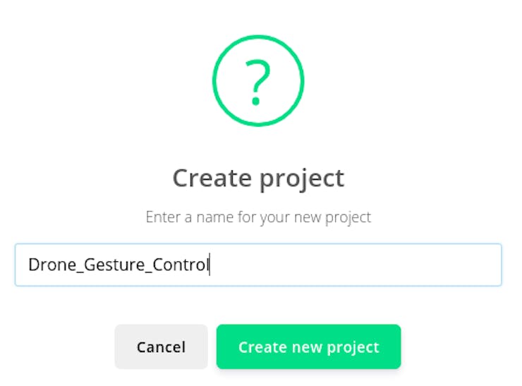

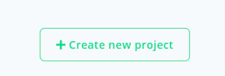

  • Log in to https://www.edgeimpulse.com/
  • Click Create Project.
  • Give Project name and click Create.

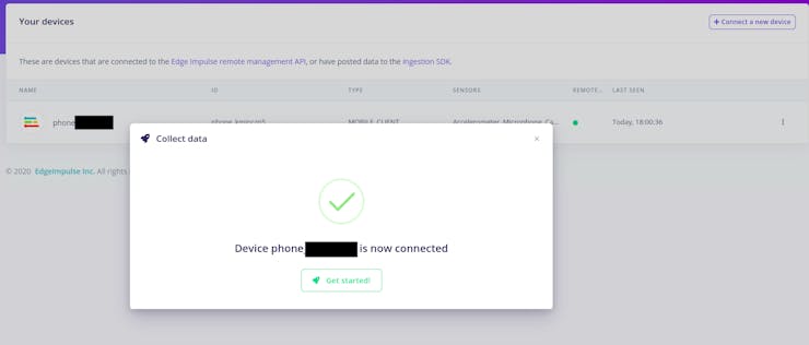

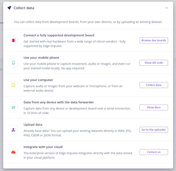

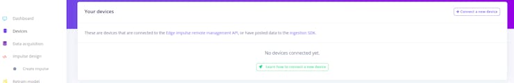

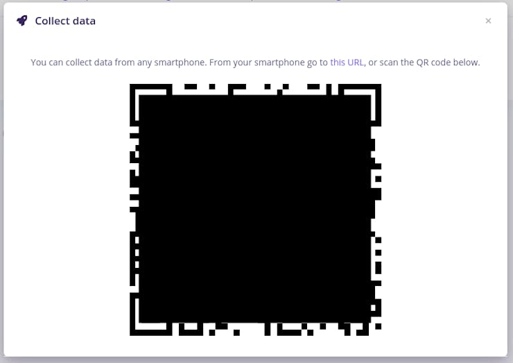

  • Head over to the "Devices" tab from the left menu and choose "Connect a new device".
  • You will be greeted with a variety of device options.

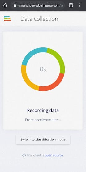

  • To make things simple, let's connect our smartphone device. Since all modern smartphones have onboard accelerometers, it will be easy-peasy.

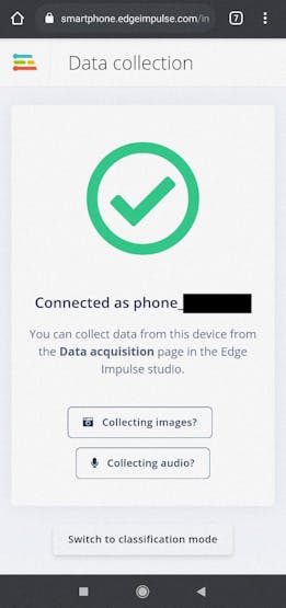

  • Next, you will be given a QR code and a link to allow the collection of data from your smartphone.
  • Scan this QR code or open the link via your smartphone device.
  • Once the link is opened via your smartphone, the smartphone will show up in the "Devices" section.

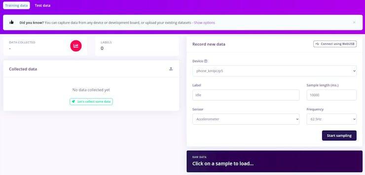

Data collection
For collecting the data for our machine learning model, we will use the 3-axis accelerometer sensor present onboard our smartphone.

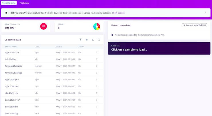

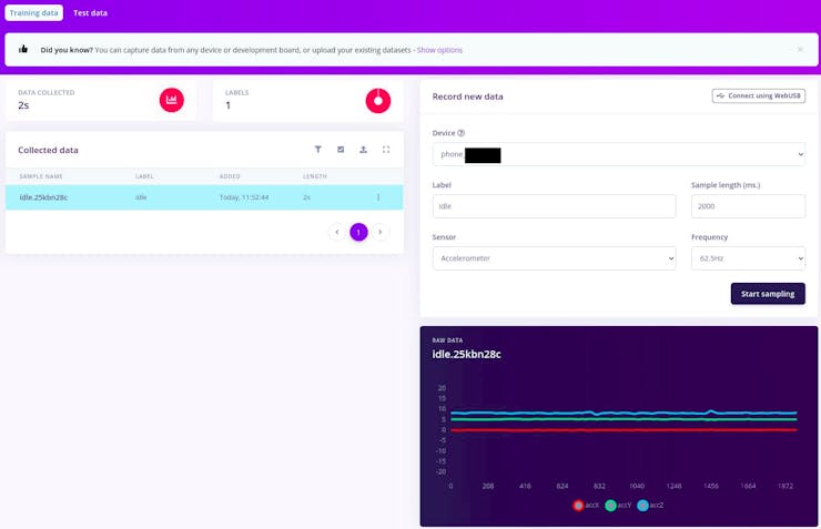

  • Once the smartphone is connected to Edge Impulse, head over to the "Data Acquisition" tab.
Select our phone from the device, give labels (let's start with 'idle'), Sample length of 10000 (10s), Sensor as accelerometer, and a Frequency of 62.5Hz.
  • Click on "Start Sampling" to begin sampling for the set sample length.
  • In about two seconds the device should complete sampling and upload the file back to Edge Impulse. Once sampled, the data will appear in the data acquisition.

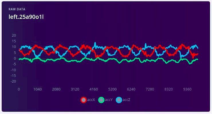

  • You see a new line appear under 'Collected data' in the studio.

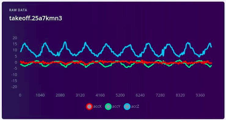

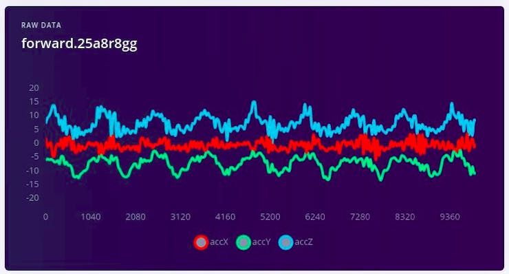

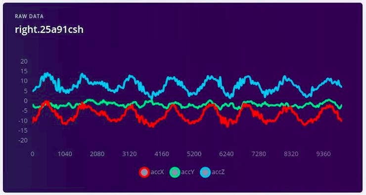

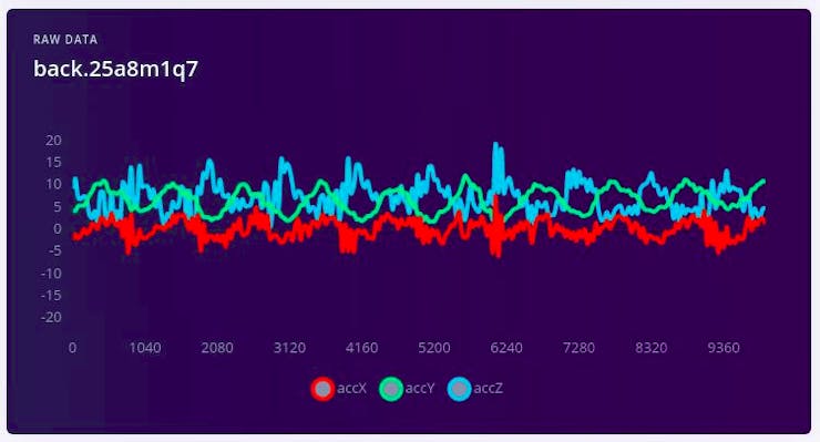

  • When you click it you now see the raw data graphed out. As the accelerometer on the development board has three axes you'll notice three different lines, one for each axis.
  • Repeat this process to collect as many samples as we can.
  • Repeat for the other labels takeoff/land, forward, back, left, and right.
  • Make sure to perform variations on the motions. E.g. do both slow and fast movements and slightly vary the orientation of the board. You'll never know how your user will use the device.
  • Once sufficient data is collected, they will be shown under the same tab.
  • Click on each data row to view their raw value graph for 10s sample length.

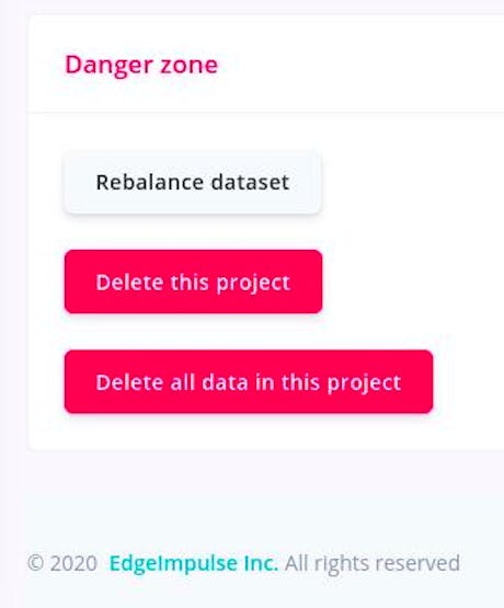

  • Now that we have sufficient data, we need to split the data into a training dataset and a test dataset.
  • Don't worry. The Edge Impulse Studio makes that easy for us too.
  • Head over to the "Dashboard section" and scroll down to the "Danger Zone".
  • Click in "Rebalance datasheet" to automatically split the dataset into training and test with a ratio of 80/20.
  • Now we have acquired and set up our training data for further processing.

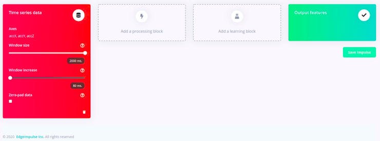

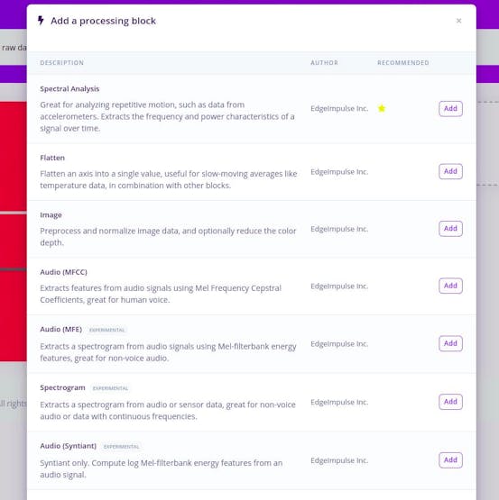

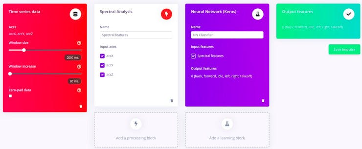

  • Head over to the "Impulse Design" tab.
  • We will already have the Time series data section populated for us.
  • Select a window size of 2000 (2s) and a window increase of 80ms.
  • Now click Add a processing block and select Spectral Analysis.
  • The parameters will be auto-populated for us.
  • This block applies a filter, performs spectral analysis on the signal, and extracts frequency and spectral power data.

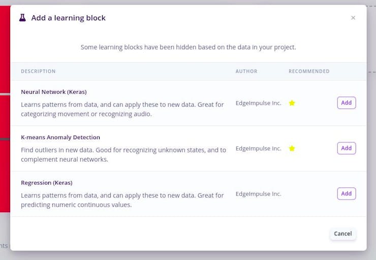

  • Now click Add a learning block and select Neural Network (Keras).
  • This block takes these spectral features and learns to distinguish between the six (idle, takeoff, forward, back, left, right) classes.
  • The Output features block will have all the labels that we have acquired.
  • Now click on Save Impulse to save the configuration.

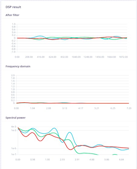

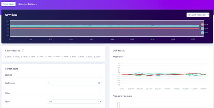

  • Head over to the Spectral Features tab.
  • This will show you the raw data on top of the screen (you can select other files via the drop-down menu), and the results of the signal processing through graphs on the right.
  • For the spectral features block you'll see the following graphs:
After filter - the signal after applying a low-pass filter. This will remove noise.
Frequency domain - the frequency at which signal is repeating (e.g. making one wave movement per second will show a peak at 1 Hz).
Spectral power - the amount of power that went into the signal at each frequency.
  • A good signal processing block will yield similar results for similar data. If you move the sliding window (on the raw data graph) around, the graphs should remain similar.
  • Also, when we switch to another file with the same label, you should see similar graphs, even if the orientation of the device was different.

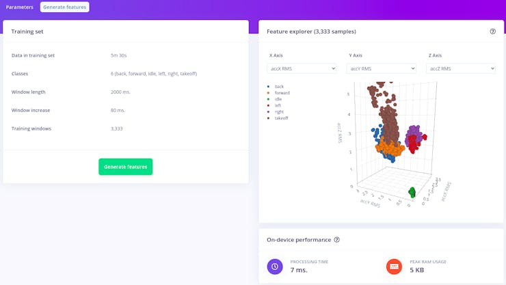

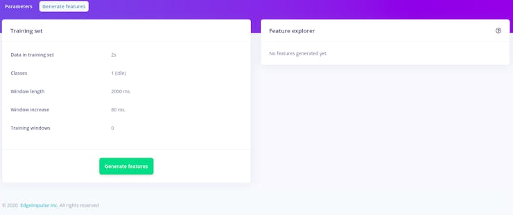

  • Click Save parameters. This will send you to the Feature generation screen.
  • Here we will split all raw data up in windows (based on the window size and the window increase selected in creating impulse step) and apply the spectral features block on all these windows.

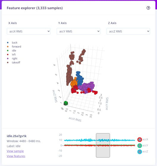

  • Click Generate features.
  • The Feature explorer will load. This is a plot of all the extracted features against all the generated windows.
  • You can use this graph to compare your complete data set. E.g. by plotting the height of the first peak on the X-axis against the spectral power between 0.5 Hz and 1 Hz on the Y-axis.
  • A good rule of thumb is that if you can visually separate the data on a number of axes, then the machine learning model will be able to do so as well.
  • For our dataset, the feature data are more or less separated which is a good sign. In case your features are overlapping, it is better to acquire more data.

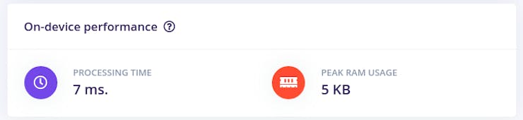

  • The page also shows the expected on-device performance with processing time and peak RAM usage for calculating features.

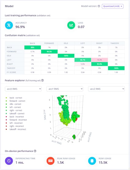

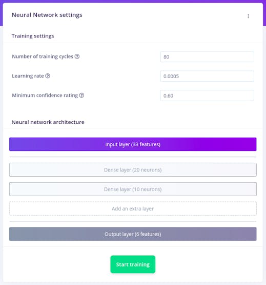

  • Head over to the NN classifier tab.
  • Set Number of training cycles to 80, Learning rate to 0.0005, and Minimum confidence rating to 0.60. You can play around with these values to adjust the accuracy of the trained model.
  • Leave the other parameters default for now and click Start training.
  • Now the Training Output section gets populated.
  • It displays the accuracy of the network and a confusion matrix. This matrix shows when the network made correct and incorrect decisions. You see that idle and takeoff are relatively easy to predict.
  • It also shows the expected On-device performance for this model.

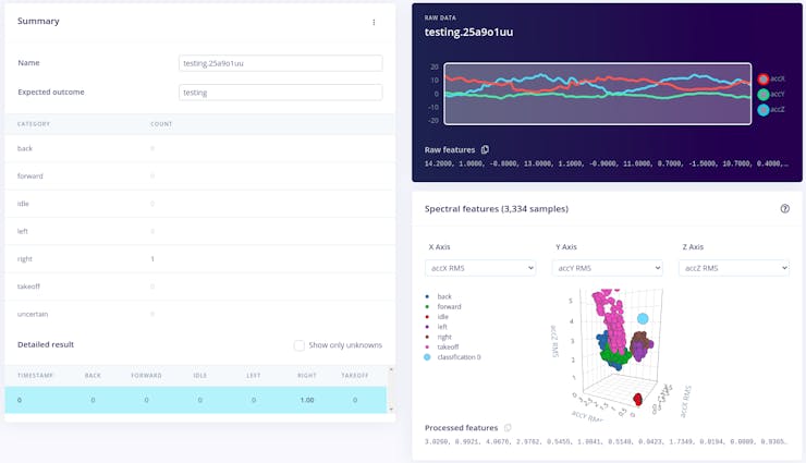

  • Head over to the Model Testing tab.

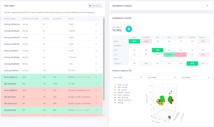

We can see our training dataset here. Click Classify all.
  • This will generate the model validation outcome using the training data that was unknown to the model. We can see that our trained model was able to classify with an accuracy of 74.70% which is quite good considering the small amount of training data fed to the model in the training section.
  • It also shows which labels were incorrectly predicted.
  • By checking these results in Feature explorer, we can understand which labels were misclassified and use more training data to re-train our model for better classification of those data.
  • You can also do a live classification of data from the smartphone from the Live classification tab. Your device should show as online under Classify new data. Set the 'Sample length' to 2000 (2 seconds), click Start sampling, and start doing movements.
  • Afterward, you'll get a full report on what the network thought that you did.

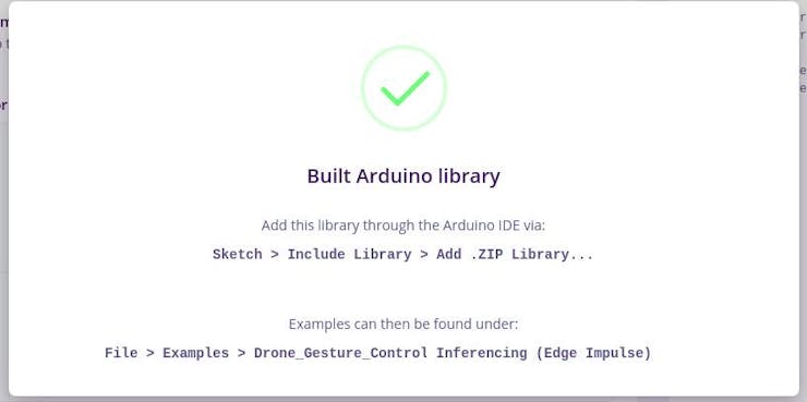

With the impulse designed, trained, and verified you can deploy this model back to your device. This makes the model run without an internet connection, minimizes latency, and runs with minimum power consumption. Edge Impulse can package up the complete impulse - including the signal processing code, neural network weights, and classification code - up in a single C++ library that you can include in your embedded software.
  • Head over to the Deployment tab.
  • Select Arduino library.
  • If you need the build for a specific Edge Impulse supported hardware, under Build firmware select your development board
  • Click Build. This will export the impulse, and build a library that will run on the development board in a single step.
  • We will see a pop-up with text and video instructions on how to deploy the model to our device.
  • After the build is completed you'll get prompted to download the library zip file.
  • Save the zip file to our project directory.
