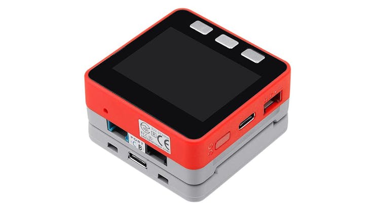

M5Stack Fire Module
M5Stack FIRE is one of the M5Stack developing kits, providing 9-Axis IMU sensor(6-Axis posture acceleration measurement + 3-Axis magnetic measurement), 16M Flash + 4M PSRAM, enhanced Base, larger battery, etc. With an IMU posture sensor, there are a lot of situations to which you can apply this kit, like detecting acceleration, angulation, and trajectory. You can make relative products like sports data collectors, 3D remote gesture controllers, etc. It is a modular, stackable, scalable, and portable device is powered with an ESP-32 core, which makes it open-source, low cost, full-function, and easy for developers to handle new product development on all stages include circuit design, PCB design, software, mold design, and production.
M5Stack FIRE Development Kit

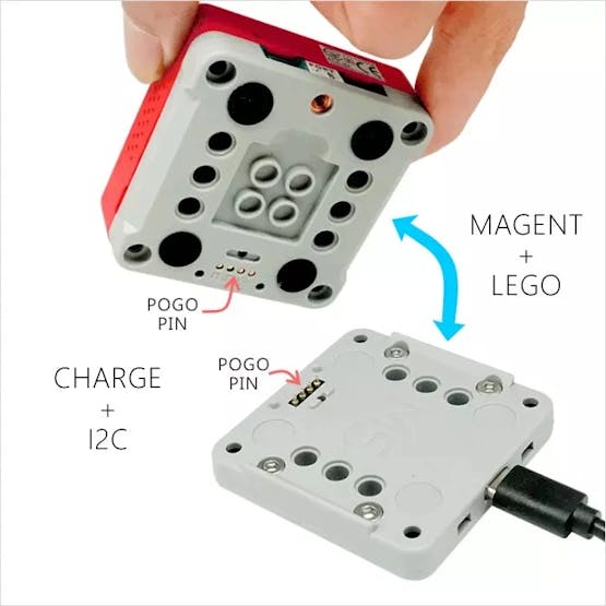

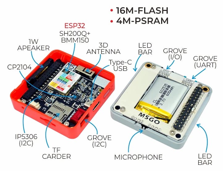

M5Stack Fire comes with three separable parts. The top part has the processors, chips, sockets, 2.4G antenna, ESP32, power management IC, an LCD screen, and some other interface components.
M5Stack FIRE Components
The middle part is called the M5GO base which provides a lithium battery, M-BUS socket, LED bar, and three more GROVE Ports. The bottom part is a charge table, which can be connected to the M5GO base via POGO pins.
M5Stack FIRE Stack
M5Stack FIRE Stack

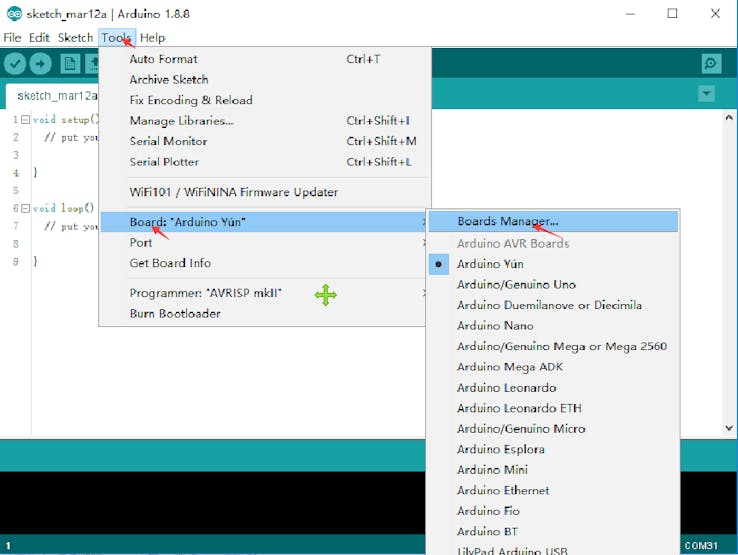

Install ESP32 Boards Manager

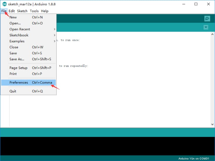

  • Open up the Arduino IDE, and navigate to File -> Preferences -> Settings

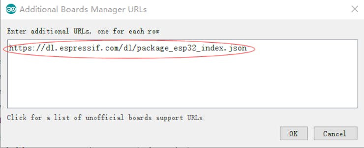

  • Add the following ESP32 Boards Manager URL to Additional Boards Manager: https://dl.espressif.com/dl/package_esp32_index.json
  • Hit OK

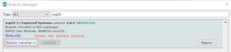

  • Navigate to Tools -> Board: -> Boards Manager
  • Search ESP32 in the Boards Manager window, and click Install

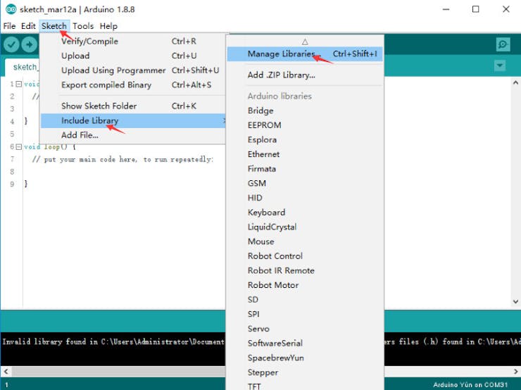

Install M5Stack Library

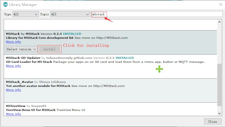

  • Open Arduino IDE, then Select Sketch->Include Library->Manage Libraries
  • Search M5Stack and install it

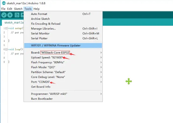

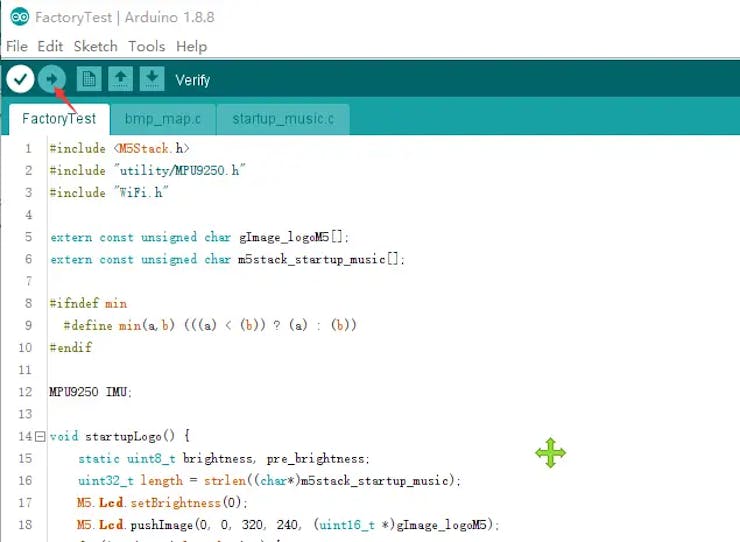

  • Choose the correct board, baud rate, and serial port.

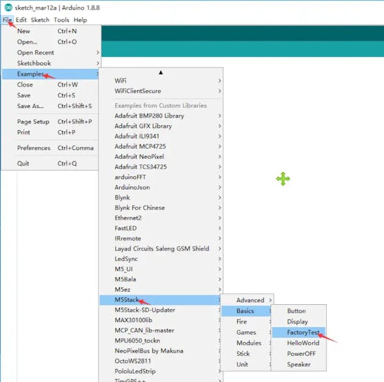

  • Once set up, you can try an example sketch to verify if everything is working.
  • Click Upload, to flash the code to the device
  • Once successfully flashed, the M5Stack module will show the corresponding output on its display as well as Arduino Serial Monitor.
