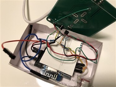

The last step was to hide the electronics from the trees in a semi-festive manner.

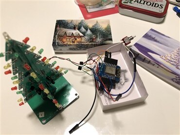

Using the little paper box imitations of Altoids tins that I created in my previous blog post, I was able to tuck all the pieces away nicely and create a little stand for the trees at the same time. The Christmas card box material added a bit of a festive touch.
This is where we left off in the previous blog post. The boxes showed great promise of being able to fit all the pieces:
Using a small hole punch I added a hole to fit the button, and firmly taped it into place.
I also added a hole to pass the USB power cable.
And near the top I added a small hole to pass the wires to the Christmas tree.
All the wires and bits fit quite nicely. I added another piece or card to make sure the wires wouldn't short out against the Wemos board.
As you may recall from a previous blog post, I did also have nail polish covering all the exposed solder joints.

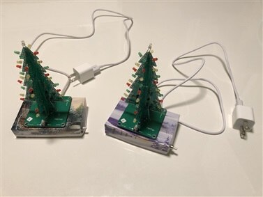

The end result turned out nicer than I had imagined! Yay me!
I used iPhone chargers to power the trees. These are actual Apple chargers that provide a true 1Amp (the knock-offs tend to only handle about 600mA, I've noticed).

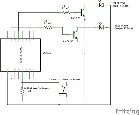

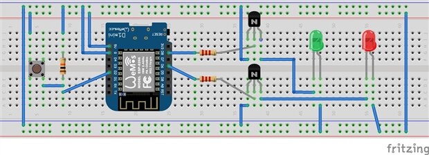

I took a moment to draw out the schematics. My earlier sketch was, well, rather sketchy...
I've added the fritzing file to my github folder too.
