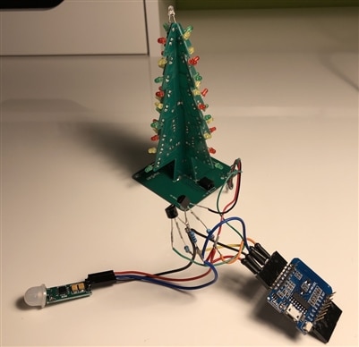

Here is one of the trees:

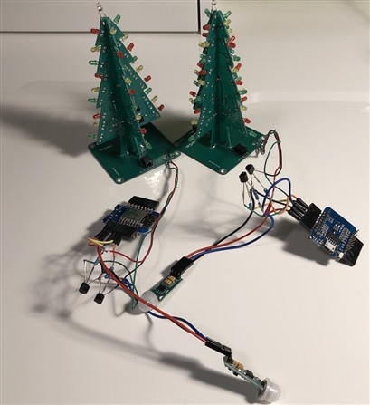

Here are the two trees, both wired up to a Wemos, ready to be programmed:

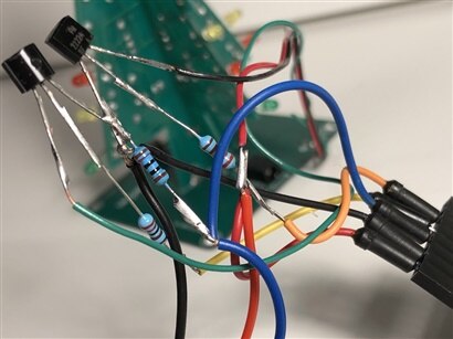

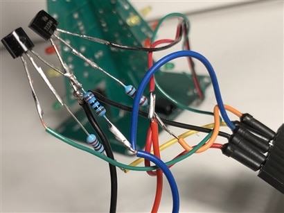

And here is a closeup of the wires for one of them. I don't recall which is which, sorry:
It would have been much neater to have used perfboard, I think. For some reason the number of required connections expanded as I went on image

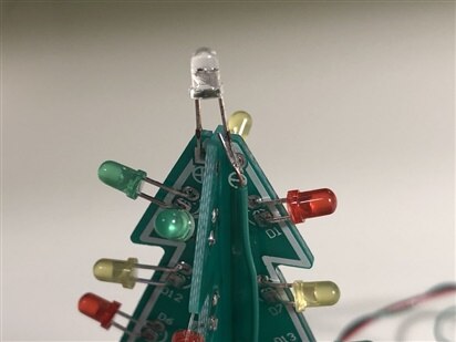

Here is a closeup of the green wire to the top RGB flasher LED:
The wire runs straight down the center of the tree and to the transistor, controlled by the Wemos board. I separated this from the other tree LEDs because I wanted something local to signal that motion had been detected. It is also timed so that it stays on as long as the remote tree is on.
Note that the transistors are on the gnd side of the load, which is why the green wire is soldered to the - side of the LED. I think it would have been fine, and much easier, to have skipped the transistor for the tree-top LED and just powered it straight from the GPIO pin.

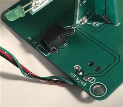

This is how I wired the main tree. Basically the power to the tree is now supplied by the Wemos board. I did confuse myself for both boards at different times when I forgot to turn on the power switch. sigh. This was the easiest way to power it though - I suppose I could have wired it directly to the + and - at the base of the tree. I get a little reckless with the soldering iron at times - notice the melty bit on the J1 power connector? image
I keep thinking there might have been a nicer way to wire it, maybe having the main-tree transistor glued to the tree base plate and just running power and signal to it from the micro controller board.
