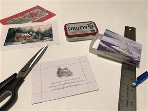

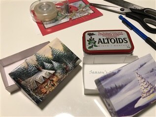

Tools and Materials:
* 1 Christmas card to make 1 box
* Clear tape or glue
* Scissors
* Ruler
* Pencil

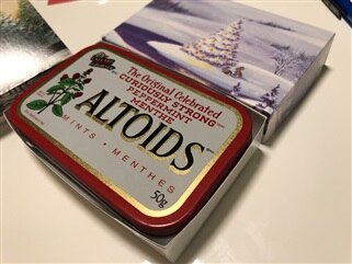

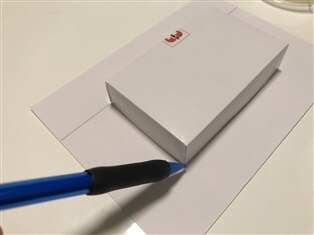

Step 1: Cut the card in half. We'll use the pretty front of the card for the box lid, and the back for the bottom box.

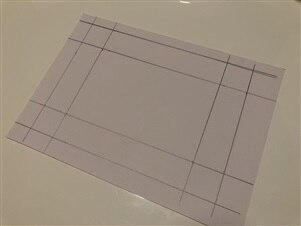

Step 2: Size the bottom box on the back side of the card. I used an Altoids tin, as that size looks about right for my project.
Step 3: Draw the outlines. The inside lines are the size of the box, so I simply drew around the tin.
I then drew a box, 3/4" bigger on each side, around the outside to make the sides, which will be 3/4" tall.
Step 4: Cut away everything outside of that 3/4" outline

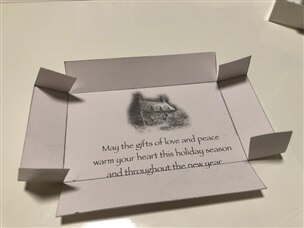

Step 5: Snip the bottom corners on one of the lines of each corner only (see the next pictures for more clarity)
Step 6: Pre-fold on all the lines

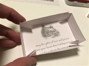

Step 7: Fold the sides up and together
Step 8: Tape the corners

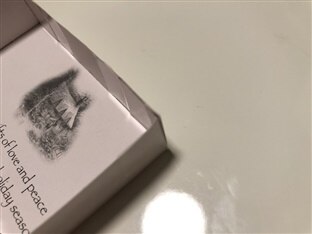

Step 9: Make the lid slightly bigger so it's easy to put on and take off. I used the bottom box and marked slightly bigger around it.
Step 10: Repeat steps 3 through 8 to finish the lid. (or is that 6 steps?)
Step 11: Admire the finished Merry Boxes!

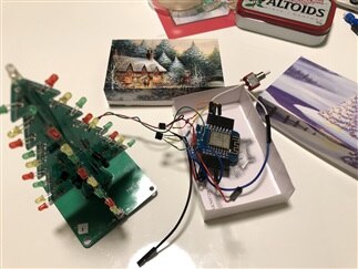

The Altoids tin fits!
(You know, in case you want to pretty up an Altoids tin project)
The electronics of my Connected Xmas Trees project will need a little bit of careful placement, but it should work.
The resulting boxes aren't Altoids-tin strong, but should be enough to hold the tree securely.
