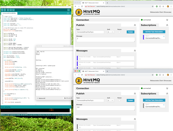

I made some headway today, and was able to wire up one of the XMas trees to one of the Wemos boards.
Initial testing went well - it looks like the lights are properly controlled the way I had intended (hooray!).
However, the motion sensor is not doing the right thing yet, so I'll have to work on that.
edit: I think I might have found the issue (will test tomorrow) - line 77 sets the motion sensor input as "INPUT_PULLUP" like a regular button, but the PIR module should already handle that, so it probably should just be "INPUT". edit again: Sadly that wasn't the problem. I'll test it separately later.

I made a little video showing my progress so far.
I'm using a Witty Wifi as the other tree. pressing the button simulates the motion detected, and the different LEDs simulate the tree.
Sorry about the video, I took it in portrait mode LIKE A BARBARIAN! (no offence intended to barbarians).
Here is a screenshot that shows the online MQTT client I also used for testing. It's super handy for this kind of thing!
You can see the debug info in the serial console too.
Since it looks like the software is ok for the most part (it may need a tweak for the motion detector), I've published it on GitHub, including the version that runs on the Witty for testing.
https://github.com/ntewinkel/electronics/tree/master/ConnectedXMasTrees

    mcb1 over 7 years ago +2
    ntewinkel Not that the english is particularilyt good, but it looks like the output goes high when it is triggered. Many of them have an open collector so they go low when triggered. The PCB has the option…

    ntewinkel over 7 years ago in reply to mcb1
    Hi Mark,
    It turned out that I needed an external 10k pull-down (to ground) resistor.  (edit: I think that's a Wemos/ESP8266 limitation, where a Uno might be ok with internal pull-down)
    That seems to make it work reliably enough, although it does appear to get the occasional false trigger still. So that might not be the right value of resistor, but it's good enough for now. False triggers add more festiveness!!
    I noticed that optional transistor spot, which some datasheets seem to recommend to use to directly control a load from the control pin, instead of having that transistor externally.
    ntewinkel
    The PCB has the option to add a transistor, and they seem to have a zero ohm feeding the output instead.
