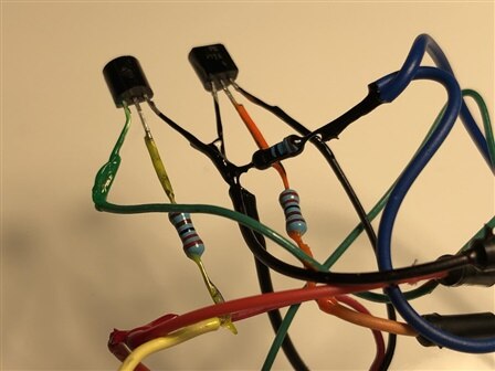

Here's a picture of the solder joints with dollar-store nail polish protecting the joins. I ended up buying a pack just for the red and green in it, and it turns out the rainbow of colours works well here!

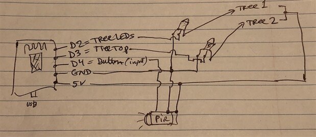

Here is a quick sketch of the schematic that I used to keep things straight in my mind while soldering. The input pins have since changed a little (pls see the source code for the updated numbers).
Note that in this sketch "Tree 1" and "Tree 2" refers to the two wires going to the trees, not to separate trees. I probably should have written it more clearly, like "Main Tree" and "Tree top LED". The transistors are basic NPN 2N2222a.
