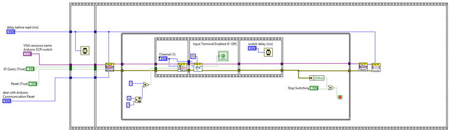

The LabVIEW process
You'll recognise the controls of the dashboard above as inputs and outputs in the workflow. You'll also see the driver blocks made for this instrument.
The left side shows the initialisation parameters for the device, such as COM port, do you want to reset the status at the start, how long the device should wait by default between sending a SCPI command and reading the reply from the Arduino.
Then the initialize block is called. It establishes the serial communication and, because we asked it, resets the status.
The remainder is a loop, with 3 activities on each run: set the status, read and show the status, wait for a given time.
The loop runs until the STOP button is pushed or an error happens (e.g. the device stops replying, USB cable removed).
The loop counter is used to toggle the status between ON and OFF. If the counter is even, we turn the switch OFF. If it's uneven, the switch is set on.
The above construct is used for this. It's a modulus 2 calculation. i is the loop counter and given as the numerator, and the constant 2 is given as the denominator.
The remainder is then compared for equality to 1.  The result of that comparison is a boolean, true when the remainder is 1, else false.
Because the Channel, Switch Delay and LED controls are inside the loop, they are polled and set at each loop cycle.
That's why you can change the channel and switching speed at runtime, and the status change is reflected at each cycle.
This is different than the controls for the initial setup. They are placed outside of the loop. They are read once when the flow is started.
When the STOP button is clicked, the loop exits. The closing part of the flow is now run.
I placed a reset block to take care that both relays are switched off. Then the communication link with the Arduino is closed.
