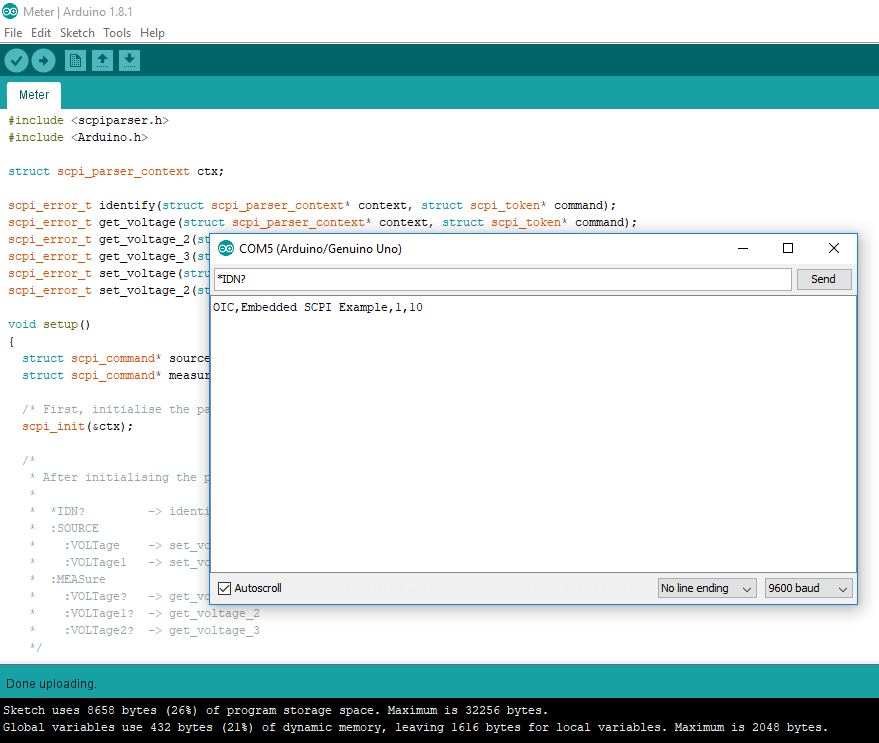

Test the SCPI Library
There are two examples in the SCPI lib. We're using Meter.ino.
Open the example in the Arduino GUI (File -> Open, then navigate to the place where you extracted the GIT archive and open src/Examples/Meter/Meter.ino).
Connect your UNO, select Tools -> Board -> Arduino/Genuino UNO.
Select Tools -> Port -> <the COM port of your Arduino>.
Select Sketch -> Upload.
Your Arduino is now programmed with the Meter example and the SCPI lib.

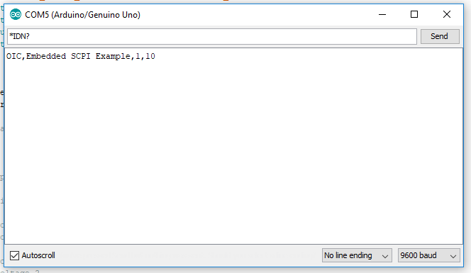

To test the basic setup, open the serial monitor:
Tools -> Serial Monitor
Enter the SCPI command *IDN? and press Send.
The monitor should log the result: OIC,Embedded SCPI Example,1,10.
