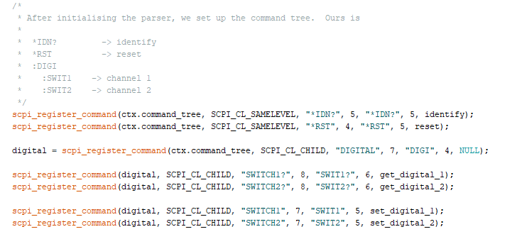

  /* First, initialise the parser. */
  scpi_init(&ctx);
   * After initialising the parser, we set up the command tree.  Ours is
   *  *IDN?         -> identify
   *  *RST          -> reset
   *  :DIGI
   *    :SWIT1    -> channel 1
   *    :SWIT2    -> channel 2
  scpi_register_command(ctx.command_tree, SCPI_CL_SAMELEVEL, "*IDN?", 5, "*IDN?", 5, identify);
  scpi_register_command(ctx.command_tree, SCPI_CL_SAMELEVEL, "*RST", 4, "*RST", 4, reset);
  scpi_register_command(ctx.command_tree, SCPI_CL_SAMELEVEL, "*CLS", 4, "*CLS", 4, reset);
  digital = scpi_register_command(ctx.command_tree, SCPI_CL_CHILD, "DIGITAL", 7, "DIGI", 4, NULL);
  scpi_register_command(digital, SCPI_CL_CHILD, "SWITCH1?", 8, "SWIT1?", 6, get_digital_1);
  scpi_register_command(digital, SCPI_CL_CHILD, "SWITCH2?", 8, "SWIT2?", 6, get_digital_2);
  scpi_register_command(digital, SCPI_CL_CHILD, "SWITCH1", 7, "SWIT1", 5, set_digital_1);
  scpi_register_command(digital, SCPI_CL_CHILD, "SWITCH2", 7, "SWIT2", 5, set_digital_2);

It isn't difficult to trace the SCPI commands back to the firmware functions. Not a lot is happening here.
Please check the code. If there's a construct that you have questions about, post a comment and I'll elaborate.
