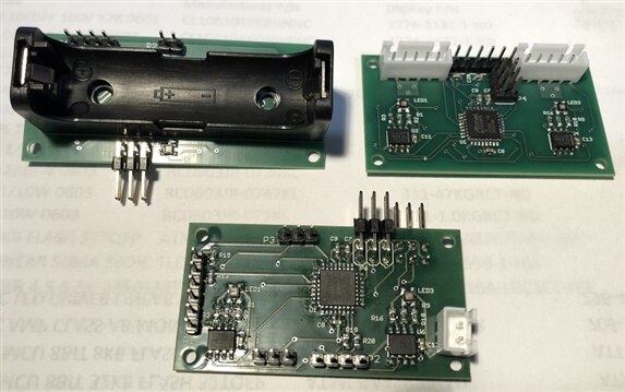

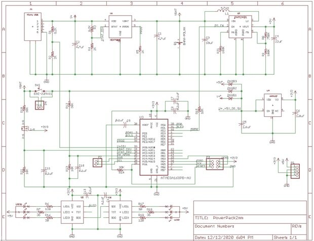

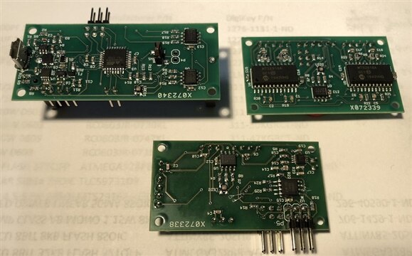

I was very concerned as time ran down and my boards had not yet arrived.  Late Saturday afternoon (12/12), the boards finally showed up.  I jumped right in, finishing a few design details (schematic and BOM) and moved on to assembly.  Here are some shots of the finished boards:

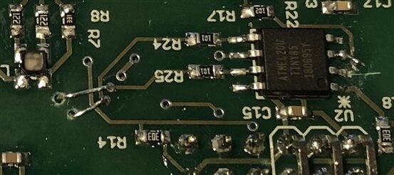

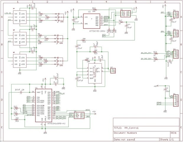

Clockwise from the upper left hand corner, are the Power Pack, Motor Driver and Controller boards.   During the finalization of the schematics and BOM, I noticed a few errors on the controller board.  First, I noticed that I had mapped one of the pins incorrectly.  The Midi player function uses an timer compare output that is available on Pin3, but I somehow connected Pin2 to the low pass filter and on to the audio amplifier.  The other error was due to a bad assumption that I made concerning the hardware support of the I2C port on the ATTINY85.  Device is basically a simple serial port and requires a fair amount of bit banging to actual function as an I2C port.  With the high rate of sampling needed for the four-voice PWM tone generation of the Midi player, it would be very difficult to get any reliable/repeatable timing on the I2C bus.  I decided to isolate the ATTINY85 part from the I2C bus (mainly used to communicate between the three boards.  Instead, I routed the two signals from the ATTINY85 to two unused pins on the ATMEGA328PB (to be used as a start/stop control and a status line.

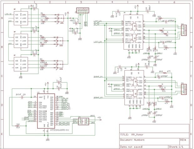

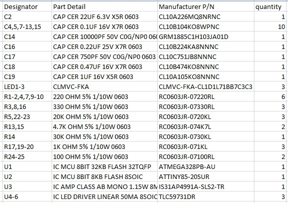

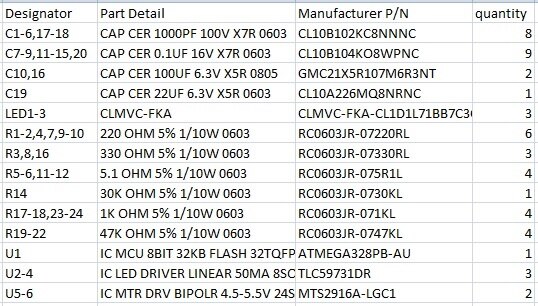

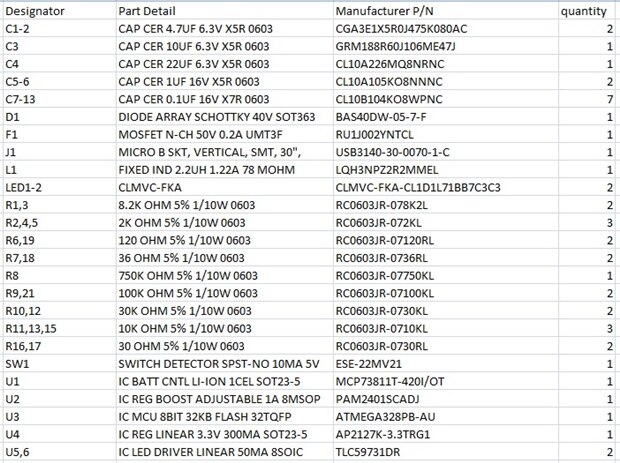

Here is the updated schematics and BOM for each of the boards:
First the Controller Board.
Motor Driver Board.
Power Pack Board.

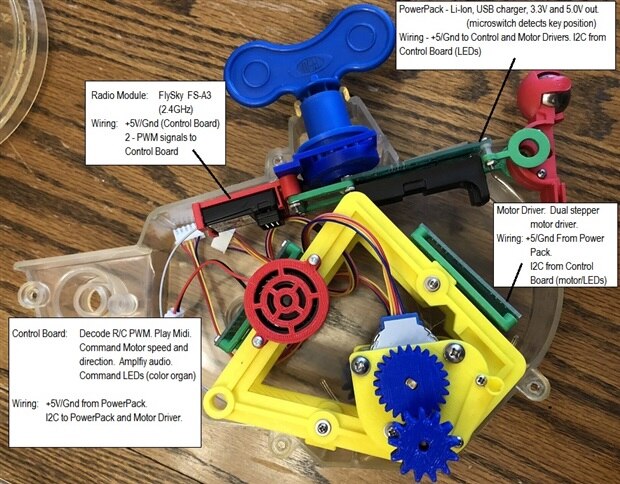

The overall connection diagram is as follows:
I have started writing/porting the firmware from the WalkyII project, but I have not gotten far enough through the process to document the firmware at this time.  I fully intend to complete this project and I will continue to blog on my progress/results.  All in all this was a fun project undertaking.  I learned a valuable lesson from my deadlines issues with the printed circuit board, which is, complete all of your long lead time orders earlier in the project time line.  I spent a huge amount of time designing and printing all of the plastic parts and I left the final electronic design details and ordering towards the end of the project.  This is a mistake I hope not to repeat in the future.
