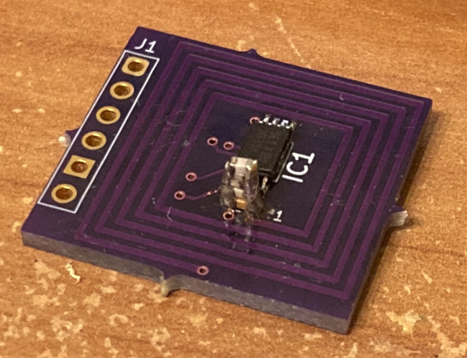

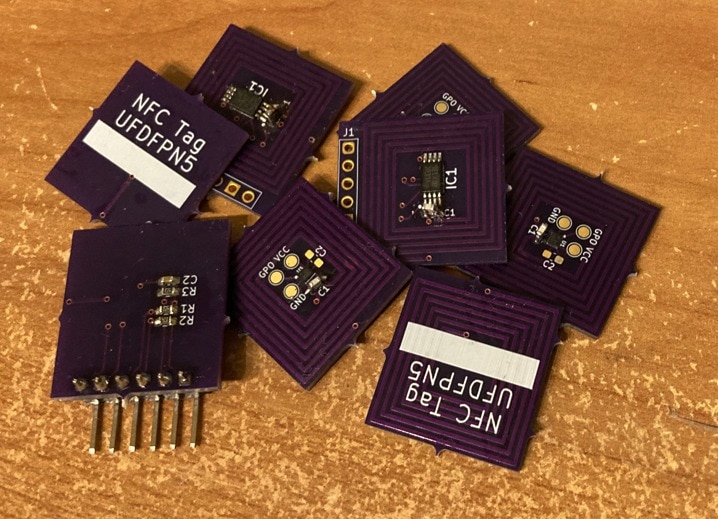

For my project I need 30 tags because storage box contains 30 cabinets. In fact, I need less because I do not need to tag cabinets used as temporary storage or cabinets containing only one easily determinable part. I decided to tag 20 of 30 cabinets. Tag bag do not contain required number of tags and some of them are too large for cabinets, or they have very specific use case (like tag that you have seen for indicating NFC field strength). For this reason, I designed my own PCBs with trace antenna and made my own NFC tags!
This was my first design with any antenna. Because I am not skilled in RF, I was not sure if my design will work. For this reason, I tried three different designs. All I ordered on OSHpark and assembled them.
Here they are:
And from back side:
As you can see two tags are designed for tags in UFDFPN5 package. The difference between tags is antenna design. The first tag has antenna on both sides (front and back) and second have antenna only on front side. The third tag is designed with different chip. It is designed for use with TSSOP8 dynamic tags and has interface to MCU when used in this way.

Soldering tag in UFDFPN5 package was not easy. In case of one tag, I shorted antenna and after several rework attempts, I always failed in states that antenna was shorted or one pin unconnected.  Other 8 tags I successfully soldered.
At the end I had bunch of my own tags:
Tuning antenna
The next step after soldering NFC chip was tunning tag antenna (and soldering it). In case of NFC tag this means selecting value of capacitor mentioned in schematics as C1.
I tried to compute value using online calculator on ST webpage, but this online calculator has no support for dual-sided antennas. I also later noted that values from this calculator was not absolutely correct. Maybe I used calculator in a wrong way and misunderstood some parameter. Instead, I find values for all three types of tag experimentally. I tried to find ideal tuning capacitor value by soldering one capacitor, manually checking range and then soldering additional capacitor in parallel. After adding second capacitor I checked difference.
The tag with single-sided antenna works best with 168 pF which I made as combination of 100 pF and 68 pF. Range is about 3 – 4 cm from iPhone SE. Tag with double-sided antenna works in range 0 – 1 cm even without any tunning capacitor. Adding 20 pF (which I made as parallel combination of two 10 pF capacitors) increase range to about 3 – 4 cm similarly to tag with single-sided antenna. The worst results I achieved with dynamic tags. Their antennal is smaller because chip is larger and there are also additional passives. Also, there are wires crossing the antenna. With 236 pF (which is equivalent of 150 pF + 56 pF + 10 pF + 10 pF + 10 pF, ufff. 5 capacitors in parallel!) I achieved about 2 – 3 cm range. Note that capacitances mentioned above are affected by tolerances. All mentioned capacitors have tolerances 5% (except 150 pF which has 10%) and because I use multiple capacitors tolerances are “summed”. Following photo shows 5 tuning capacitors in parallel. Smiley

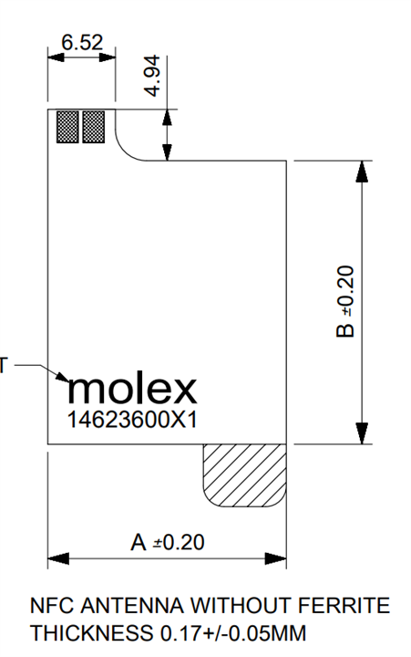

    shabaz over 3 years ago in reply to BigG
    Interesting!
    Just saw these NFC flex antennas , which might be handy for quickly trying out stuff, although I think misaz board layout is better/cheaper to just order, especially because it integrates all the other parts, and this doesn't.
    The main rectangular portion of this is 15 x 25mm, so small enough to fit into projects
    The pads are 2 x 3mm, with 0.5 mm gap. They are solderable apparently.
