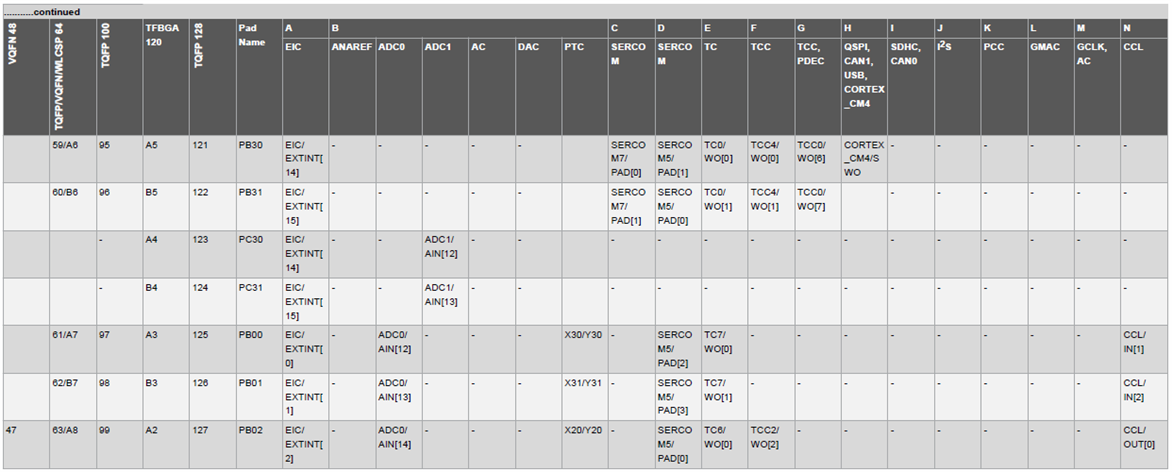

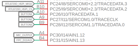

The problem with sampling analog signals with an ADC is being able capture the data at a sufficiently high rate.  The ADCs on the SAMD parts can be configured  to sample at the required rate but the issue is being able to efficiently move that data to memory where it can be used by the impulse for inferencing.  I got some feedback on the Edge Impulse forum from Jan Jongboom and Shawn Hymel that while interrupts using an ISR might work that the preferred method is to use double buffered DMA.  I had hoped I could use the Adafruit_ZeroDMA library that was designed initially for the M0 SAMD21 but the ADC section hasn't been fully ported to the M4 SAMD51 that I'm using.  Also, Adafruit uses a lower pin count SAMD51 so I may have had to modify the library anyway.  So, I needed to figure out how to configure DMA on the SAMD51.  Luckily, I came across a thread on the Arduino forum about "Setting up ISR for ADC on Zero"  https://forum.arduino.cc/index.php?topic=685347.0 that helped me get started.
Figuring out the correct ADC input to use
The SAMD51 is is a highly configurable part which makes it somewhat difficult to set up if you don't have a library hiding all the gory details from you.  The part has 2 ADCs that are shared across the analog signals and each ADC has up to 23 inputs (16 external channels) and some channels can be differential and some inputs have dedicated functions.  So, how do you figure out what ADC channel the microphone is on?  I looked in variant.h but that only gave me the equivalent pin number to use for the Arduino IDE.  Turns out it was easy to find because Seeed did a great job of labeling the part body on the schematic.
If you look at this excerpt from the schematic you can determine that the MIC_OUTPUT is on Pad PC30 which connects to ADC1 channel 12 (AIN1.12).
To verify that I checked the SAM_D5xE5x_Family_Data_Sheet and it correlates.
