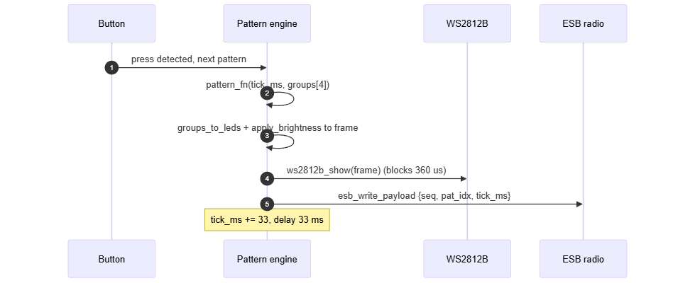

Master main loop
The master owns the time reference. Every 33 ms (30 Hz):
In code, the main loop body looks like this:
k_patterns[m_pat_idx].fn(m_tick_ms, m_groups);   // render
groups_to_leds(m_groups, m_leds);
apply_brightness();
ws2812b_show(m_frame);                            // drive local strip
m_tx_payload.data[ESB_PKT_SEQ_IDX]       = seq;
m_tx_payload.data[ESB_PKT_PAT_IDX]       = (uint8_t)m_pat_idx;
m_tx_payload.data[ESB_PKT_TICK_IDX + 0u] = (uint8_t)(m_tick_ms >>  0);
m_tx_payload.data[ESB_PKT_TICK_IDX + 1u] = (uint8_t)(m_tick_ms >>  8);
m_tx_payload.data[ESB_PKT_TICK_IDX + 2u] = (uint8_t)(m_tick_ms >> 16);
m_tx_payload.data[ESB_PKT_TICK_IDX + 3u] = (uint8_t)(m_tick_ms >> 24);
nrf_esb_write_payload(&m_tx_payload);
seq++;
m_tick_ms += FRAME_MS;
nrf_delay_ms(FRAME_MS);

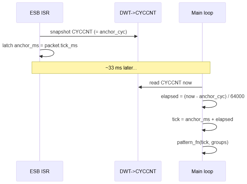

Slave tick extrapolation
The slave does not maintain its own wall clock. Instead, every time a packet arrives, the ESB ISR latches two things: the master's tick_ms from the packet and the current value of the ARM Cortex-M4 DWT cycle counter at that exact moment.
void nrf_esb_event_handler(nrf_esb_evt_t const *p_event)
    // drain the RX FIFO ...
    m_anchor_ms  = tick_ms;
    m_anchor_cyc = dwt_timer_now_cyc();   // DWT->CYCCNT snapshot
    m_pat_idx    = pat;
    m_synced     = true;
In the main render loop, when it is time to compute the current frame, it extrapolates forward from that anchor:
uint32_t tick = m_anchor_ms + dwt_timer_ms_elapsed(m_anchor_cyc);
k_patterns[m_pat_idx].fn(tick, m_groups);
dwt_timer_ms_elapsed() is: return (DWT->CYCCNT - anchor_cyc) / 64000u;
The CPU runs at 64 MHz, so dividing the cycle count by 64,000 gives you milliseconds. The math handles counter wraparound correctly, and you don't need a separate timer peripheral DWT is built into every Cortex-M4 and just needs the TRCENA bit enabled in CoreDebug.
If a packet is dropped, the anchor does not update. The DWT counter keeps advancing, so dwt_timer_ms_elapsed() keeps growing, and the slave's rendered tick continues smoothly forward. The slave never stalls or freezes on a missed packet.
