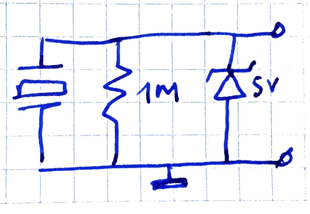

Vibrations are detected by a simple Piezo buzzer. The input circuit protects the Arduino analog input from the high voltages that a piezo circuit can generate.

Piezo Vibration Sensor and Circuit
I was going to make this circuit myself, with the buzzer of a smoke alarm. Traces of that experiment can be found here. Unfortunately, this part of the project got m.i.a. when I moved to a new apartment in July. I ordered a little kit that's virtually the same as my original design, but costs less than a new smoke alarm: JOY-IT vibrations sensor kit SEN-VIB01. It has a simple signal condition/protection circuit.
The diode is a BZT52C5V1S W8 5.1V 1/5W 0.2W SOD-323 SMD Zener Diode. The resistor loads the transducer, the diode clamps the analog signal.
This circuit tames the piezo signal somewhat, but there's a little negative component after this, and it's peaking above 5V. I'm using an Arduino MKR, and its analogue inputs don't like any of this.
image: intermediate state circuit with a normal diode and an OpAmp as buffer
I added a fast diode to deal with the negative component. In a future post I'll make an input protect PCB, based on michaelkellett's front end design. When you're using the piezo with the simple input protection, take care to only use it for vibration scenarios. I'd not use it for devices that can mechanically "shock".
