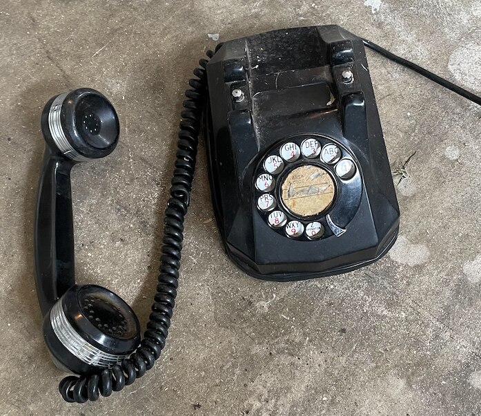

    However, as an old-timer myself, I would first like to do this with a POTS telephone like this desk phone I have (trademarked as a "Monophone" made in Brockville, Ontario by Phillips Electrical Works, a division of Automatic Electric). I would clean it up first!

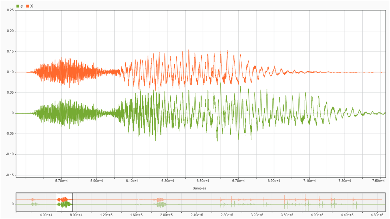

    Matlab would be quite good. If this is a college, they may already have a license, otherwise there may be a demo license (I've not checked). The "home user" license is OK-ish priced.
    With that, people could talk into the PC microphone, and then apply different amounts of echo (there are examples on the Internet), and then play the result, or see it graphically, e.g. here the orange is the original signal, and green is the signal with the echo:

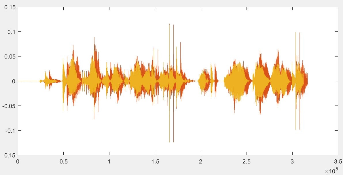

    These are the steps to do an echo with Matlab:
    1. Download the echo_gen.m file and save it to the Matlab working directory. This is not my file, I found it on the web. Can't recall where.
    2. Type the following into the Matlab command line, to record from the mic:
    sound_obj = audiorecorder(44100,16,1);
    record(sound_obj)
    stop(sound_obj)
    3. Type the following to perform the echo. You can change the delay parameter to a different amount:
    samples=getaudiodata(sound_obj);
    delay=0.1;
    gain=1.0;
    echosamples = echo_gen(samples, 44100, delay, gain);
    4. Type the following to play the result:
    sound(echosamples, 44100);
    5. If you want to stop the playback, type:
    clear sound;
    6. If you want to draw a chart, type:
    plot(echosamples);
    hold on;
    plot(samples);
