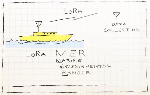

Concept
With the advances in inexpensive microcontrollers, sensors, and low powered long range radio it is now possible to gather environmental data more easily and with less cost than ever before.  Open water being less sparsely instrumented than much of the land mass provides an opportunity for new study.  The near shore and inland waters are of particular interest in that they are susceptible to human activities and important to marine life.  This project makes use of the long range, low power wireless capabilities of LoRa to study this environment.

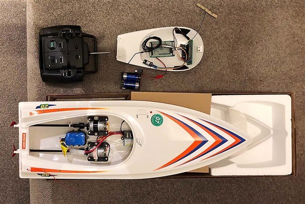

The prototype described here is housed in a radio controlled boat.  However, the platform can be modified to meet different requirements:
  • Stationary Buoy - Moored buoy to continuously monitor a location
  • Floating Buoy - Free moving platform to study currents or wind
  • Autonomous or Semi-Autonomous Boat - Boat with programmed route or even decision making capability
  • Radio Controlled Boat - Operator controlled boat as described here

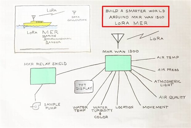

There are a number of sensors that could be deployed depending on the objectives.  The block diagram below shows the devices that were investigated in this project.

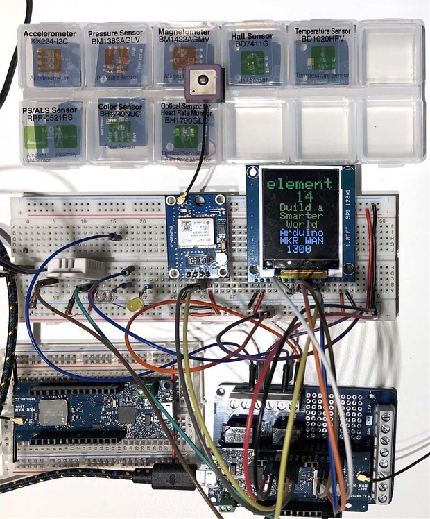

The sensors being considered were individually tested and evaluated with the MKR WAN 1300 on a breadboard first.
The sensors and electronics chosen for inclusion in the final project were:
Sensor / DeviceDescription
Arduino MKR WAN 1300Arduino MKR WAN 1300Microcontroller and LoRa Radio
Raspberry Pi 3 Model BRaspberry Pi 3 Model BInternet storage of data using adafruit.io
Invensys ICP-10100Atmospheric Pressure and boat interior Temperature
NEO-6M-0-001GPS
Thermistor (2)Water and air temperature
Rohm KX224-I2CRohm KX224-I2CAccelerometer
Rohm RPR-0521RSRohm RPR-0521RSLight Sensor
Amphenol TSW-10Turbidity Sensor
Generic ST3775LCD Display

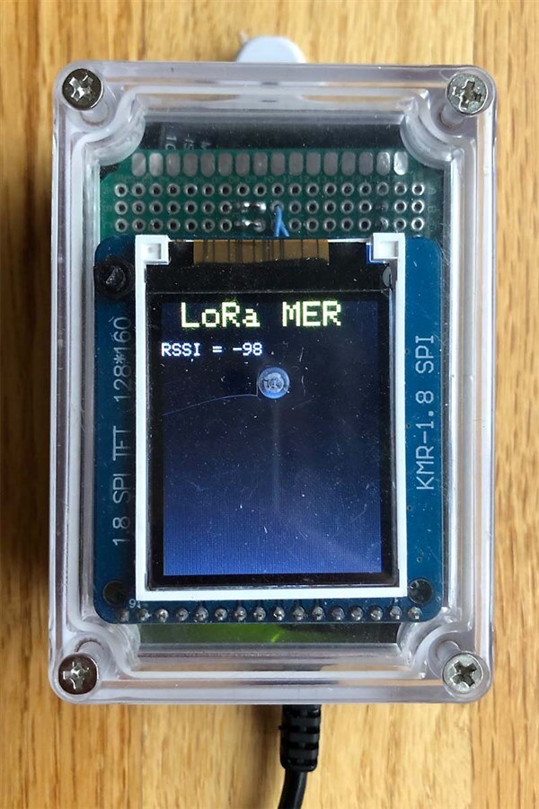

Following sensor selection, daughter boards were constructed from 5x7 cm perfboard to hold the LCD displays and attach the sensors.  One of the MKR WAN 1300 boards was made into a base station and the other placed in the boat after testing.

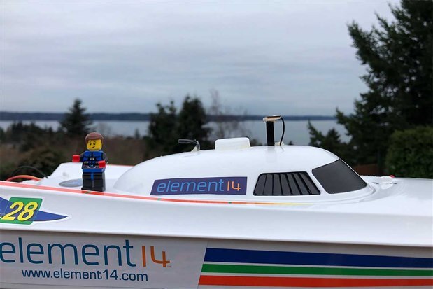

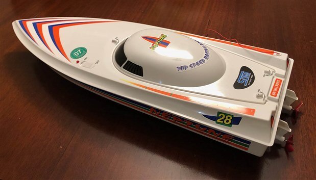

{gallery} RC Boat and Shore Station
Boat
Inside boat

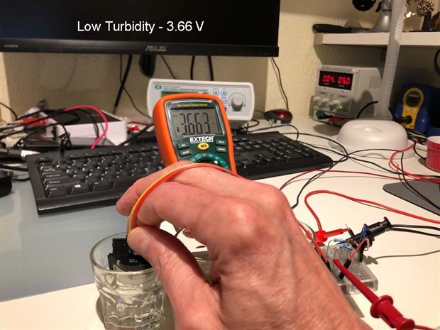

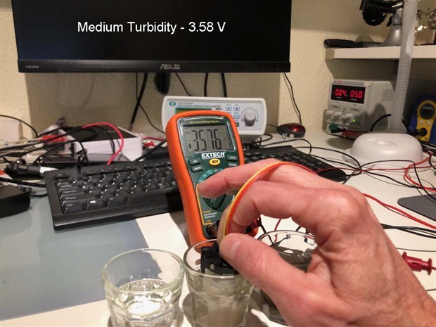

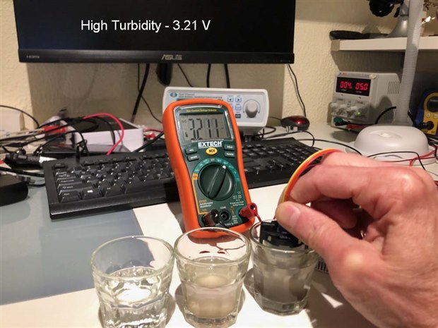

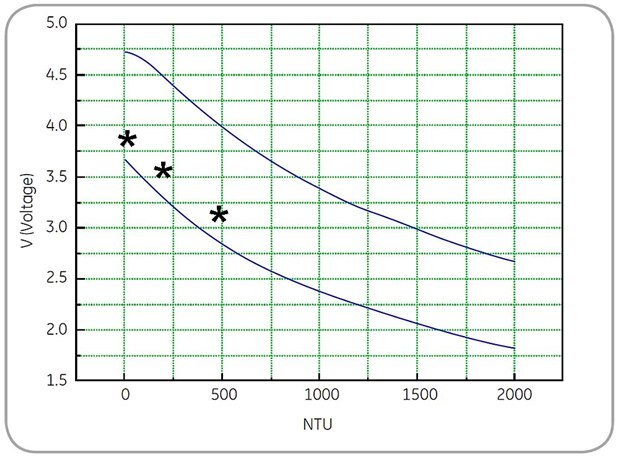

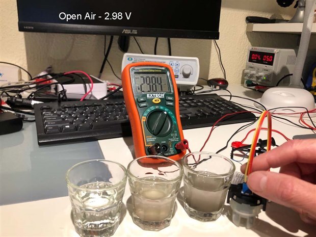

One of the more interesting sensors on the boat is the turbidity sensor which measures the cloudiness in the water caused by suspended particulate matter.  The sensor used is intended for use in clothes washing machines and such but is used here to give a rough indication of turbidity.
{gallery} Testing Turbidity
Open Air
Low Turbidity
Medium Turbidity
High Turbidity

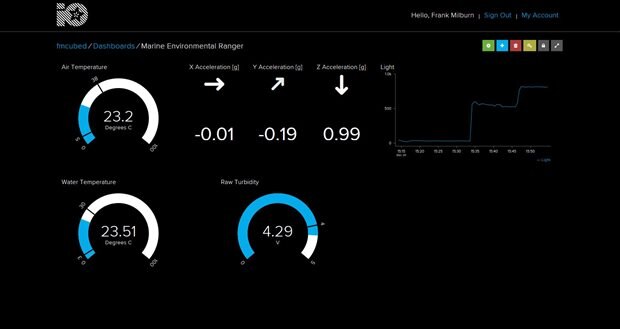

Data Acquisition and Internet Storage

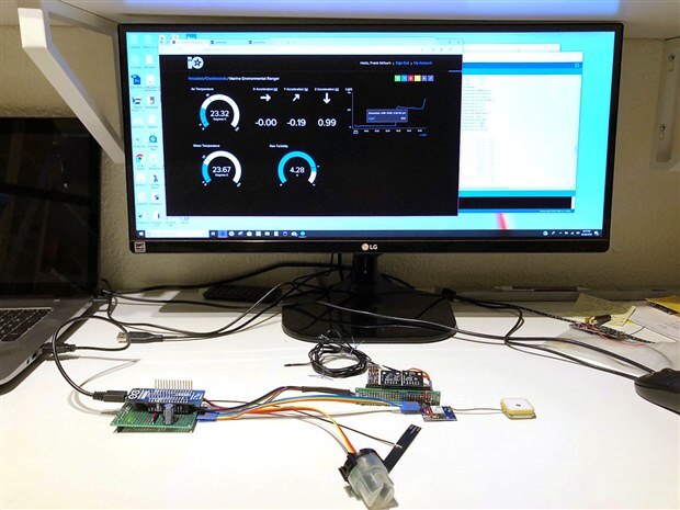

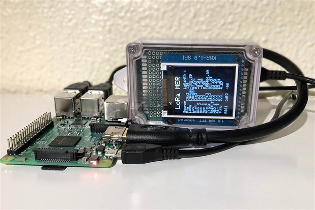

A python script was written for the Raspberry Pi so that adafruit.io can be used to permanently store and analyze results.
{gallery} Internet Display of Environmental Data
Sensors and Dashboard
REPLACE THIS TEXT WITH YOUR IMAGEimage
Dashboard
Base Station with Raspberry Pi running python script

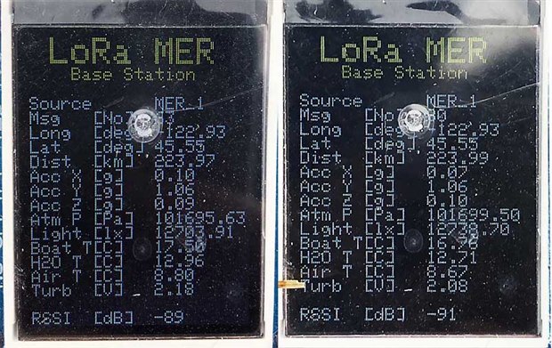

Experiment: The boat was maneuvered close to the inlet and then allowed to drift.  Data was recorded by photographing the readings on the base station.
Example data:  (close to inlet and then outlet) is shown below.
Analysis:  The limited readings taken showed minimal water temperature and turbidity differences from the inlet to the outlet of the pond.
Conclusion:  The data did not show meaningful variation in the limited data recorded.  The outcome might be different in different seasons or with higher or lower water flow rates.
