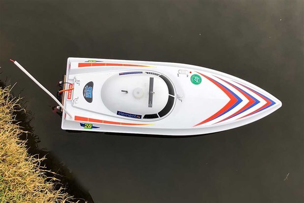

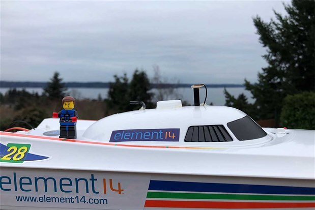

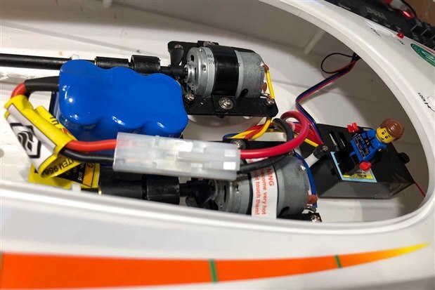

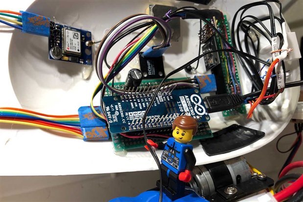

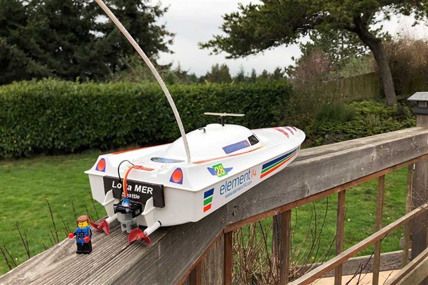

The instrument attachment in the cockpit was modified so that the LoRa antenna, air temperature probe, and light sensor could be moved to the top of the cabin.  Many of the connections are still being made with duPont connectors but in a final version everything needs to be soldered or fitted with more robust connectors.  The propulsion and radio control was checked one more time - no issues have occurred in the last couple of tests.
The LoRa antenna was placed horizontally on top of the cabin due to mechanical considerations and the length of the coax cable.  While an improvement over locating it inside the cockpit,  it would ideally be placed vertically and as high as possible.  The light sensor was covered with a plastic bottle cap for diffusion and to protect from the elements - it has not been calibrated.  All temperature sensors, GPS, and turbidity sensor appear to work fine.  Everything was tidied up and made ready to go.
Note the fancy element14 livery!  The stickers look like they were made for this project.  The boat looks fast even when it is standing still!

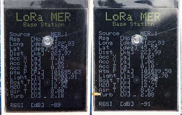

On the way to the duck pond my 7 year old grandson and I discussed the scientific method and how we might use the LoRa Mer for experimentation.  An outline of our experiment follows:
Problem / Question:  How does the water temperature and turbidity vary from the inlet of the duck pond to the outlet?
Hypothesis:  I hypothesized that cooler water coming in would be warmed up by the sun as it slowly moved through the pond.  My grandson hypothesized that it would cool down because "the water is deeper".  We both thought the turbidity would be higher at the inlet due to mixing in the fast moving creek followed by settling in the pond.
Experiment: The boat was maneuvered close to the inlet and then allowed to drift.  Data was recorded by photographing the readings on the base station.
Example data:  (close to inlet and then outlet) is shown below.
Analysis:  The limited readings taken showed minimal water temperature and turbidity differences from the inlet to the outlet of the pond.
Conclusion:  The data did not show meaningful variation in the limited data recorded.  The outcome might be different in different seasons or with higher or lower water flow rates.
Notes:  During these tests the light sensor was not working - it was subsequently discovered the duPont connection was not good.  The accelerometer was not perfectly aligned and the board was such that the Y axis  was down.
