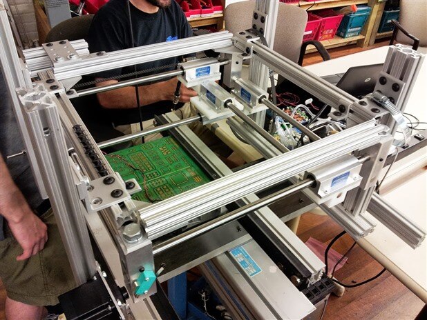

Several members have been collaborating on a project to produce a Pick and Place machine. PnP machines are robotic assembly devices that place electronic components on circuit boards as part of the soldering process.  Motion control and computer vision are key ingredients.  The goal is to eventually use computer vision software (like OpenCV) to correct misaligned parts and verify correct placement.  The current prototype relies on dead-reckoning.  Here is an early prototype that was presented at NERP back in February:
    Pick-n-Place machine gantry Ver 0.3a in development (Ed_B)
A couple members involved in the project have moved on to other endeavors, but Ed has continued to work on his gantry build.  He presented a demo at our last NERP meeting:
It is using the TinyG motor controller board, and he was sending it G-code from demo files on a Raspberry Pi over serial:

We decided that a worthy goal for the challenge would be to replace the TinyG and Pi with just the BeagleBone Black.  The PRUs should be capable of generating the step and direction signals for a stepper motor driver IC like the TI DRV8825 .  Software to generate G-code from a board layout (a centroid file) can run on the BBB.  The G-code can then be transformed into an array of movements that is passed to the PRU program.

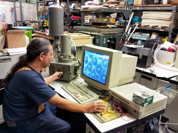

I can't conclude an introduction of our hackerspace without mentioning that we have a working Scanning Electron Microscope (SEM) takes beautiful photos.  It's also suprisingly interactive; here's Steve flying around the microscopic world:
And here's 10 micron-tall letters and numbers etched on to an Analog Devices IC die from 2007:
