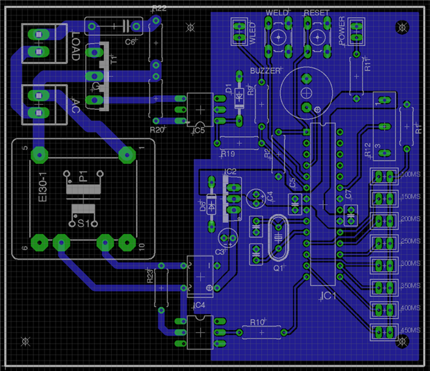

A total newbie to eagle design and PCB fab. So plase bear with on my silly questions, trying to learn.
I have pcb that is schematically completed with the layout. Before i start the fabrication process i need some expert advise if the components placed and the wires routed are ok for the ac mains and the others. The load here will be a transformer. The ac mains are 240VAC and all works well as designed in the schematic on a bread broad except for the load for which MOC3023 is yet to arrive from where i've ordered.
Thanks in advance.

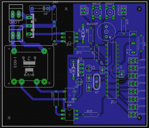

    So i've re-arranged the Transformer and brought it back to the original and a rearranged the other components as well. To add a fuse i was thinking of a fuse rated at 2A, i was thinking replacing the fuse with a Thermistor. What would be the best rate to go with ? are thermistors chosen by current and temp or voltage or all the three ?

    Your clearances are all worse again. We're going round and round here a little now. Take a step back and read through all the suggestions again. Your current locations of C6, R20 and R22 are still not how were suggested and you are having to route a very oddly angled trace underneath C6 just because you have everything all knotted up. You need to take everything on board as a whole not just select different pieces for each iteration otherwise you'll never get this finished.

    George, are you using the autorouter - if so turn it off and route the tracks sensibly by hand/brain - then when you get to something like the snail trail round D1 you'll notice that rotating D1 by 180 degrees will improve the routability  and allow you not to run a track past the inner edge of a pad on IC5.

    That said, I have looked at the files uploaded and whilst the input AC routing issue is relatively trivial to fix, the main reason the auto router is generally making such a HUGE mess is that the placement is not ready for routing yet, there is a lot of additional placement work to do before I would even consider putting any routing in. I also found some circuit peculiarities, e.g. why was the whole 5V rail supplied through a 1K resistor? I presume this was a mistake and that 1K was there for the power LED? Where are the bypass decoupling caps etc? Also, the pinout of the MEGA8 just leads to a total mess.
    I've spent a short while correcting errors and re-pinning parts of that and the autorouter will now route out all the LED's "nicely" (not really, it's still not tidy) without going round the houses. Also, looking at where all the +5V connections are.... well this is a net which we needs to get lots of places and these are scattered around the board.
    Finally, another reason for the very messy autorouter was the placements were not properly on grid which when you are using an autorouter that will lead to things being yukkier.

    See my earlier post with some initial findings. I've been playing with your layout including re-pinning your microcontroller as it looked like that should be fine and you can just change the pin setup in the software as the functionality all seems fairly simple. Here is an image of how the layout works after I have altered everything. I could just upload the design files back but then I think maybe you should be trying this some more yourself as a learning exercise so you can work out what you need to do to achieve this for yourself image
    So this isn't perfect as I was just having a quick play around with it, if I were doing this for a real project of my own then there is probably quite a lot more I would change still, but within the confines of your existing circuit with some minor tweaks this is my first stab at a layout. You can see I have got the +5V and GND connected with polygons and all the other nets are routed much more cleanly as I tidied everything up in the placement first. There is much better isolation and clearances to the mains conductors are improved. I see your connectors are a little wider pitch than I had initially thought but personally I would probably swap those out for ones with a wider pitch still and I would add surge protection and EMI filtering.
    Best Regards,
    Rachael
    UPDATE: Moved triac slightly to reduce high current trace lengths.

    So about the layout the AC and load connectors, aren't they not placed well, i mean when putting an actual connector would not fit a physical wire. The load connector would obstruct the AC connector when wiring. have you changed the pins i could read you have but did not notice in the schematic?
    I don't actually know what connectors these are specifically so haven't looked at the specs but I assumed that the mating half would fit within the bounding placement box of the connector on the board and that the wires would be coming out vertically. If this is not the case then a little more space is needed so you can get the mating connectors / wires in, but this should be achievable without too much additional change.

    I've now looked at what you have planned on using and I think you really should change these to something else. Whilst they are actually rated for up to 600V and up to 12.5A, I really don't like that they are IDC connectors and your cable will have to be quite skinny to work with these.
    I'd look at something like these on the board: http://katalog.we-online.com/en/em/TBL_5_08_311_CLOSE_VERTICAL_PCB_HEADER_6913115001XX/691311500102?sid=9d4c2f552f
    For the cables maybe these as the mating half: http://katalog.we-online.com/en/em/TBL_5_08_352_HORIZONTAL_W_HOOK_ON_WIRE_SIDE_6913525100XX

    Here is another update which addresses your concerns about the connector orientation:
