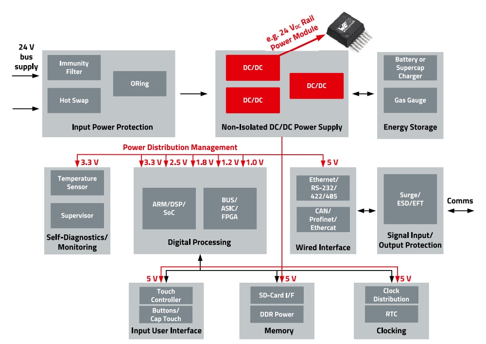

Today, many industrial applications run with input voltage levels such as 5VDC or lower, as shown in Figure 1. The power distribution system used to power such applications is often a DC bus voltage of 24VDC. DC/DC power modules are commonly chosen to handle the conversion of the higher DC bus voltage down to the lower voltage level.
A clear advantage that comes with the use of power modules is that very high efficiencies (often greater than 90%) can be realized. However, the switching behavior of these modules present additional design challenges. Constant switching during operation generates interference energy that can a negative impact on the components in the application. Therefore, developers should always check whether EMI filtering measures are required in their design when using DC/DC power modules.
Figure 1 shows the block diagram of a typical industrial environment application with a 24VDC bus. Non-isolated power modules are used to provide the operating voltage of all subsystems. This indicates the importance of DC/DC converters for industrial applications, since these existing subsystems must be supplied with different voltage levels. The converted voltages can be used to supply programmable logic controller systems or further peripheral interfaces for data acquisition, data transmission or human-machine interfaces such as industrial control panels. The DC/DC power module 171032401 is a fully integrated DC/DC converter including the switching regulator IC with integrated MOSFETs, compensation and a shielded inductor in a single housing. For physical reasons, the switching processes of the MOSFETs cause EMC interference in every DC/DC converter, whether discrete or fully integrated as in the power module. Based on the switching frequency, this interference can occur in the EMC measurement, e.g. as conducted harmonic interference amplitudes. Therefore, a fundamental understanding of the EMI basics is essential for the topic of EMI filter for Non-Isolated DC/DC Converters. Chapter 2 and 3 will provide the basics about the types of emissions and the noise modes here.
Figure 1: Typical industrial application environment.

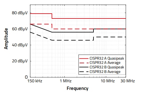

The noise levels are divided into Max Peak, Quasi-peak and Average. The Max Peak only indicates the peak value of the interference level. The quasi-peak value evaluates the “modulation frequency” and intensity, i.e. amplitude of a signal. The more frequent the signal appears in its periodicity and the "louder" it is, the higher the quasi-peak value. This is used to evaluate pulsed signals with a low repetition rate. Figure 3 shows the CISPR32 limits for the Quasi-peak and average levels.
Figure 3: Limits for conducted EMI according to IEC 55032 / CISPR32.

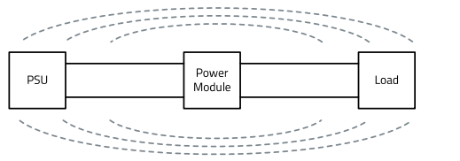

In contrast to conducted interference emissions, radiated interference emissions are the transmission of interference from the interference source to the interference sink across the space and are measured in dBµV/m. Figure 4 represents the radiation of the power module and the connected load.
Figure 4: Schematic of radiated EMI.

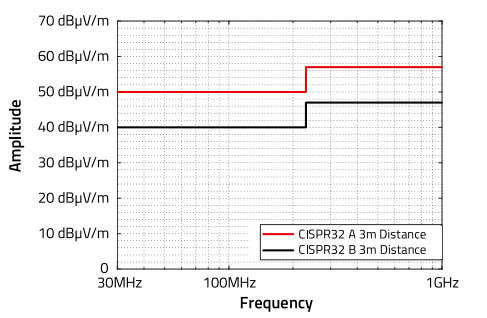

The limits for the radiated interference field strength in the frequency range from 30MHz to 1GHz can also be taken from the CISPR32 standard. These are shown in Figure 5.
Figure 5: Limits of radiated EMI according to IEC 55032 / CISPR32.

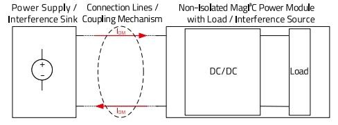

3.1 Differential Mode
In the case of differential mode (DM) interference, the interference current flows in opposite directions in the forward and return conductors. These currents cause a corresponding voltage drop at the impedance of the interference sink. Figure 6 illustrates the DM current IDM between the interference source and the interference sink using a non-isolated MagI³C Power Module with a load connected at the output as an example.
Figure 6: Differential mode interference.

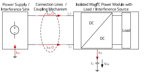

3.2 Common Mode
The interference current ICM of common mode noise (CM) flows in the same direction in the forward and return conductors. In a symmetrical circuit design, these currents do not cause a voltage drop at the interference sink between the forward and return conductors. However, the interference voltage VCM can be measured against ground. In addition to the DM input current, a common-mode current is most frequently observed with isolated power modules. The common mode circuit is closed by the coupling capacitances between primary and secondary windings. To enable current flow in the same direction on the forward and return path, the stray capacitances to ground must be taken into account. Consideration of these stray capacitances is the only way for the noise circuit to be closed. This is shown in Figure 7 using an isolated MagI³C Power Module with a connected load as an example. The stray capacitances are symbolized as CP1 with connection to ground.
Figure 7: Common mode interference.

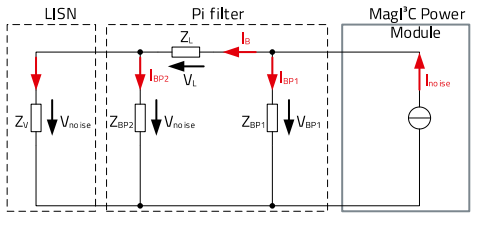

In order to effectively filter both conducted interference and radiated interference from the power module, a series impedance (choke) and a bypass impedance (capacitor) are added to the input circuit, resulting in a low-pass filter with an attenuation of 40 dB/decade.
Normally, the power module is operated with a necessary input capacitor, which must be considered in the filter configuration. The resulting filter design is generally referred to as a PI filter. Figure 8 shows the circuit diagram of the LC filter including the interference sink (LISN)2 and a non-isolated MagI³C power module shown as the interference source (constant current source). Here the complex impedance ZBP1 corresponds to the input capacitor, ZBP2 corresponds to the added bypass capacitor, ZL to the series inductance and ZV to the impedance of the interference sink.
2 Here only conducted emissions up to 30MHz are considered. Above 30 MHz the impedance concept of the LISN doesn’t  work anymore because it is supposed to replicate the typical impedance of a household mains connection.
Figure 8: EMC model with the MagI³C power module as current source.

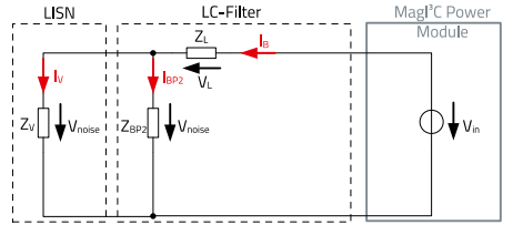

To simplify the model, the constant current source is converted into a constant voltage source, whereby the first bypass impedance ZBP1 (impedance of the input capacitor) is integrated into the voltage source. This can be done by considering the input capacitor as a very low impedance compared to the inductor impedance and the LISN impedance. This means that the input capacitor is the dominant part and defines the voltage by drawing the main current in this setup. This results in an LC filter due to the series impedance, ZL, and the second bypass impedance, ZBP2.
The resulting circuit diagram is shown in Figure 9.
Figure 9: EMC model with the MagI³C module as voltage source.

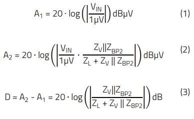

Using the assumptions just discussed, the attenuation of an LC filter can be calculated as follows. The voltage VIN is the voltage that occurs when the power module is connected only with input capacitors to the LISN. Consequently, A1 corresponds to the measured amplitude of a power module without further filtering and A2 corresponds to the measured amplitude with an additional filter.
The difference between A2 and A1 is the damping D.
This formula can be simplified if the dominant parts of the circuit are considered. It can therefore be assumed that if a capacitor is used as ZBP2, this is the dominant part and the parallel circuit can be reduced to this. This results in the following formula:
This formula can be further simplified under the condition that ZL ≫ ZBP2. This is due to the fact that ZL is the dominant part for the current in this curcuit.
To determine the component values, this formula must be converted to use C and L values, see Figure 10.

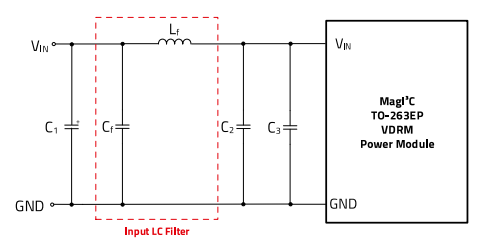

6. INPUT EMI FILTER FOR MAGI³C POWER MODULES
From the previous chapters, the filter design was explained theoretically. For the practical implementation, however, the exact components recommended will have an important role to play in creating an effective filter. The online design tool Redexpert4 from Würth Elektronik is perfectly suited for this purpose, as it maps the impedance curves of all the filter components. Additionally, use its EMI Filter Designer to recommend values and plot the resulting response. Due to the frequency behavior of MLCCs as well as polymer capacitors, these capacitor types are very well suited to be filter capacitors. The WE-PD2 series of inductors offers excellent characteristics for the role of filter inductance. To support developers in circuit design, Würth Elektronik offers application-specific filter configurations for isolated and non-isolated power modules. Figure 10 shows an example of a filter circuit of a non-isolated MagI³C power module with variable output voltage using the TO-263EP package (VDRM).
The module requires additional, external input capacitance (C2 and C3) to optimize the input current ripple. This input capacitance should be placed as close as possible to the power module.
Figure 10: Input EMI filter for non-isolated MagI³C Power Modules.

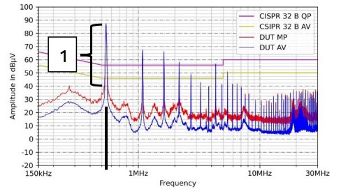

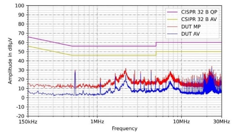

This approach to input filter design is valid for the entire non-isolated MagI³C power module portfolio. Figure 11 and Figure 12 show the measured conducted emissions according to the IEC55032 / CISPR32 test setup with the evaluation board 178032401 of the 171032401 MagI³C module to provide real validation of the filter design.
Figure 11: Measured conducted emission of MagI³C VDRM 171032401 without input filter.
Figure 12: Measured conducted emission of MagI³C VDRM 171032401 with input filter.
The diagram shows that the limit values of the IEC55032 / CISPR32 are exceeded at the switching frequency of 500 kHz as well as with some of the following harmonics. Therefore, further attenuation D of more than 40 dB is needed see Figure 11 detail 1. With the equation we have already evaluated we can now calculate the needed value for the inductance L. To calculate the inductance L, we need an initial value for the capacitance C. Experiments have shown that 2 x 4.7 µF, i.e. twice the value of the input capacitance, is a sensible output value. This procedure has been verified experimentally and provides the most sensible output values. To have a more realistic value for the capacitor for the calculation we must take the DC bias effect into account (see REDEXPERT). The capacitance therefore will be set to 70% (6.8 µF) for the two capacitors 885012209048. D will be set to 55 dB to have here a good attenuation with enough margin (15 dB margin) to the limits:
After implementing the designed input LC filter with Lf = 6.8 µH (744774068) and Cf ≈ 10 µF (2x 885012209048), nearly 60 dB of attenuation could be achieved. The selected inductor has no derating in the current range under consideration. Furthermore, no limits are exceeded at any frequency within the spectrum range of 150 kHz to 30 MHz.

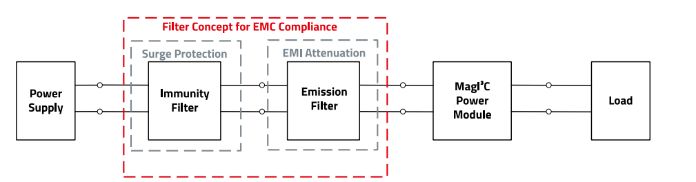

In summary, using DC/DC power modules allows developers to profit from their high efficiency but does not remove the need for EMI filter design. Figure 13 shows a block diagram of the whole system, including the MagI³C filter concept, for overall EMC (radiated and conducted) compliance with the EMI IEC 55032 / CISPR32 standards, as well as to the surge and burst immunity standards IEC 61000-4-4 and IEC 61000-4-5. The emission reduction filter does not include protection against transient overvoltages, which must be added in practice. For this purpose, voltage-limiting components are added to the filter. A separate application note covers the details (ANS023).
For any application using a non-isolated DC/DC switching regulator, power module or not, EMI filtering must be considered. An improper EMI design leads to malfunctioning due to unwanted interferences of components in the application area. Also, other nearby electrical devices can be affected. Therefore, to reach EMI compliance it is mandatory to consider EMI filtering. This application note represents the best EMI counter measures, whether the non-isolated DC/DC converter is implemented discretely or as a compact package solution of a power module. Würth Elektronik offers comprehensive, competent technical support for all EMI filter designs as well as EMS protection designs including customer design-in support and layout reviews (MagI³C Service & Support).
Figure 13: MagI³C filter concept for EMC compliance to IEC 55032 / CISPR32, IEC 61000-4-4 and IEC 61000-4-5.
